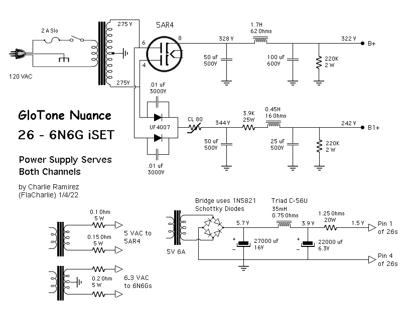

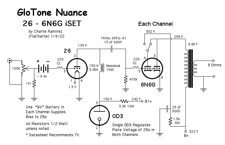

Some may recall that I followed Andy's pioneering efforts and built an inverted SET (iSET) a while back which I call the Nuance. I'm using the 26 on the input and the 6N6G for the output tube.
Here are the schematics and a link to the Nuance build thread. I'm looking forward to seeing how others implement this topology.

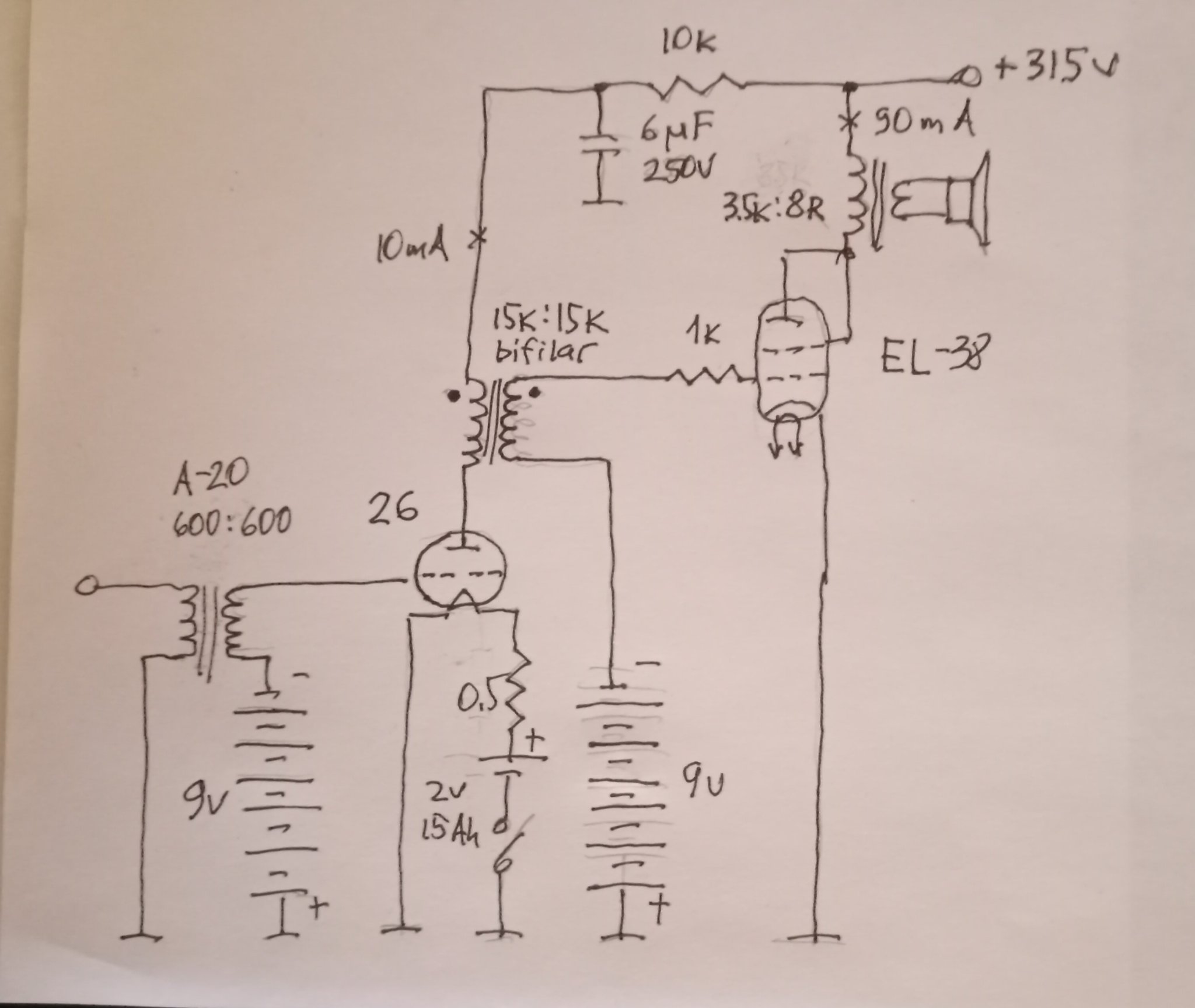

Here is my take on it. The output tube is EL-38 in triode, mu about 16, so doesn't need much driving voltage. The driver, 26, is run at its max voltage for lowest distortion. Its filament is powered by a 2 V 15 Ah lead acid battery; (3x Gates Cyclone 5 Ah). The recharging circuit is not shown. Fixed bias for both stages is from standard 9V batteries, permanently connected.. The interstage transformer is bifilar, which anyone with an electric drill can wind. Output power is about 5 W.
Edit: this circuit can be made single stage by replacing the first stage with a quality step-up input transformer.
I've used EL38 in triode and it's a very good sound and a good choice. A little under mu=18 but should still work with most systems. There are quite a few choices for the output tube and this is indeed one. Nice circuit.

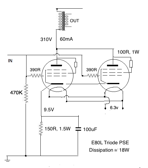

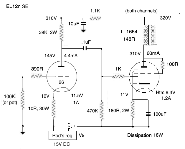

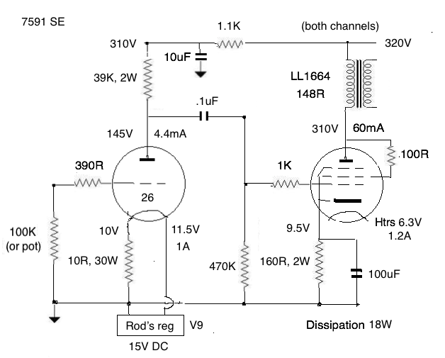

Good point about individual cathode resistors. I used a common resistor with the PSE E80L output stage I built. Worked OK but could maybe work better if tweaked. I use a common cathode bypass cap, DC Link.
PSE EL84s are a simple and widely available way to do this, though there are a few kinds of single tubes that also can be used like EL12n and 7591.
Musings and thoughts are where designs begin!
