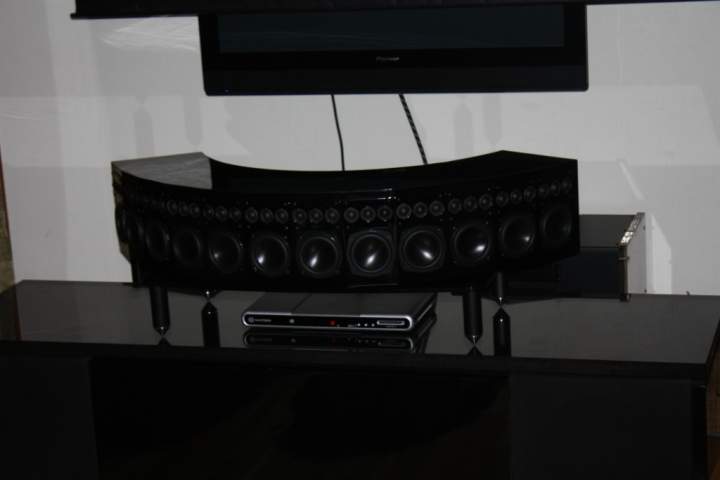

Without a doubt, the best CC speaker for home theater with multiple listeners across the horizontal plane is a curved horizontal line array. Everybody gets the the exact same FR no matter where they are sitting. Not an easy build and not inexpensive, but worth it in my mind.
I could be wrong but I think this was made by Rick Craig at Selah Audio. Currently, I don't see it on their website.

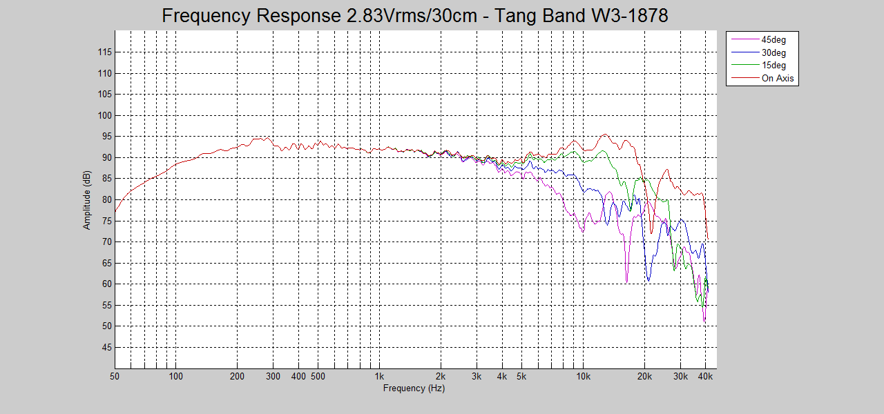

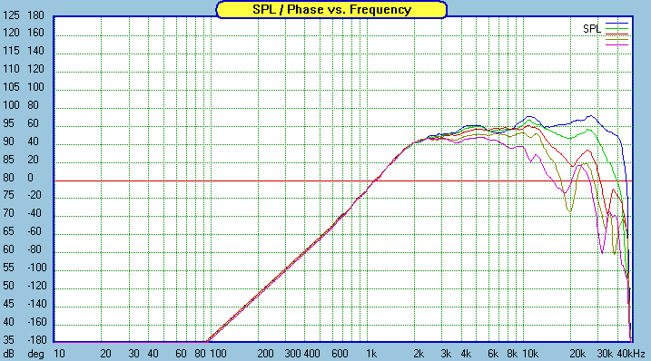

2. Pick drivers with broad stable horizontal dispersion as high as you can get for each respective driver.
3. Make sure you crossover appropriately for those drivers with respect to their dispersion patterns and non-linear distortion. This often means a steep filter, which shouldn't be a problem with a DSP active solution.
4. Generally, use a WTMW like the Revel (shown in link) does. This removes stress from the mid. driver and allows for a lot more power-handling (particularly when you consider baffle-step compensation). Remember that most of the front channel sound comes from this single speaker. Crossover should be near 350 Hz.
Shown below are the dispersion responses for the drivers I recommended (..though the tweeter is very slightly different from the one I posted):
