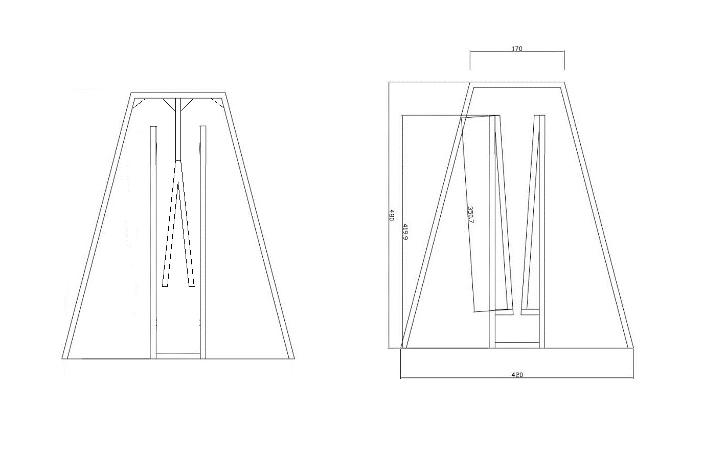

8 drivers in line, slightly longer hornpath.

Looks like an interesting project. If it works out well, why not build a version with 16 drivers? 😉
cool, and still enough 'room' to make it bigger 😀
I would be very careful(more) with the throat and smoothen it
no doubt exstremely important for the midrange quality
load chamber looks small ?
whats the calculated low end cut off ? 200hz ?

Yes, the throat will have the edges routed round, and the walls that make up
the rear wall of chamber tilted slightly backwards.
F3 should be just below 100Hz, not much reason to try to force them lower as
they will need subsuport.
Cone area is ~235cm2.
The load chamber must be a bit larger, 6,2L, but i don´t want to shorten hornpath, qw resonance now is 95Hz, (90cm path), so i´ll have to widen the entire horn slightly to make room for a wider chamber.
This was just a quick sketch to show the idea.

Redrawn a bit to accomodate for larger chamber.
Will tweak a bit more but won´t start build untill the first single driver units
are broken in and measured a bit more.
Qw resonance now ~94Hz, so loading driver below fs and chamber fb.

hey, there is very simple way to make the load chamber bigger
namely by using the space you havent used
and even more if you make the 'box' squared
would probably leave enough space to place small sub drivers on the back
or on the sides, if you prefer that
a lot of wasted space you could make use of 😀
but a lot of wood and might get a bit heavy
