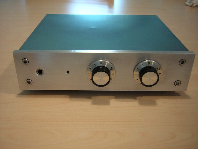

I recently build a pre amp based on the title 'High-end preamp for my GC',and thanks a lot,Carlosfm and PMA!😉
Interrupting byrepair the Tektronix 2213 oscilloscope ,I stoped all diy projects include the pre amp 2 weeks ago().But my friend AEON had finished before.

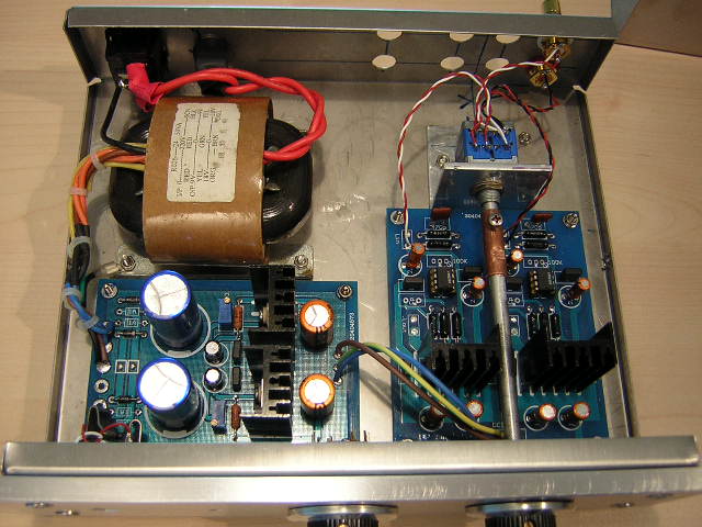

The pre/headphone amp PCB is designed by AEON initially,then modified in my advice😉.The PSU is LM317/337 standard application,the main circuit is OPA627+BUF634T.
AEON used the Holco resister and other ordinary good-quality components,and rise the amp gain to 9 in order to headphone amp.His eadphones are AKG K1000 and sennheiser HD600.Afer listening a week,he told me that the DIY headphone amp sounds very very good,is the best solid state one of the over 20 headphone amps include tube amps he made .

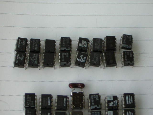

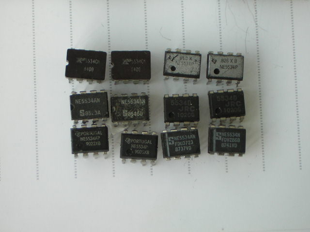

He have 6 types of sigle OPA in hands,AD797¡¢OPA627¡¢OPA637¡¢OPA604¡¢UPC741(matal package)¡¢5534(ceramic package).I have other 14 types of sigle OPAs,in my shoes-box like Elso K😀😀😀,including RC741¡¢LM301A(ceramic package)¡¢LM308AN¡¢LF351¡¢LT1028¡¢OP07¡¢OP27¡¢OP37¡¢AD711¡¢AD811¡¢four types of NE5534 made by Signetics,Texas,JRC.

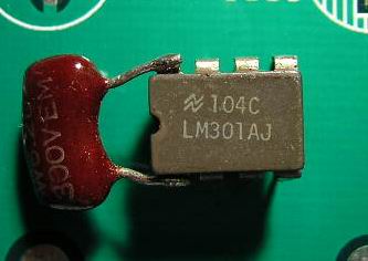

2.The queen select is LM301A(ceramic package).The sounds of it is another type,comfortable,soft,relax,natural,most warm.Its offset voltage is 10mV.

2.The 5534 of ceramic package is better than the plastic package.But all sounds of them is slow,not clear.

BTW:Cause AEON had 'robbed' my lm301A's
,I 'stolen' his pictures show here😀😀😀.

The PCB of the per/headphone amp
and the 21 types of single OPAs except 5534
