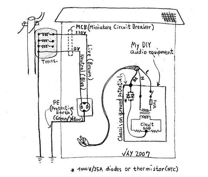

Hi Conrad and Professor,
My 2 cents, most everybody uses the term ground incorrectly, and that does cause confusion for many DIYers, I believe. To really get a firm grasp you must go back to the way the utility power grid is set up.
Entering your house are 2 hot wires, a neutral, and a ground. In your electrical panel the neutral and ground are tied together, but this still does not make the neutral a ground point. That is why you still have 3 prong outlets throughout your house. The neutral carries the return current back to your power source, just as the DC PS common, or center tap, or minus point in a single supply, carries the return current back to the power supply.
When a lot of diyers lay out their chassis wiring they confuse the roles that parts of their wiring scheme must play. For instance, in a power amp chassis you would not want the return path from the output circuitry sharing the return path from the front end circuitry unless that is inherent in the circuit design for various reasons.
When I lay out a scheme I ignore any thought of grounding anything, I work at returning the circuitry to the PS in as direct a way as possible. The barrel of an RCA connecter is not a ground unless you choose to make it so, it is a signal return path that should be run to the appropriate point in the signal circuitry, not grounded to the chassis, which plays no part in the circuit operation.
I think if we choose to continue to call these points grounds then we should separate them by calling them PS grounds, signal grounds, and chassis grounds, because they are all different.
Enough ranting from me, I know I'll get arguments from someone, but my approach has worked for me for many years.:grin:

I hope this will help . . .
But i still dont get it. I understand the picture you've drawn but if you touch either one of live or neutral you will get a big shock no?
I dont see why one would give you a shock when the other wont. In fact I did an experiment once where I touched only ONE of the points and I received avery heavy shock. My thumb turned black. However why did I get a shock by touching only 1 point?
Circuit theory tells us that current flows between TWO points. Only my thumb made contact.
