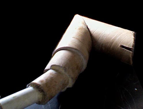

First considerations : : looking at the driver , the basket seems to be something "lossy",
that means the cavities act themselves as an enclosure ...this goes together with speaker parameters ,so it may be unsuitable for the design proposed.
I would start with a size of 6 inches to play with rear speakers' air displacement and see what happens ...I guess it is more fun !
Does this mean that even the vented is not good for this speaker?
What to you mean with 6 inches? Tube?
I'm just doing some more experiments, so I'm testing the speaker in an empty pickled jar 🙂
It is quite nice sound, no "box" sound.
Based on the incomplete specs. above, 4th order vented alignment per Keele is a whisker under 28 litres.
sorry , I was referring to speakers' diameter , which would mean also higher Vas .What to you mean with 6 inches? Tube?
Tube also is a good thing ,actually I'm playing with tapered TL with little speakers ...
