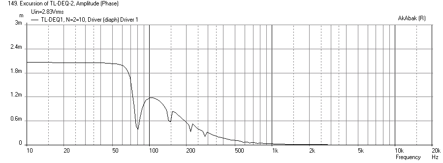

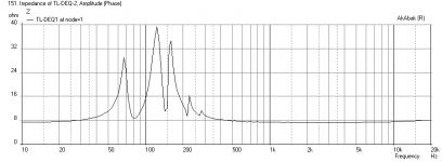

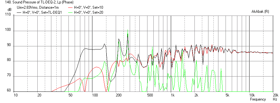

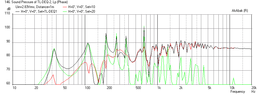

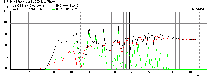

I modeled a 224 cm long TL with 3.5 in x 2.5 in CSA, driven at the end witha Fostex FF85WK. The TL starts at the top, goes down and has single fold at the halfway point so that the terminus exits straight up.
The holes were placed at the following locations:
7/4-mode: 32 cm, 96 cm, 160 cm
9/4-mode: 24.9 cm, 74.7 cm, 124.5 cm, and 174.2 cm
The hole diameters were determined by trial and error while trying to flatten the freq response (increase hole dia) while keeping bass extension low as possible (keep holes small as possible). I am sure better optimizations can be done - this was done rather quickly and manually.
The hole diameters ended up as:
7/4-mode: 0.25 in, 0.35 in, 0.60 in
9/4-mode: 0.0625 in, 0.40 in, 0.50 in, 0.50 in
The following plots show the base TL case with no holes, all 7/4-wave holes open, all 7/4-wave and 9/4-wave holes open.
As you can see, as expected, the addition of the holes drastically reduces the bass extension which was 37 Hz and ended up at about 77 Hz. However, the amplitude of the bass increased dramatically and the flatness of the bass frequency response was significantly improved. There are still some dips and peaks but I think with a little stuffing, this TL may actually work quite well. The FF85WK really is not a driver meant to operate anywhere near 37 Hz and 77 Hz is closer to its ideal limit I think and it shows.
Also included are the cone excursion and impedance for the case with all holes open.

Interesting how it smoothed out the lower bass response, this was somewhat expected though. ~70Hz is about as low as the FF85WK plays decently in the little BLH I have them in. It was similar in the 224cm foamcore pipe. Power handling is probably not too high there though.
The peaking above ~200Hz might still be prominent as it was in my physical build, but stuffing might kill it just good.
