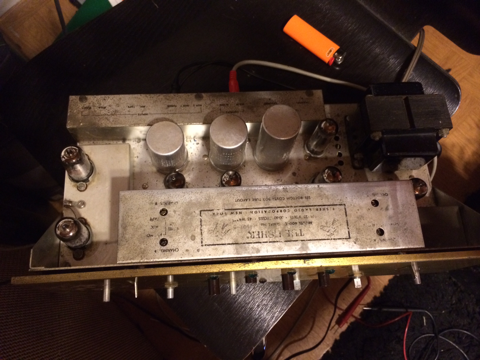

I havent checked in for over a week so I figured why not. I have been slowly receiving all the parts I need to do the work on my Citation II and Fisher 400C. Since my last thread kind of got hijacked by the Citation, I wanted to post some pics and progress on the Fisher 400C.

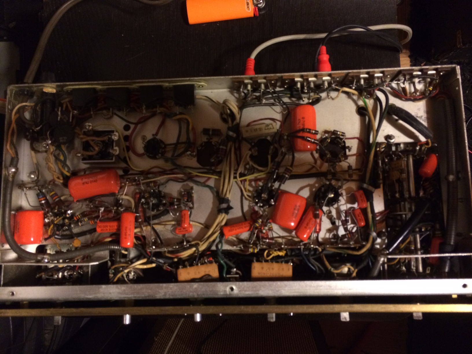

So taking hints from fellow Fisher fans from the board, I ordered Sprague Orange Drop caps to replace all the dead German Wima caps.
First off, this thing is an ABSOLUTE PITA to get to some of the locations in. I THOUGHT I wanted to find a Citation I to rebuild, but the 400-C was plenty difficult in enough areas. Below you can see my mediocre soldering job. After the results I was kind of sad because mine doesn't look quite as nice as some of the other finished ones I've seen.
When I was giving it a check-up, I found that somebody had put a 6U8 in one of the 12AT7 spots, some of the indicator bulbs were blown, and a couple resistors out of value.

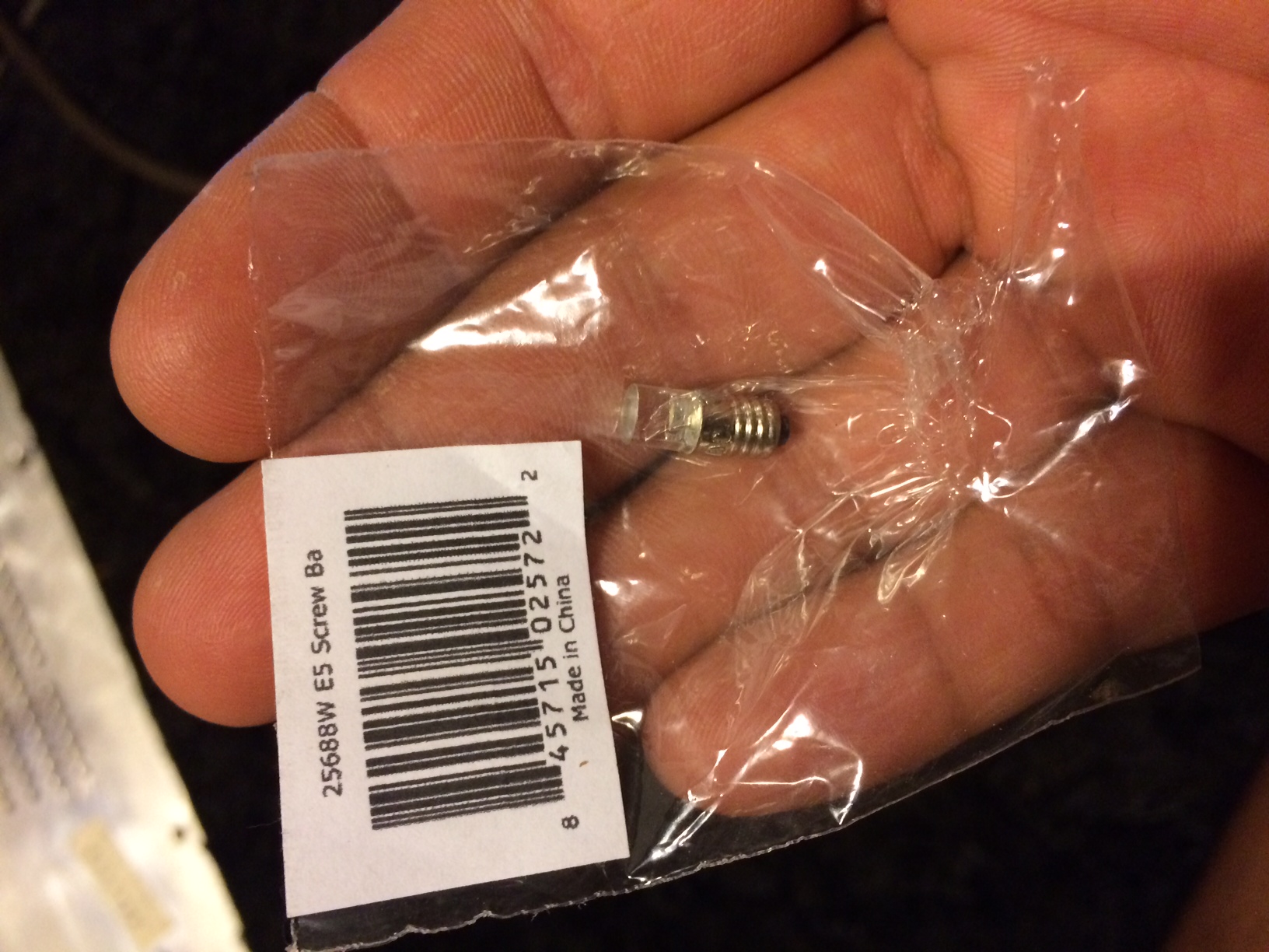

I replaced the E5 bulbs with 12v E5 socket LED's. The sockets only put out about 6.3-7v volts so they are not overpoweringly bright (only a hair brighter than the originals). Glad to know I'll never have to replace those again and the light they make is quite beautiful.

I cleaned the chassis to some degree. I can't find anything that will remove the tarnish and leave the screen printing behind. I have already accepted that I will probably be redoing it in the future with fresh screen printing, so I'm going to leave the top and front plates as they are for now.

So now I'm back at stuck. The Tri-section 30uF cap is weak, and I'm only getting about 230V on B+ (should be 320).
