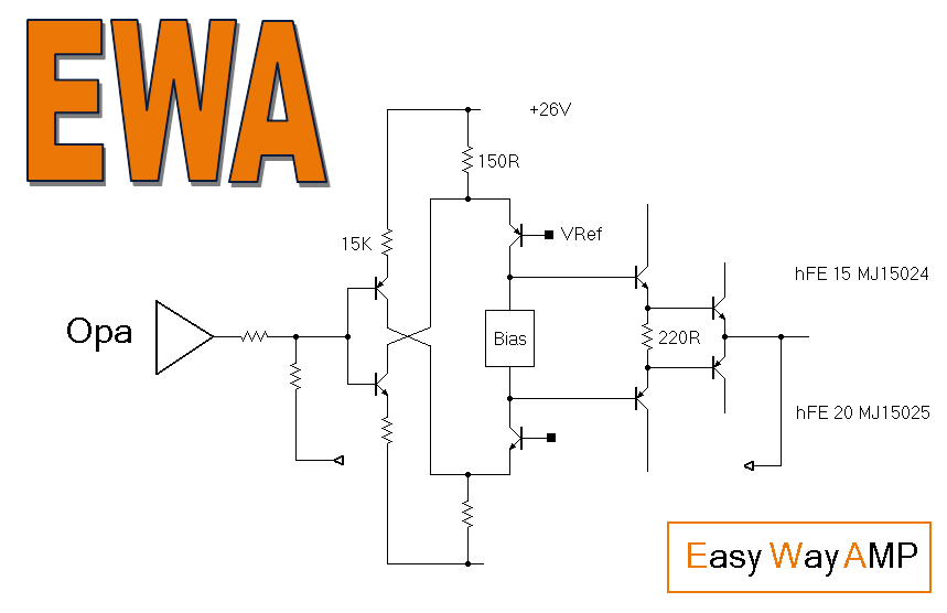

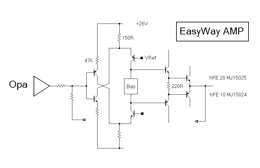

the 24s and 25s are reversed.
You're not running much current through the input transistors. How do you expect to develop any voltage across the 150Ω resistors?
