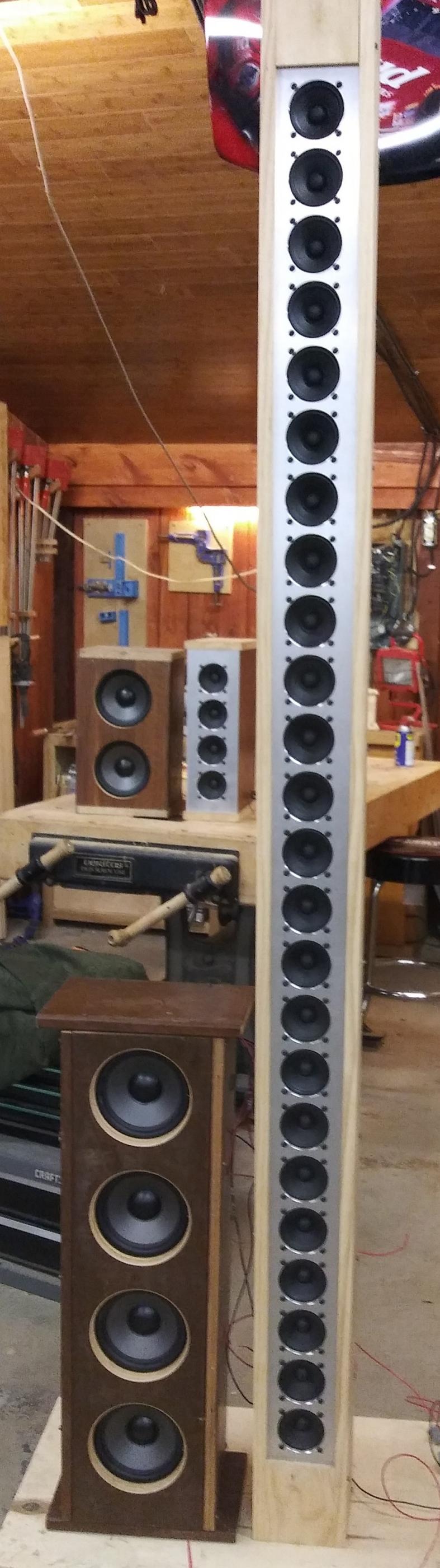

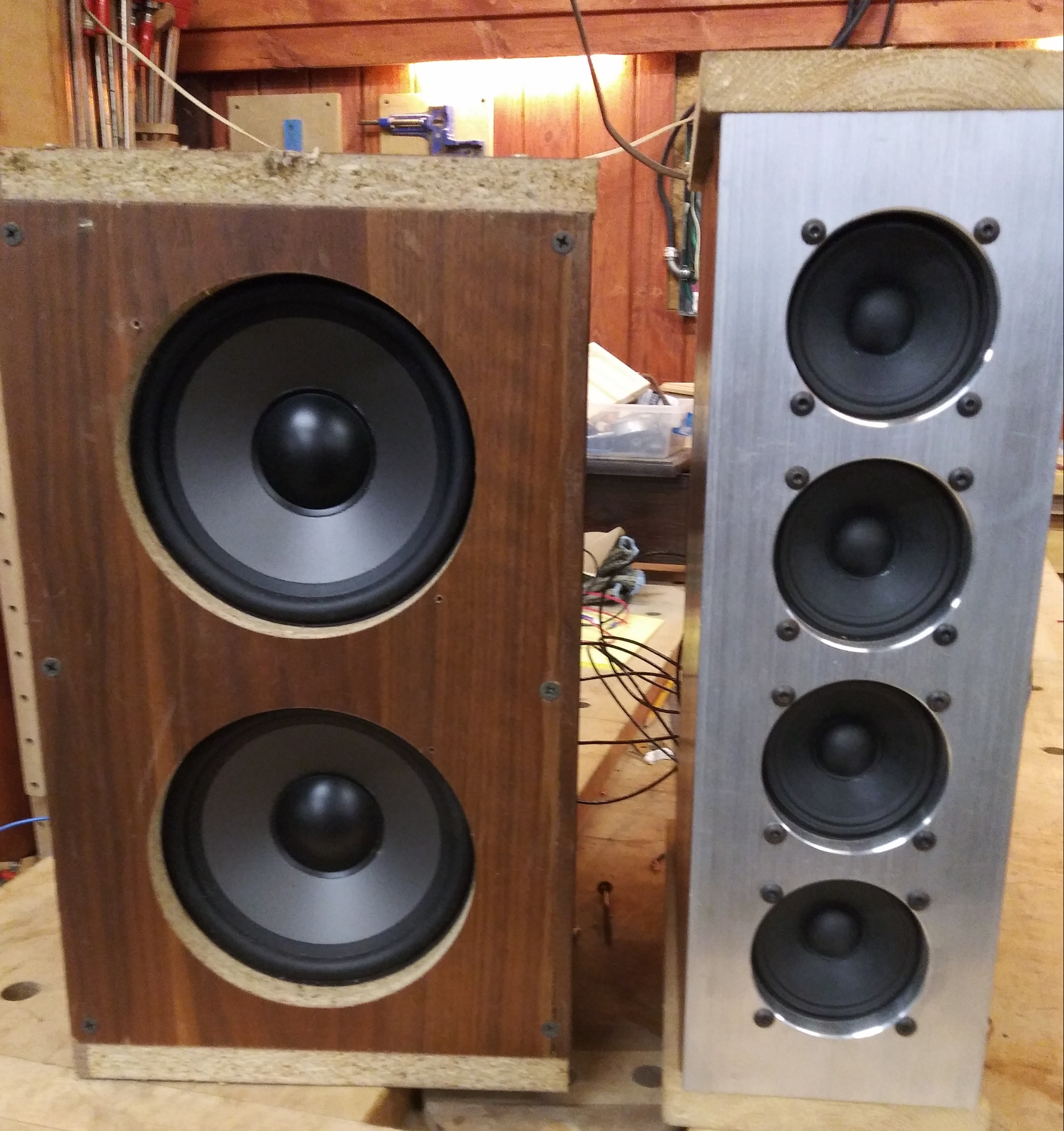

Here are a couple pics. One of the original test setup and the other is a working prototype with the full line.
Currently have 8 woofs, 4 opposing 4. Have the woofs bandpassed 60hz 48db on the low end and 150hz 12db on the upper.
It will be fun playing with this setup while I build the final cabinets.

It has been a bunch of fun playing with the PE DTA amps but I decided to try the line with a KM1700 that I ordered awhile back.
Could not get anything listenable out of the PC or phone, so I ordered a bunch of 1/4" and xlr to rca connectors and an Art DI with DAC.
Just hit my door a couple hours ago so hopefully I can play around and get some decent sound out of the KM's
Well I made some changes to the system and jad a chance to use the ART di DAC with the KM1700's
I split bass section and now have 4 of the woofers running per side. So 25 FR and 4 bass on the left and 4 FR and 4 bass on the right.
FR and bass each running an independent 2 channel amp (either 2 of the DTA 120's or 2 km1700's).
I also had a pair of older Magnepan MGSS1's that I can swap.out with the Lavoce lines as a comparison.
Running each of the maggies with 4 of the woofers and crossing at around 500hz gave (to my ears) an incredible sound. Very open and transparent. Switching from the dta's to the KM's gave what I will call a warmer and less shrill sound with more authority (headroom I think). But no more overall volume.
When switching the top end from the Maggie's to the LaVoce's, I wouldnt say it was better but very different.
I went from being in a sweet spot of incredible fidelity to being immersed by sound. The sweet spot was now a much larger area, not the same "sweet" but equally as engrossing.
The odd thing about the arrays is that I could place an unwired speaker just about anywhere between my listening position and the arrays and my mind would tell me that the sound was coming from that unwired speaker.
The soundstage is just incredible, you feel like you are at a live performance.
The difference in amps was about the same with the arrays as it was with the Maggie's.
Did forget to mention that I shifted the crossovers down to 150hz when listening to the arrays.
