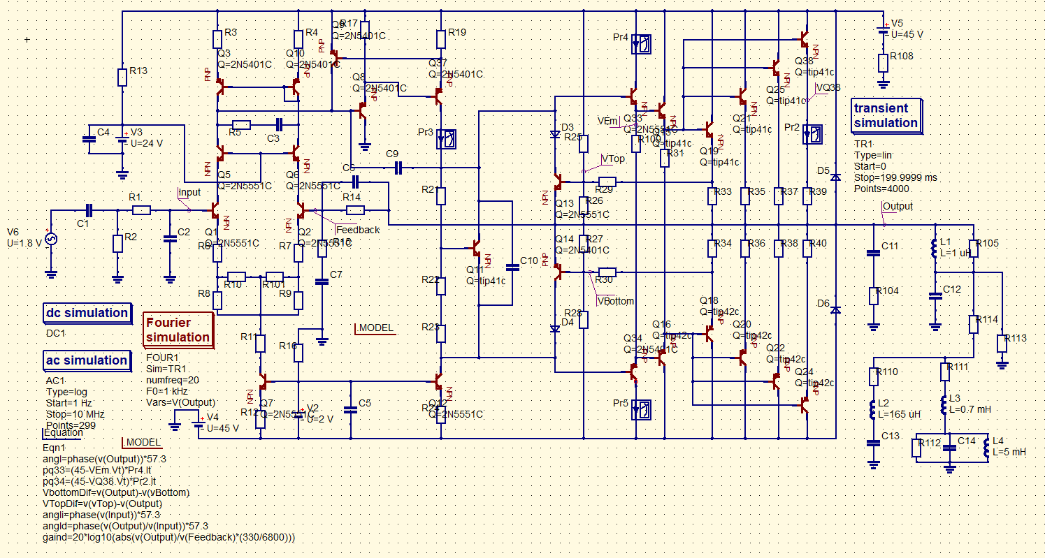

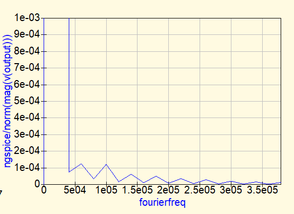

I decided to take a shot at seeing how good of a power amplifier can be made using just two sets of transistor parts: 2N5551/2N5401 and TIP41C/TIP42C. In particular, 2N5551/2N5401 and TIP41C/TIP42C both have generic versions from Chinese manufacturers that seem to work pretty well, for example:
ST(Semtech)|ST(Semtech) 2N5551|Bipolar Transistors - BJT|LCSC
ST(Semtech)|ST(Semtech) 2N5401|Bipolar Transistors - BJT|LCSC
SPTECH|SPTECH TIP41C|Bipolar Transistors - BJT|LCSC
Changjiang Electronics Tech (CJ)|Changjiang Electronics Tech (CJ) TIP42C|Bipolar Transistors - BJT|LCSC
Because of the large number of versions, it seems these parts are good candidates to not be discontinued in the near future.

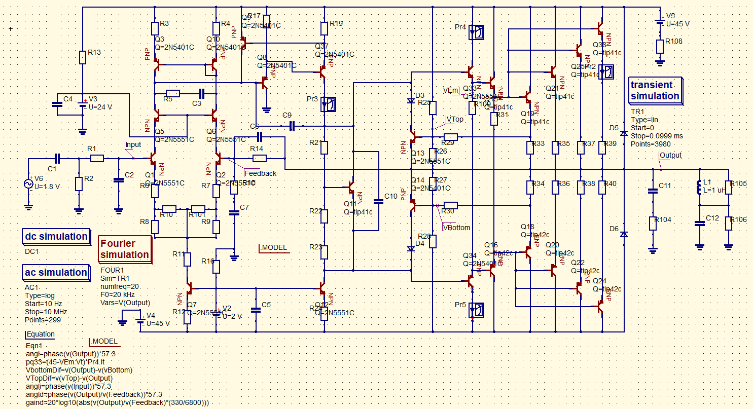

The result is: pretty good. The simulations seem to indicate that 180 W can be delivered to a 4 ohm load with THD 0.01% to 0.02% at 20 kHz. The design uses an output triple darlington, single ended VAS and cascode input, and is protected against overvoltage input and has a V-I limiter that cuts current when the load resistance is below 2 ohms. The power rails are up to 45 V. There is 108 dB of open loop gain with a gain margin of 15 dB and a phase margin of over 90 degrees.
https://github.com/profdc9/PowerAmpAudio/tree/master/PowerampSimpleParts

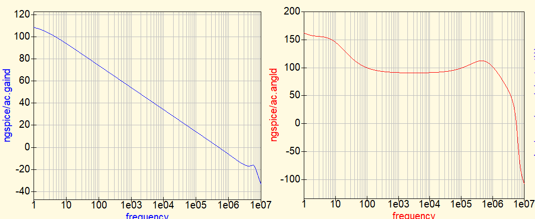

The current design uses conventional Miller compensation but there are inclusions on the board for TPC and OITPC compensation components.

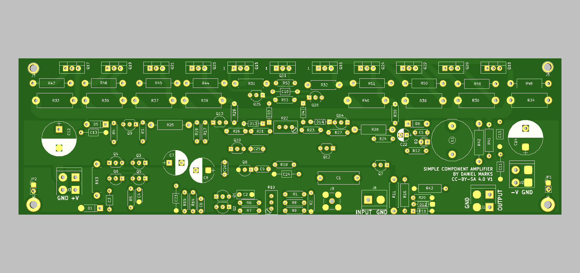

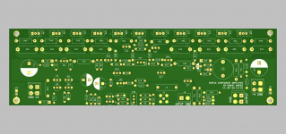

I laid out a PCB for it and it seems to be reasonably compact. There are four TIP41C/TIP42C on each rail.
This could be a pretty good budget amp I think.

In the design above, I used a 2N5551/2N5401 for the VAS. There is only 1.5 mA of current in the VAS. The output triple darlington is used so that not much current is required from the VAS. Perhaps such an approach could be used elsewhere.
Cascodes tend to work better, as the power device can then be fairly "slow". A little bit of headroom loss is the only penalty, and if you really want to get over that it's a simple matter to build a Cockroft type voltage multiplier to boost the rails for the LTP+VAS stage
However, there are devices.. for example Nexperia have BF620/BF621 which are pretty much the modern versions of BF469/470 in SOT-89 - not impossible to solder, and can be effectively heatsinked by a large copper area.
Another good candidate pair is Diodes Inc DZT5401/5551 which as the names suggest are 2N5401/2N5551 devices in a SOT-223 package, allowing for better power dissipation than TO-92 devices.

I The biggest pain with the 41C/42C is having to mount more of them to a heatsink.
That’s the ONE reason I never went through with the “all 2N3055” 200 watt per channel build I was looking at several years back. Bridged, using stacked cascodes, single supply. A lot of 3055’s. It’s a LOT of machine shop work for what you get. I still have the PCB design, and may get it fabbed one day when I have time to do all that drilling. It was intended to be. “Doomsday amp”. Maybe Doomsday will be the time to do it.
If you are going to run it off of +/- 28V supplies, you can likely get away with fewer transistors than four per rail. I think four will be needed to go to +/- 45 V, but for +/- 28 V three is certainly sufficient and probably two is OK. Four transistors are also used to reach a low level of distortion by reducing output impedance, which I felt should be comfortably below 0.1%. On a more qualitative note, I think lower output impedance results in better control of the speakers which affects the sound that way for real life loads.
Mounting eleven devices equally spaced on a heatsink is not that difficult of a machining task. For my last amp where I mounted 11 devices to a heatsink, I was able to drill and hand tap the holes in about 2 hours. It's not stacked cascodes of paralleled transistors with bridged amplifiers so you need four times the output transistors.

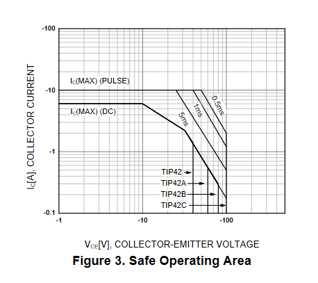

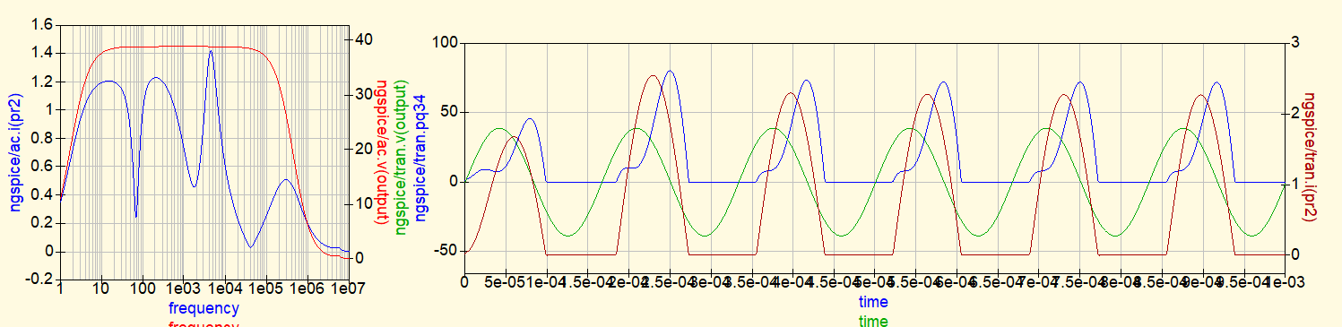

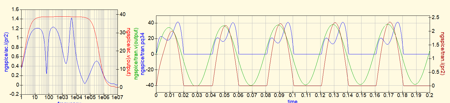

I used Doug Self's circuit model of a two-way speaker, halving all of the impedances to make it a 4 ohm speaker rather than an 8 ohm speaker (a worst case).
I then simulated 25 Hz and 6000 Hz frequencies which are the worst frequencies for peak currents to find the instantaneous current and voltage through one of the transistors to see if SOA and power limits are exceeded.
At 25 Hz, the peak SOA excursion occurs at 20 Volts output at IC=1.75 A, which corresponds to VCE=25 V, and is a point within the DC SOA of the TIP41C (which means it could be tolerated indefinitely with sufficient heatsinking). This condition occurs during the cycle at an instantaneous power dissipation of about 40 W, and with an average power dissipation of about 15 W.
At 6000 Hz, the peak SOA excursion occurs at approximately 0 Volts output with IC=1.75 A, or VCE=40 V. This is slightly outside of the DC SOA but needs to be sustained only briefly during the 166 microsecond cycle. The peak power is 70 W but is sustained over only a small portion of the cycle.
Keep in mind this is a worst case of driving a 4 ohm reactive speaker load (with Self's model) with a full amplitude continuous sine wave. It is not likely to encounter this in practice.
I think this supports that the four TIP41C/42C should be able to reasonably sustain a speaker load up to perhaps 200 W.
