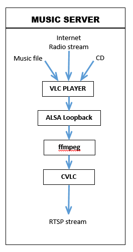

I've put together a graphical depiction of how my streaming audio system works (see attachments for reference). Here are some details...
PLAYING AUDIO AND STREAMING IT ON THE LAN
For all audio "sources" that I want to play I use an instance of VLC running on the server. This is shown as "VLC player" in the music server schematic. I use an x-windows application over WiFi to control this VLC instance from a 10" tablet, which is easy to bring to the listening location. The output of the VLC player is directed to a local ALSA loopback (the music server is running Ubuntu, any Linux distro will work in the same way). Any "music player" software can be used in place of VLC here, as long as it can output to the ALSA loopback.
FFmpeg accepts the other "end" of the loopback "pipe" as input. FFmpeg transcodes the audio stream to 320k AAC at 48kHz and sends it as an RTP stream to a local port on the computer. The local streaming is used just like the loopback and allows the RTP stream to be recovered by another local application.
A command line version of VLC, "cvlc", gets the RTP stream as input from the local port and re-streams it across my LAN in the RTSP protocol. After trying other ways, I have found that RTSP is well suited for playback by multiple clients and seems to work better than anything else in that regard. I still need to look into multicast RTP, which might be a better alternative.

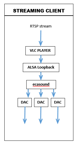

RECEIVING STREAMING AUDIO OVER THE LAN, PROCESSING USING DSP, AND MULTICHANNEL PLAYBACK
The loudspeaker system comprises multiple playback clients (each a Raspberry Pi 2). These independently receive the streaming audio from the LAN via WiFi (802.11b/g/n adapters). Onboard, VLC (actually cvlc, since the client is headless) receives the stream and passes it on to the ecasound program via an ALSA loopback. I use ecasound as a software DSP crossover using the LADSPA plugins I wrote for this purpose. N-channel audio output is produced by ecasound, one for each driver, via USB DACs. The analog audio output from the DACs is connected to amplifiers located in the loudspeaker.
The playback from all clients must be closely synchronized. This is done by a combination of VLC software parameters for buffering and tight clock synchronization on all clients using NTP, with the music server's clock acting as the reference "time server" clock. I have found that this NTP setup works best when the music server clock is left free-running (or you could set it once per day at 3am for instance using sntp). The local clients query the music server clock about one a minute and adjust their clocks accordingly. With this scheme I am able to get everything synchronized to <500 microseconds, and usually <250 microseconds). By optimizing the parameters in VLC and keeping the clocks tightly sync'd the playback is very much like a wire, except it's done using inexpensive WiFi hardware over a wide area.
This setup is flexible in many ways, and can work with any playback software that can direct its output to a specific ALSA device (e.g. the ALSA loopback). Anyone can set up this type of streaming audio system, and it uses inexpensive hardware and free software. Even if you do not need to serve multiple clients but just want to stream audio across your home, this will work. There is some latency involved due the buffering used, but this is only around 750 msec, which I find tolerable.
I wanted to give some background about why I stream audio using this combination of VLC and ffmpeg. When you look at the VLC interface, it would appear that VLC could do all the transcoding and streaming itself. So why am I using ffmpeg? Unfortunately it turns out that VLC has several bugs and flaws related to transcoding the input stream into the desired output stream. While VLC seems to include the "Secret Rabbit Code" (SRC) resampler, in practice it defaults to the "ugly_resampler". This is either a bug, or stems from a conversion to integer format (s16) before sample rate conversion, in which case it seems that the SRC converter cannot be used because it only works for float inputs. The ugly resampler results in very obvious ringing or aliasing of the audio, and should be avoided. Also, VLC only allows transcoding to 48kHz (max) rate, even with codecs like AAC and FLAC that can support higher rates.
The solution to these problems is to use ffmpeg to transcode. I have not experienced any issues with ffmpeg and the resulting audio quality is exactly what is expected from whatever codec I choose to use. On the other hand, ffmpeg cannot stream audio to my LAN - it can only output audio locally.
In order to stream the audio, I again use VLC (cvlc). This simply accepts the output from ffmpeg as input, and then restreams it to my LAN using RTP unicast, with the SDP information sent via RTSP. Streaming this way works very well and I am pretty happy with the result.
The remaining challenges have to do with how to startup ffmpeg (for transcoding) and cvlc so that they don't bonk. For example, currently I must use a certain startup order: ffmpeg MUST be launched first. This is required because (a) the cvlc experiences problems when it tries to read from the local port and ffmpeg is not streaming to it. Also, if the (VLC) music player is already playing audio before ffmpeg is started, ffmpeg sometimes complains that it needs to know the audio format and then exits. When ffmpeg is started first, everything works as advertised. I can then startup the music player and the cvlc and everything works seamlessly thereafter.
For now this setup is working for me and seems sufficiently flexible for my needs. I am interested in exploring new ways to transcode and stream audio that don't require any commercial software or hardware. I will post my thoughts and experiences with any alternative methods in this thread.
