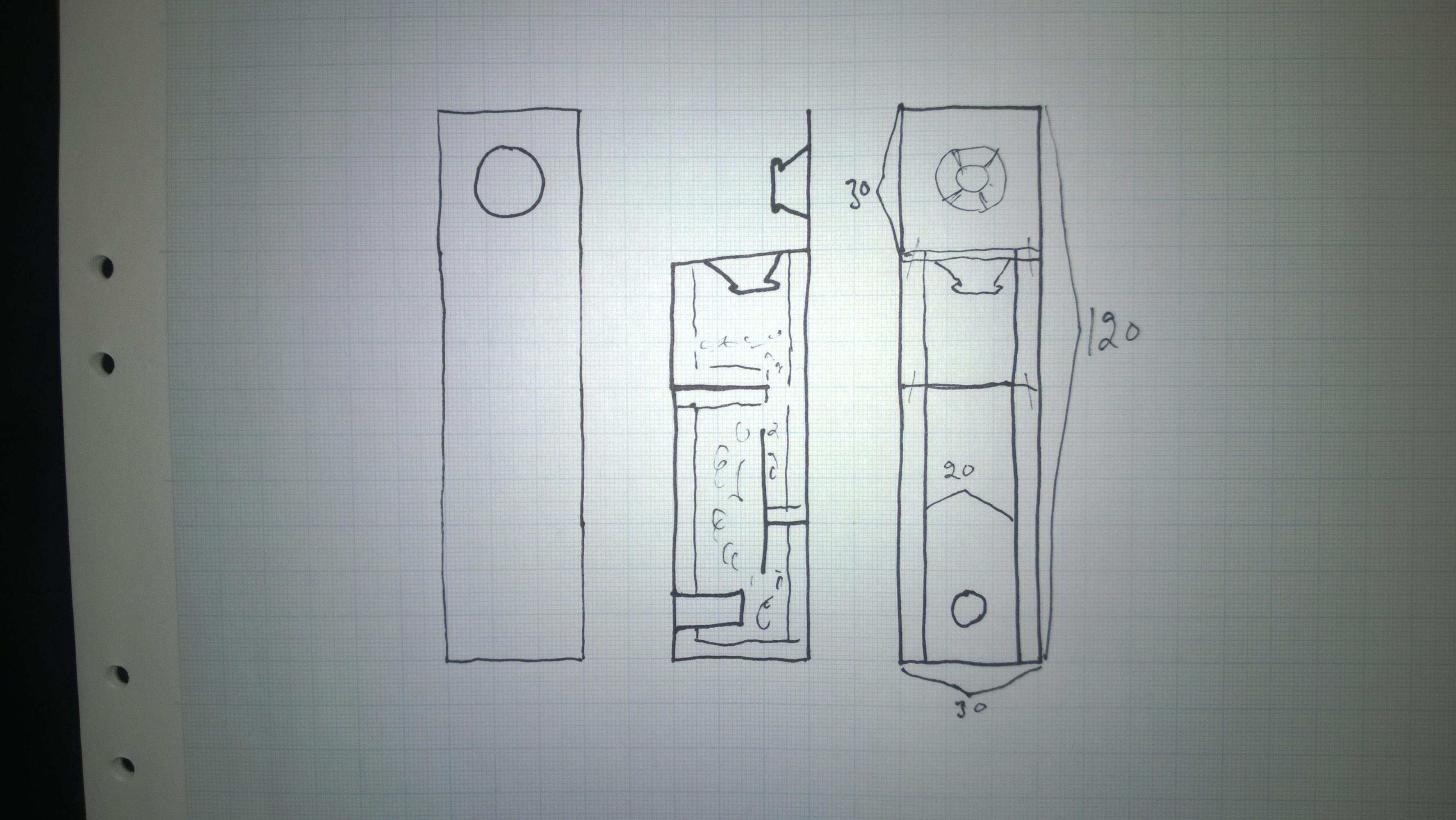

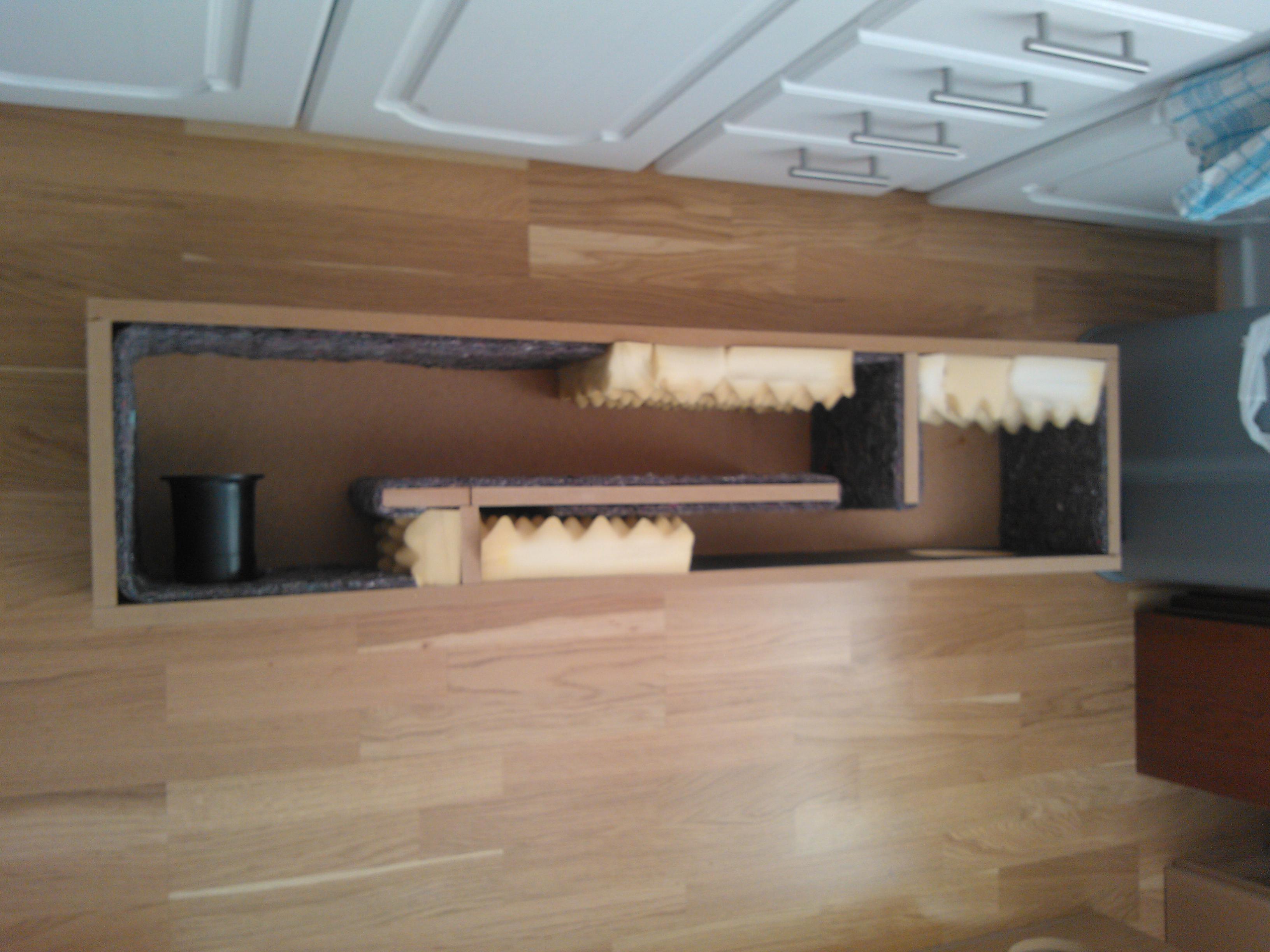

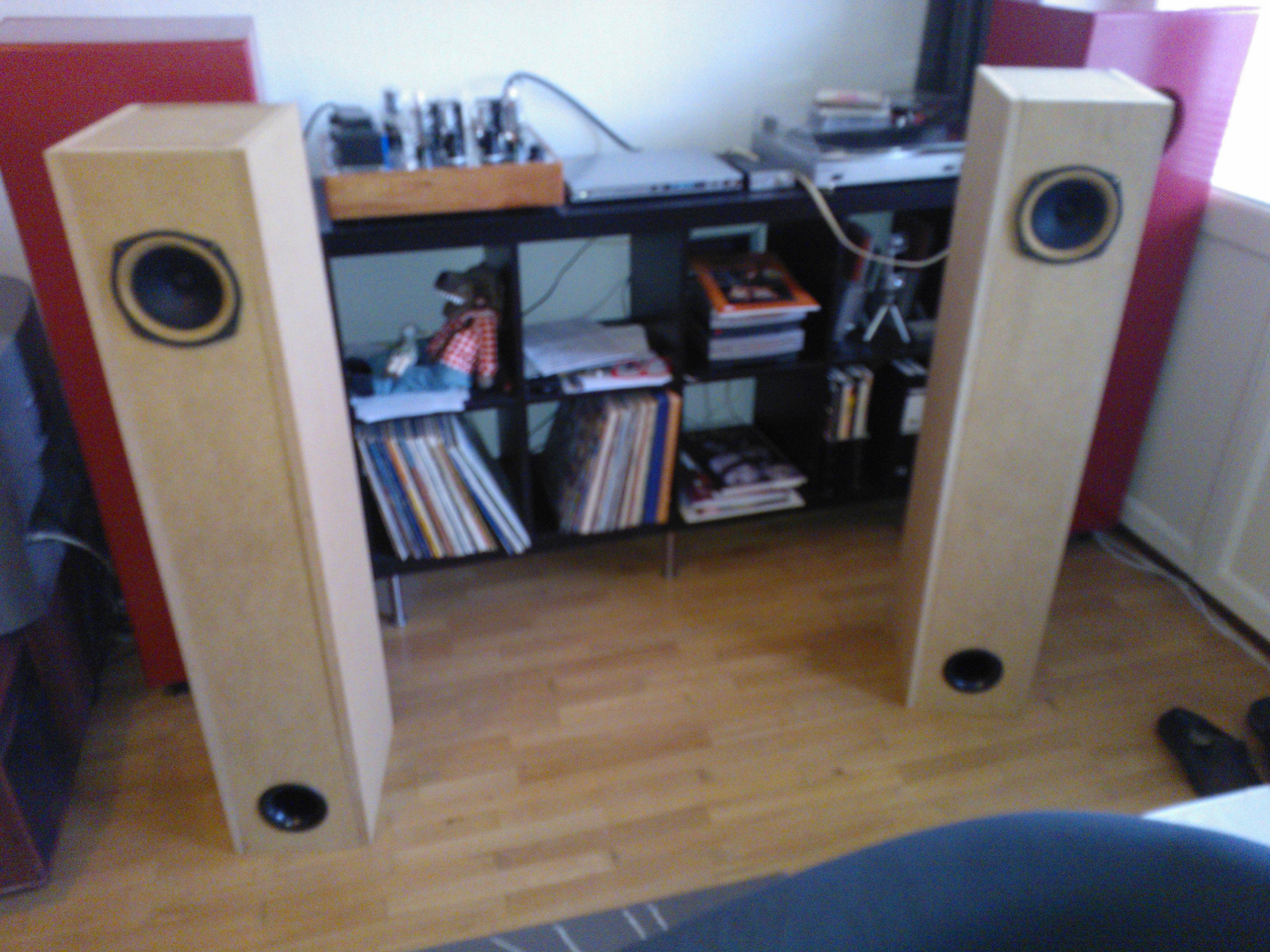

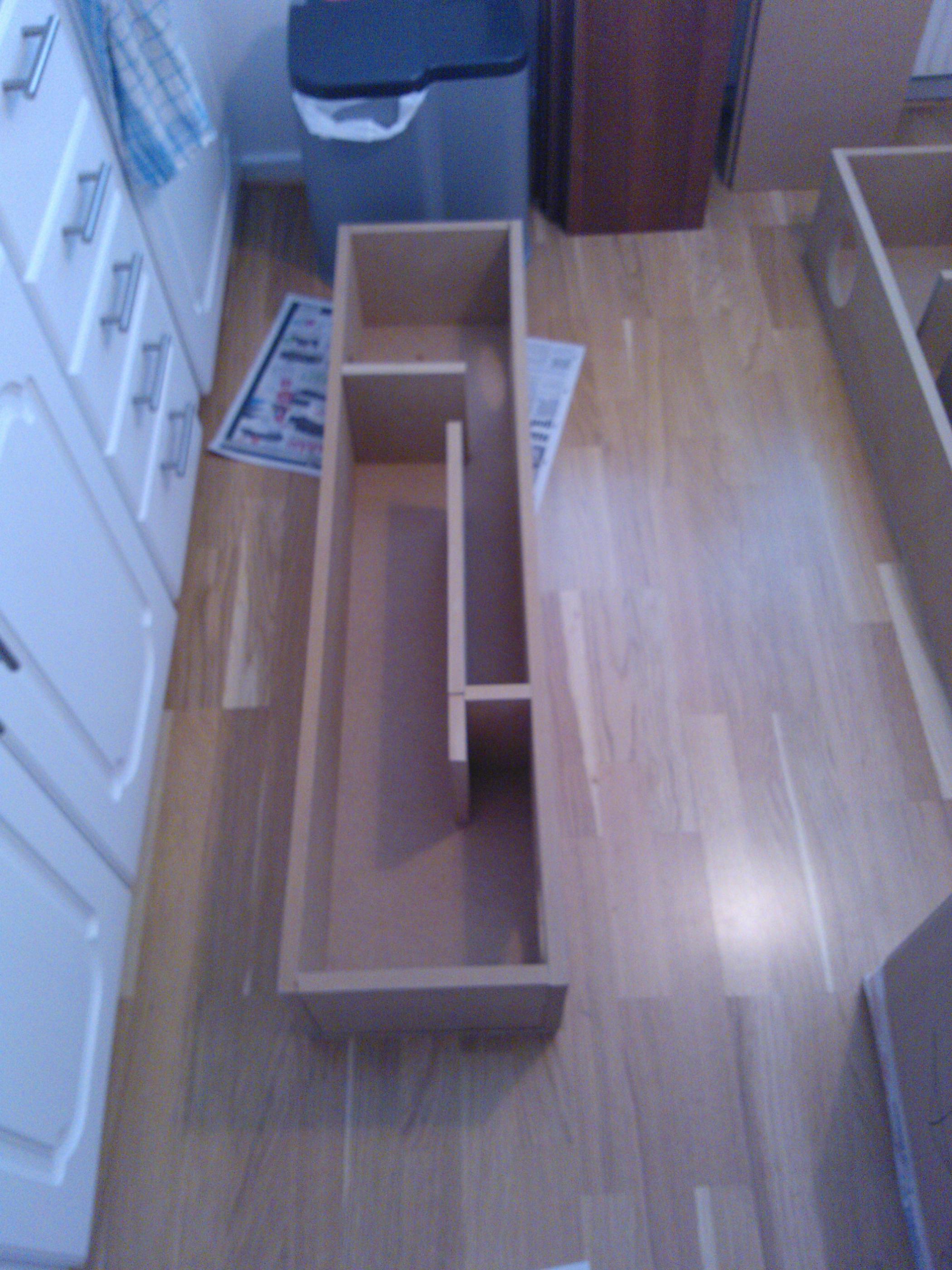

So, I had to do these;
After I put the Aucharm P610 Diatonereplica alnicos in my DBR, the "Hommage to Kondo-san", I had the ferrites laying around. An idea that lingered, as an in between project, was to try this. Something that just popped up in my head, but obviously losely inspired by, amongst others, Onur´s Singular and PMS´s ATL. And it´s obviously also a vented box (double?)of sorts. I haven´t put much ambition or prestige into them, but it was something I wanted to try. And, it worked. Of course, using the same driver it´s not like night and day, but these are more direct, more in your face. The bass is louder than in the DBR but maybe not as extended. All in all, the words that come to mind is a modern sound, somewhat conventional, like studiomonitors or multiway floorstanders. I will proberbly give them to my oldest son. I´m gonna build a DeVore Orangutan 96 lookalike for my youngest... And now on to my next dipole project....

I recognize that enclosure, one of the classic Diatone enclosures. I was (losely) inspired by Kondo-sans version ( can´t seem to find a working link) when I did these; http://www.diyaudio.com/forums/full-range/241170-diatone-dbr-hommage-kondo-san.html The aperiodic/bassreflex question can be solved with foam inserts, but I guess that is what you are doing presently. Are you using any filter for the L Cao? There not supposed to be as linear as the Diatones, but constructionwise there very alike...

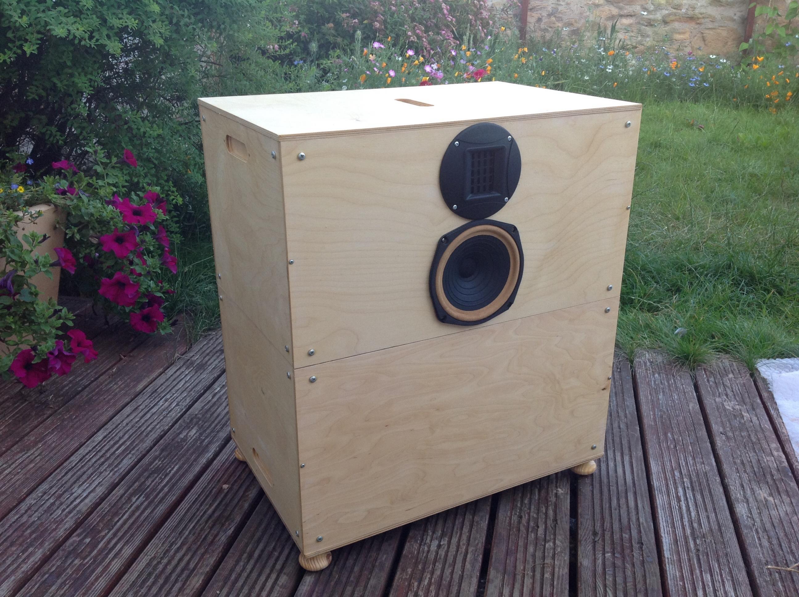

I bought a pair of Aucharm 'Diatones' with the standard (non-alnico) magnets. I built a pair of cabinets using IKEA 8mm ply storage boxes (2 per speaker). I used extensive bracing - lots of wedged and glued bamboo canes joining opposing panels, and lined the inside with acoustic foam. The cabinets are light but very dead with the knuckle test.
From memory the cabinets are around 100L with approx 40Hz downward firing port (=hole).
The speakers were nice but I felt that the top end was a bit rolled off and ragged, so I ended up adding a pair of B&G Neo3 tweeters. I built an active LR4 crossover using 3x OPA2134 per channel. I had to attenuate the tweeters by 3-4dB to get a good blend.

Excellent looking speakers bunkhokum.
