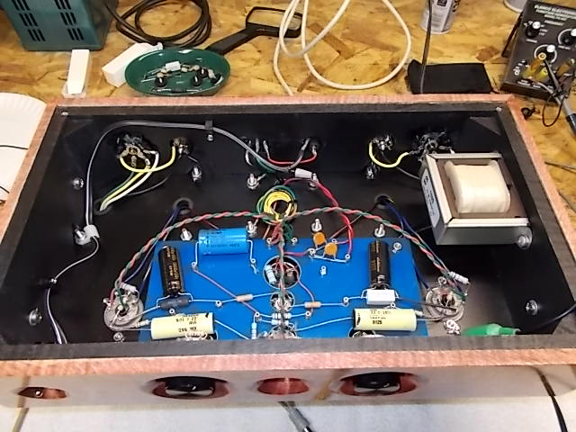

So, after throwing my two cents in all over this thread where a bunch of ideas were thrown around, I feel that I wanted to start a new thread. I'm not a huge fan of SE, but they are handy when much volume isn't a requirement. Since it's a streamlined, HiFi, chopped-up-champ, I think we can call it the Champion 😀

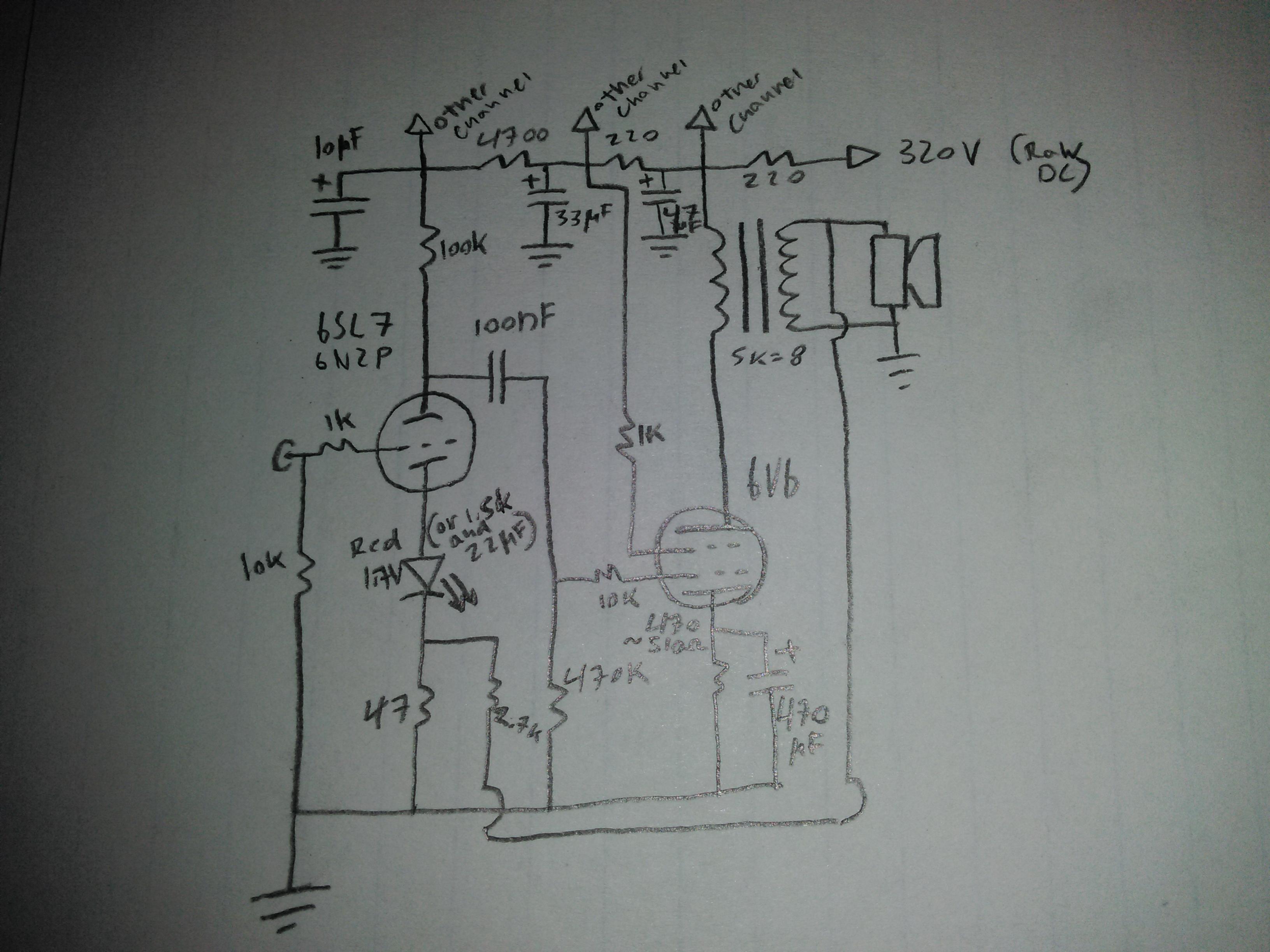

After a few comments regarding the AA764 Fender champ as a quick-n-dirty basis for a Hi-Fi SE amplifier, and similar topologies such as the RH84, I decided to simply post up a hand-drawn schematic of the basic amplifier I've described. I've built a few of these over the years, and have always been happy with them for compact enclosures and low volume requirements. By changing up a few details they will work with most popular tubes, in either position, although the 6SL7 is my favorite, the 12AT7 (with parts changes) would probably be a better choice, and the 6N2P will drop right in, as will the maligned 12AX7 if you must. Don't talk to me about the 12AU7, they suck.
A 6N2P/6P14P version sounds fun...
"there is nothing new under the sun"
attachment.php
Look familiar? It should. 90 percent of SE amps are the same basic thing.
Power supply is as simple as it gets- 240VAC secondary, silicone diodes, and a big fat electrolytic of around 220-470uF, mostly whatever is on hand. Separate filament transformer to suit, preferably center tapped secondary, AC heaters. The filtering happens locally at the circuit as shown on the schematic. Sort of a run-what-ya-got sort of amplifier, just use the basic parts you have on hand. The first couple I built used surplus Valve Junior and Champ transformers form eBay, the nice build used Edcor 10W iron, and a couple others used unidentified console pulls from a repair shop. All sounded great.
Tweaks? Don't get too crazy, remember, MINIMALIST. Less feedback, more feedback, no feedback even (on triode connection) works great. I personally liked it best with a smaller feedback resistor, down to around 680 from the 2700 listed. Definitely sounds best and most clear with feedback, as all SE amplifiers usually do. Swap the LED out for a 1500R/22uF resistor/cap if you must, but I like it with the red LED better. Maybe try different resistor values (within reason) for the 6SL7 anode/cathode to see if you like it hotter or cooler, 150k works well for the anode with a higher (1.9-2.0v) voltage LED. Swap out the output tube cathode resistors as needed, I think 510 works for most 6V6 that I used. I've got a dozen NOS russians that bias up just dandy with that value.
I've even had one apart a dozen or so times to swap out some parts to run some oddball tubes. 35L6, 50L6 and 6K6 in particular are surprisingly nice sounding tubes in a nice circuit such as this.
Switches, knobs, random gauges? NOPE, POWER IS ALL YOU NEED, your source has volume right?
CCS? NOPE
Regulator? NOPE
Stepped attenuator? GET OUTTA HERE

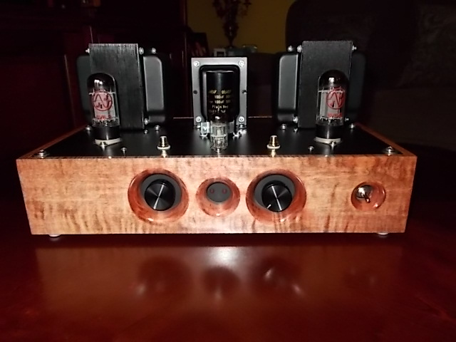

Minimalist, frugal, and boy does it sound GOOD. The Edcor one especially was great, it used a nice pair of 6V6G cokebottle tubes from a dollar bin at an antique store.
Anybody care to comment, chastise, or praise? I feel this is a great baseline to build either a sweep-the-floor type of project, or using boutique parts showpiece. very versatile. I'd love to see more of these little builds, they are nice little rigs when done right. 😉

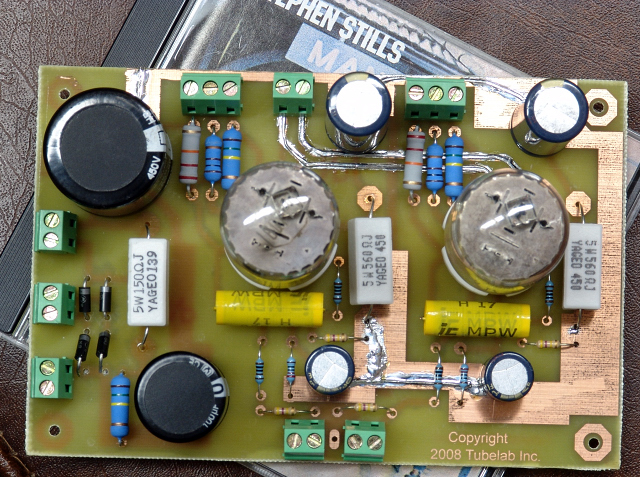

Today there are plenty of 9 pin tubes to choose from in a simple amp. Try a 5751 if you have any. I find them to be a good input tube. It is also possible to build the same amp with a single tube per channel. I have included the schematic of my latest version of the same amp. It can be wired for triode, UL or pentode operation and plate to plate feedback can be used in pentode or UL operation. Parts values depend on the tube choice.

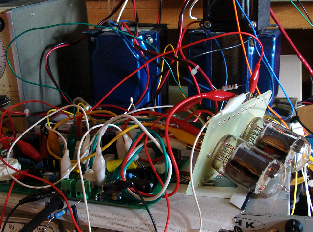

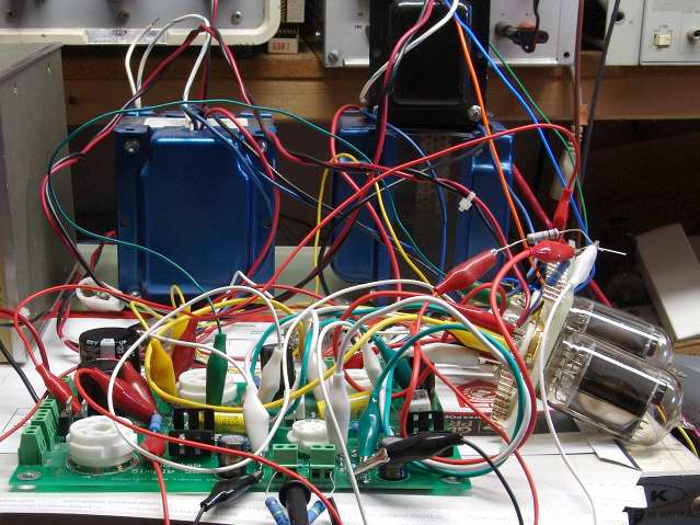

The furball version was my first "modern" version. It was built with a box full of clip leads, an SSE board, and a tube socket board. Surprisingly, it worked well without oscillation, and it was reduced to a simple PC board. I removed the power supply decoupling found in early designs. Modern electrolytics are much better and available in larger values than when the Champ was designed. The amp has only two stages which operate out of phase. Any feedback through the power supply will be negative.

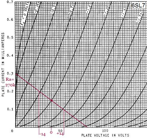

Seems that reduces headroom for the triode though, less available bias for input swing, low voltage across the tube combined with the reduced bias looks to get in the wonky parts of the curves for the 6SL7... Perhaps we have ended up robbing Peter to pay Paul? Might be a good place to try the 6DJ8 though, as these voltages are right where they like it.
If you look at the curves, it isn't so bad 🙂

I'm not so sure that I would be happy running it in this application at those operating points... We only get a volt or so of bias and can only swing 10-12 volts clean with a good bit of distortion. very wasteful way of doing things just to eliminate a coupling capacitor... I'd rather run a 6DJ8 or something similar if going that way, but we have all that B+ available, so I don't mind one more capacitor and resistor if it lets us have a nice clean playground to swing our volts in.

Hello,
Im thinking if building the amp as I already have a power supply that can provide the voltges needed. I have a few questions.
1. On the 6sl7 cathode, if i use the 1.5k and the cap instead of the red led, do i srill need to keep the 47ohm resistor to ground?
2. I will need to install a pot in front of the 6sl7, can i use 100k instead and replace the 10k resistor with 1 meg to ground. My dac has about 2k output impedance.
3. What are the expected voltages on the 6v6 plate, screen and cathode as well as the 6sl7?
Thank you... I cnt wait to get this started and thanks for sharing.
Best

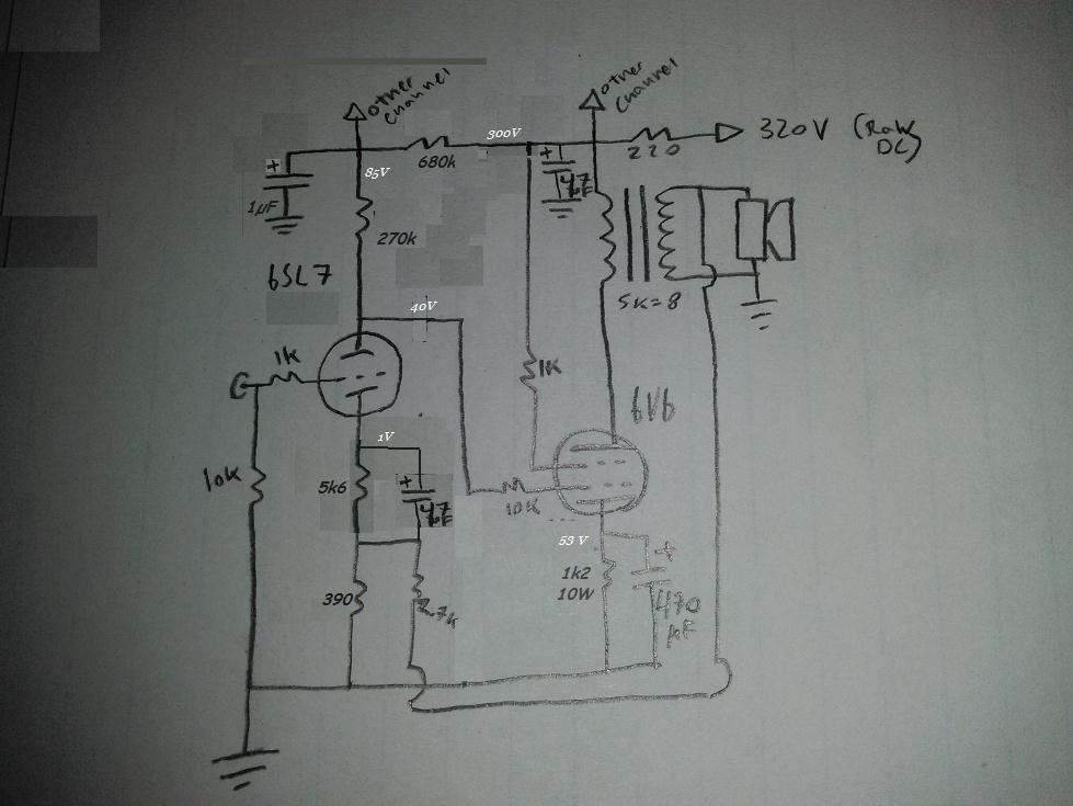

1. If you go to a resistor on the cathode, you can omit the 47R resistor, and instead attach the feedback resistor to the cathode as well. You will need to change the value from 2.7k to... something else. I would probably start with a 22k~ or so, and see if you like it.
1. That will work fine, and is actually how I do most of my amplifiers inputs usually.
3. These will depend on several factors, but generally the plate of the 6V6 should be a few to a dozen volts under the supply voltage, depending on the transformer and filtering used. The screen will be a little lower than this too. I have to check my notes, but I think the cathode will be around ~22 volts or so? You want maybe 10 watts or so dissipation on the 6V6, so adjust cathode resistor as needed to keep it happy. Maybe start with 470R?
The 6SL7 cathode will be anywhere from 1.4~1.8 volts, with a target of 1.6 or so, and the plate will be around 50~65% of the supply voltage. Adjust the cathode and anode voltage as needed by changing resistor values to suit.
Very versatile, and non-critical. If you are within 10~15% or so on values don't sweat it, as long as you are close it should work well and sound good 🙂

Yes, that is for feedback. Don't use feedback if you bypass that cathode resistance, unless you do something similar to the original with the 47R. If you have 100R it will work instead, and maybe try a 4700~5600R for feedback, it's pretty noncritical. I just recommend you run feedback if possible, otherwise output impedance suffers.
If not running feedback, try triode connected on the output. Less power, different sound, but still nice 🙂
