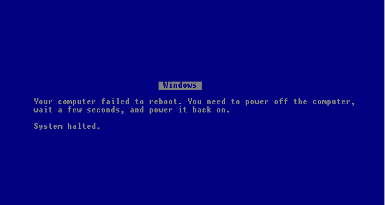

Gosh, I've never got that one....and I'm running Win98!!
Hey Choky, you remember that BSoD t-shirt picture? Still got it? 😎 😎
Tim
Tim
