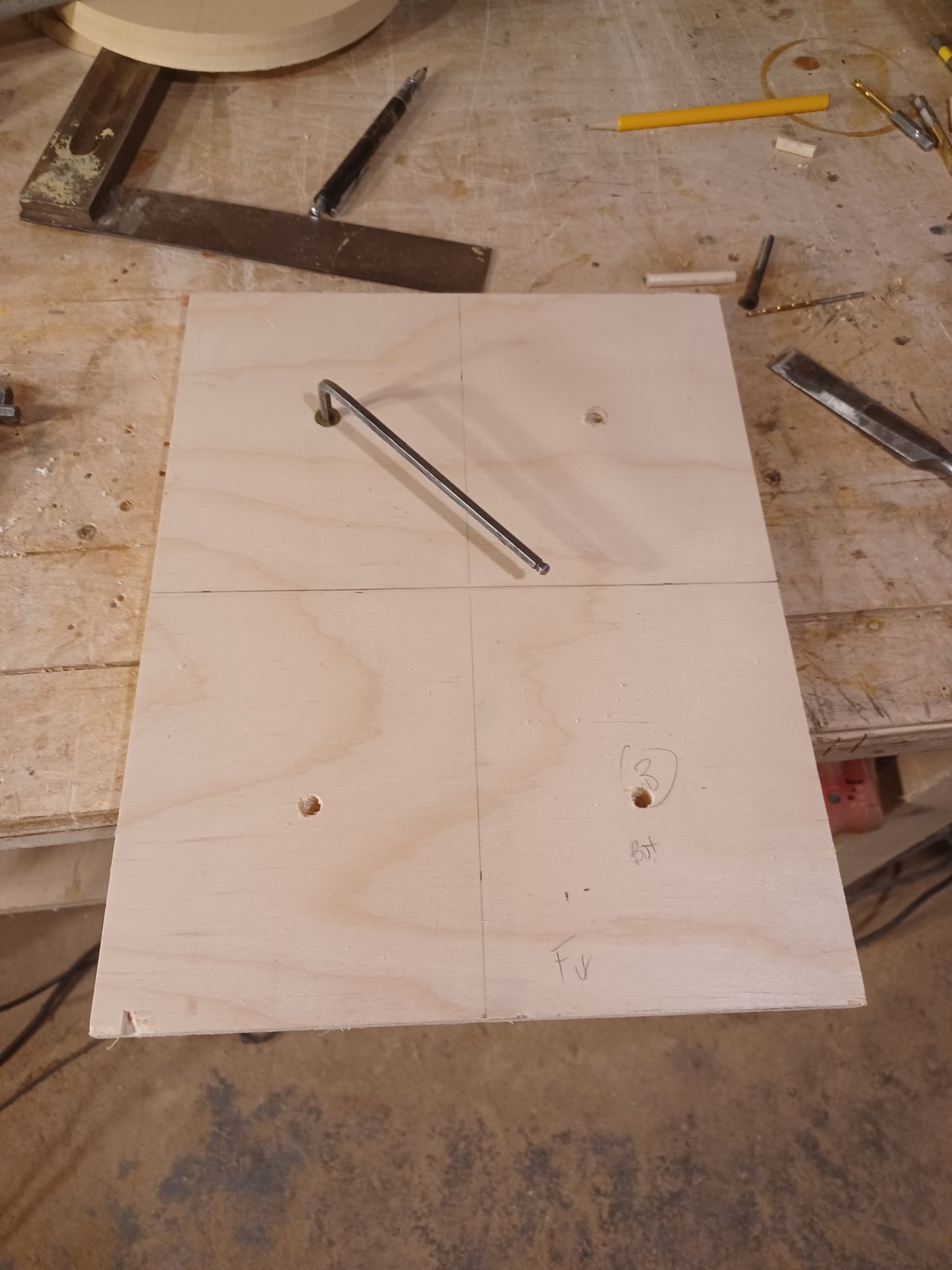

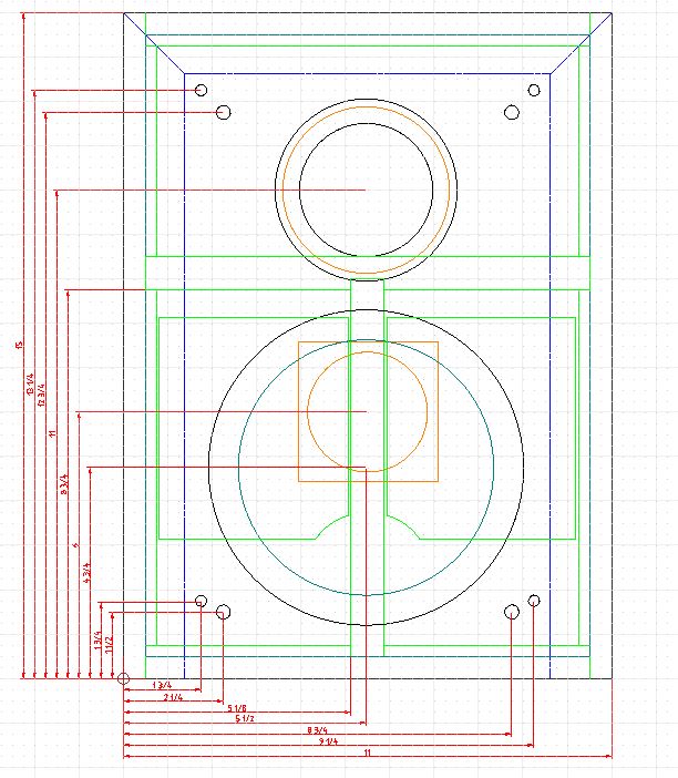

One of original goals was to use what I had on hand so I used some ¾ inch birch plywood from Home Depot, I know it is not ideal but Baltic Birch is $200.00 a sheet and would cost more than the drivers. I also had some high quality ¾ inch MDF from my last project so I made the baffles, backs and braces with it. For finishing I had enough Sapele veneer for the sides and tops and enough matte black Formica to cover the bezels, bottoms and backs.

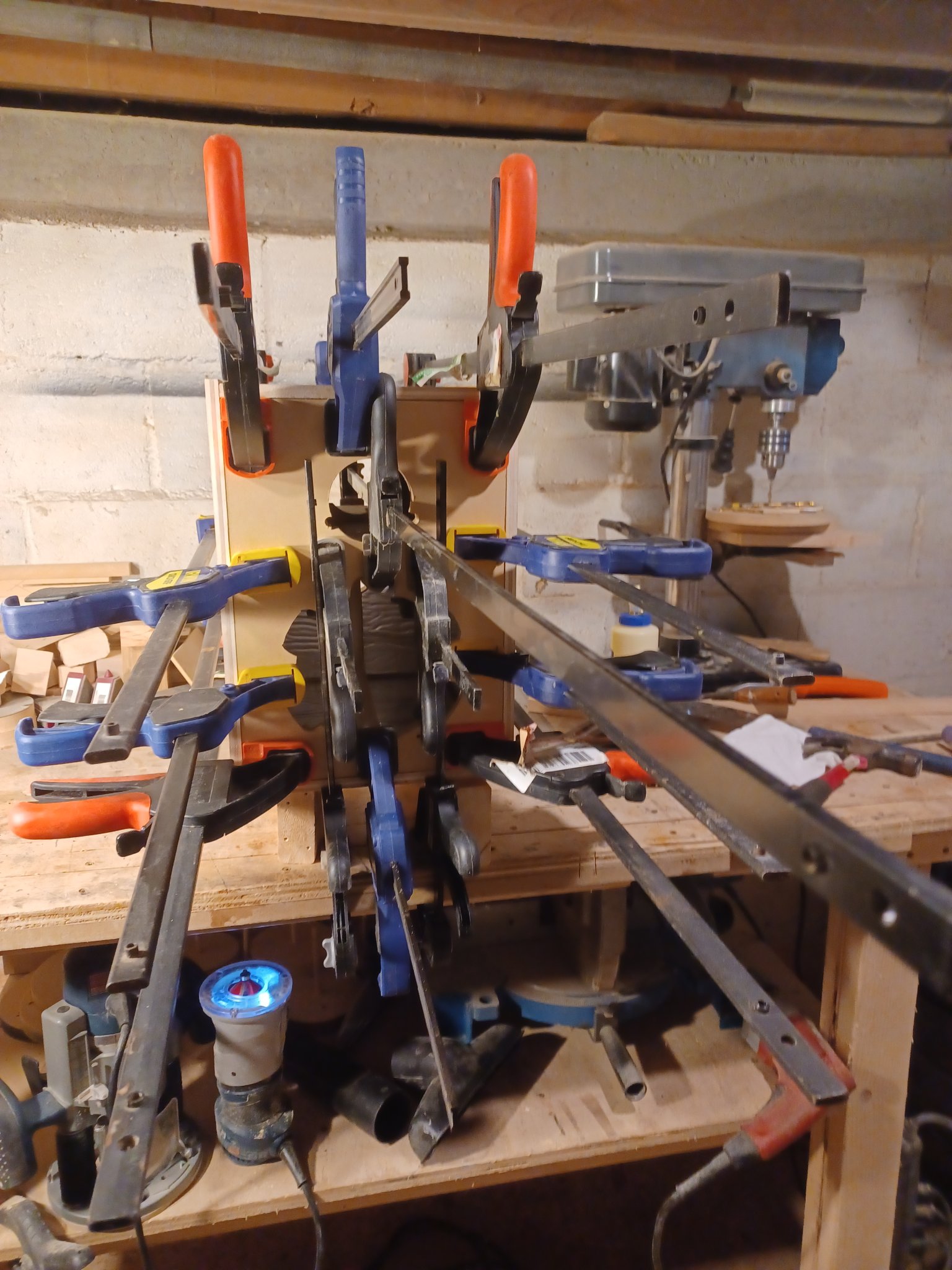

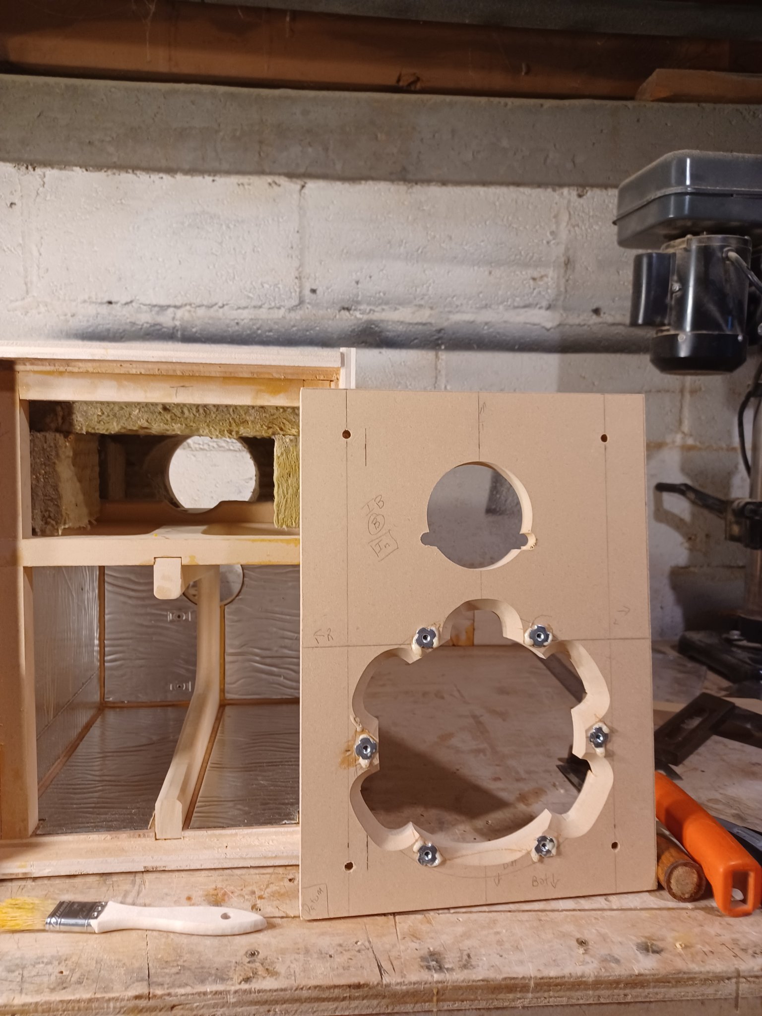

I went back and forth between sealed or vented cabinets but eventually deciding on vented because these were to be used for two channel listening and possibly without a sub-woofer. By modeling with WinSID I ended up with a 19.9 liter enclosure with a 2 ½ by 8 ½ inch port tuned to 42.5 Hz. The only problem with this box alignment is the cone excursion exceeds Xmax at 30 watts with a signal below 35 Hz. This could be solved with a high pass filter but the component values are just too large. Therefore I chose to live with distortion below 35 Hz and risk damaging the woofer. I used three internal braces to tie all the sides together. The box has a 1 ½ inch chamfer on all the front edges, this was actually a mistake as the plans only had them on the sides and top. This happened when I was cutting the completed boxes on a table saw and accidently cut the bottom of one of the boxes. So like any wood worker I turned my mistake into a design decision and cut the other box too. I will not change the plans and if anyone decides to build these (not likely) they can be more careful.

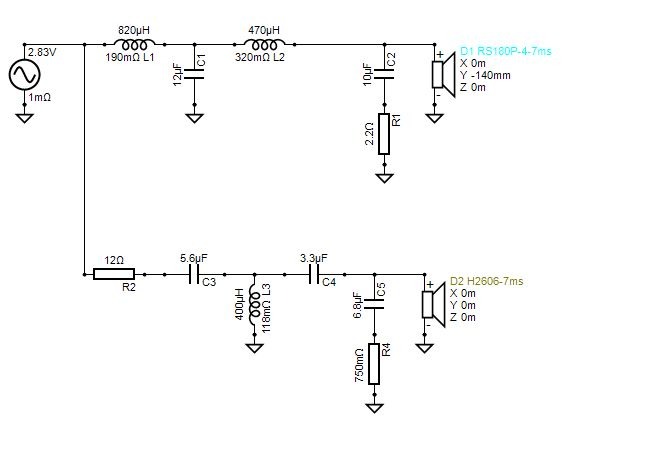

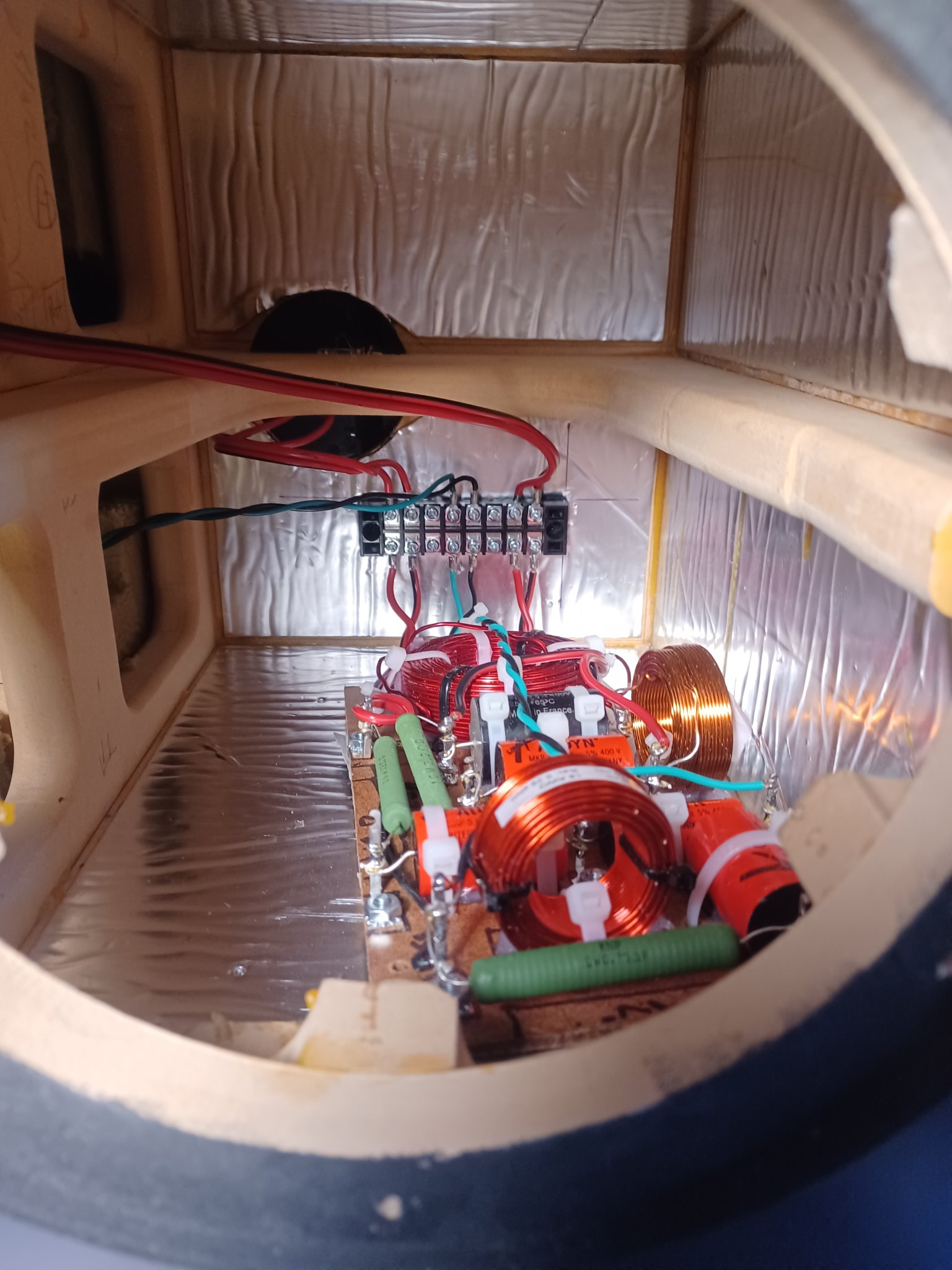

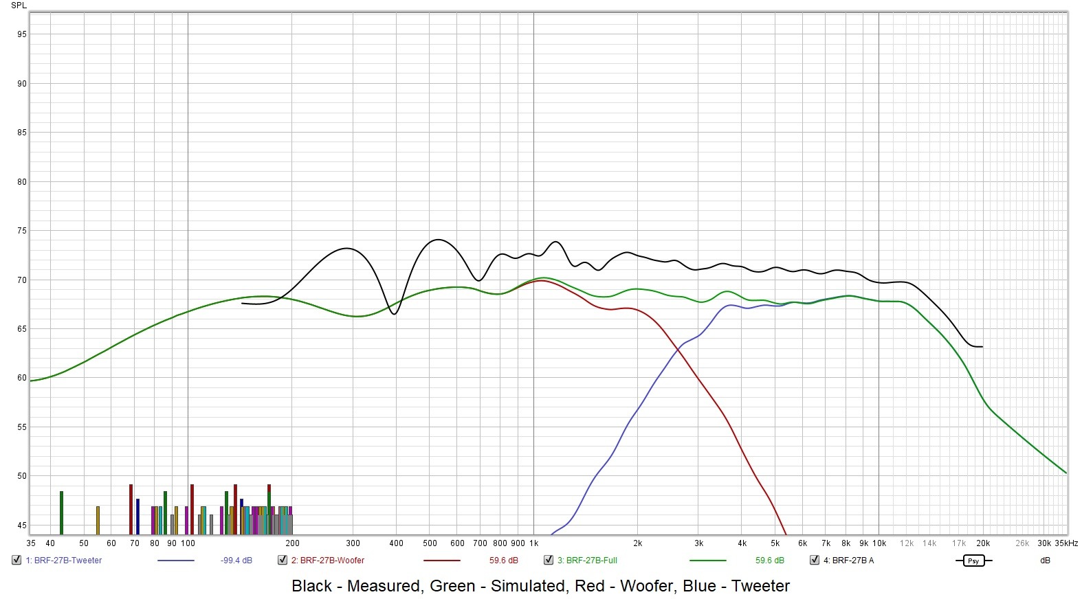

I made polar measurements of the drivers in the enclosure on a turntable in my backyard. The test stand is close to 8 feet tall so I could gate the measurement to about 6.5 ms. I used these measurements to model in VituixCAD. I targeted a 4th order Linkwitz-Riley acoustic slope at 2500 Hz. After about 7 to 10 versions I had what looked like a nice frequency response. The inductor in the low pass filter is oversized to compensate for the baffle step. I used Zobel networks on both drivers to flatten the impendence curves and made additional adjustments on the tweeter Zobel to flatten its rising response.

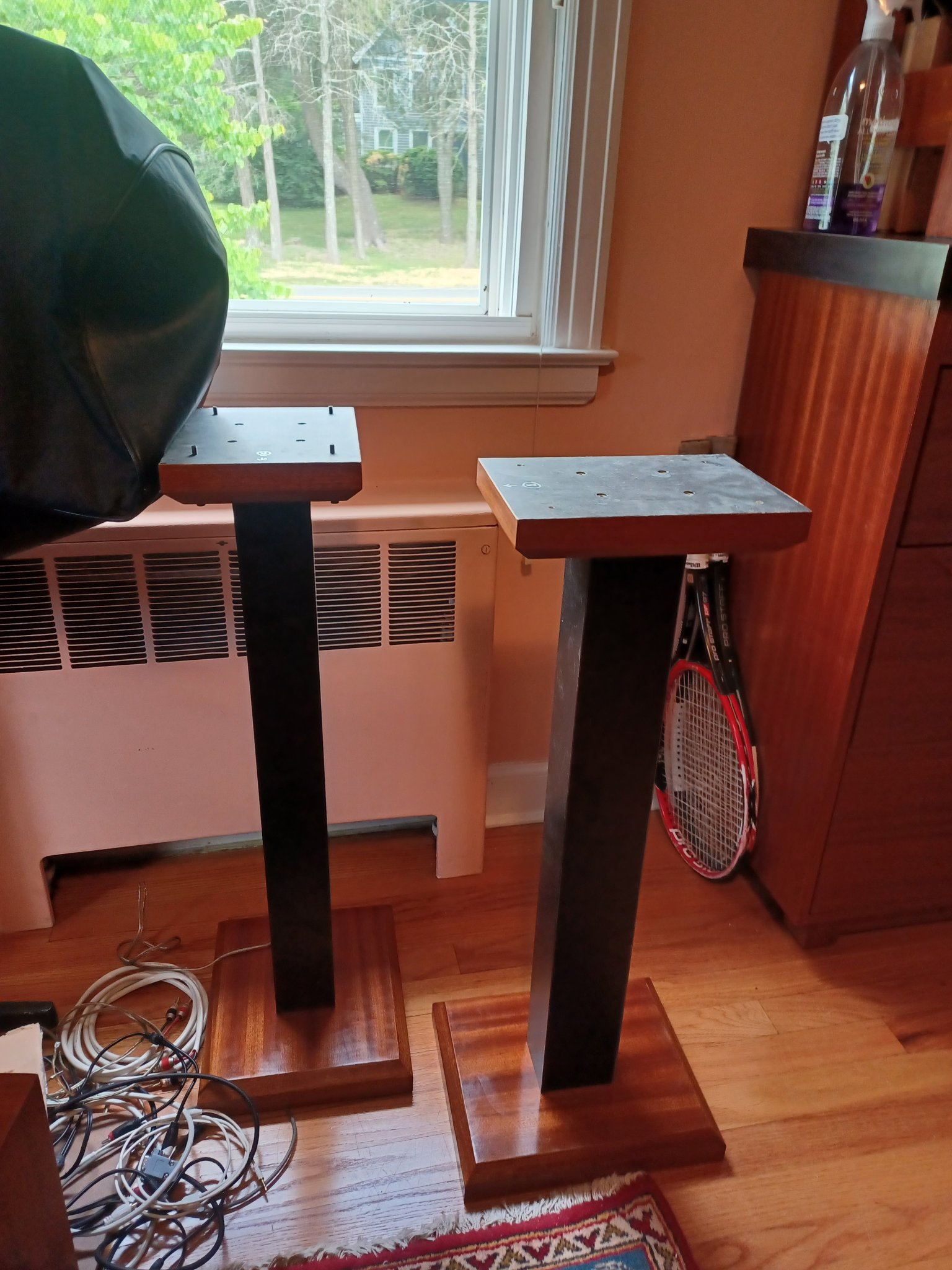

When I was done I had nearly enough material left to build stands but not enough ¾ plywood. I had to buy a 2 x 4 foot sheet of ¾ inch Sande plywood which is the lightest plywood I’ve ever used. I have no idea what it is made of, Balsa wood maybe, but it was fine for vertical post of a speaker stand. The top and bottom plates are made with two pieces of ¾ inch MDF laminated together and covered with the Sapele veneer. The posts are ¾ inch plywood rabbited together and laminated with matte black Formica. I put 10-32 threaded inserts in the bottoms of the speakers and used 2 inch 10-32 Allen cap screws to attach the stands to the speakers. I much prefer this method to BlueTac.
