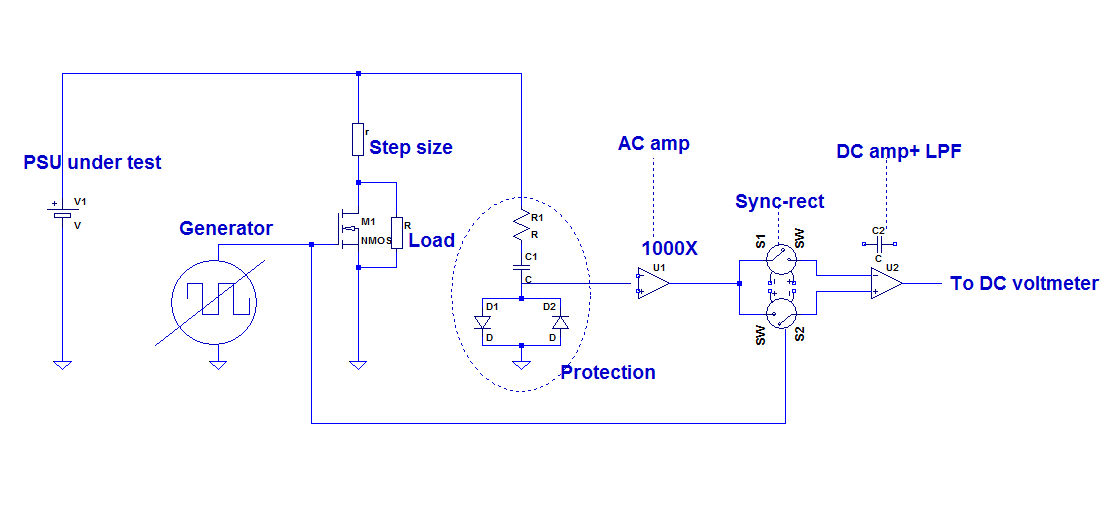

The standard method is that outlined by PRR, using a VNA as a source for stimulus + response measurement (with suitable port protections to deal with the HV, of course).
At a DIY level, a full-feature VNA, even from "cheap" asiatic vendors is probably not an option, thus your best bet is probably to duplicate a SNA using a generator and a microvoltmeter (both suitably protected, again), and it will work reasonably well if your supply has moderate performances.
If the impedance is really low, you will have difficulties extracting the real impedance from a background of noise and ripple.
It is possible to build a simple (and expendable) VNA mock-up jig, using as a stimulus a power MOSfet switch associated with series and // power resistors, to define the load current and the step size, and a simple synchronous rectifier to measure the (~vector) result.
Here is a simplified ouline of the test-jig:

It will make µΩ-level impedances accessible for frequencies of ~0 to at least 10kHz using just a simple multimeter as display device.
The measurement will be made using a squarewave, not a sine, meaning there will be some minor inaccuracies, but most of them will be eliminated by the syn-rect + LPF processing.
The vector nature of the impedance could cause more severe inaccuracies, and if it is a problem, you could "explore" the phase, by varying the phaseshift between the generator and the sync-rect.

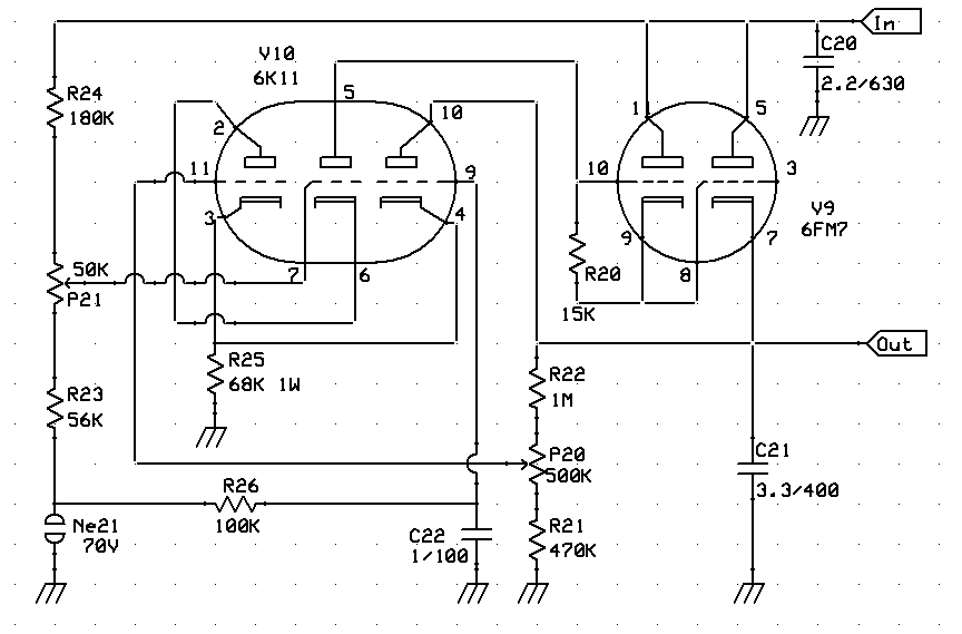

Thanks for your answers. Elvee's solution is the nearer to what I need.
What I want to do is to measure the output impedance of the regulator depicted in the next schematic. It appears to be complicated because of my way of drawing the tubes, but essentially it is quite simple. The 6K11 has 2 hi µ triodes (Like a 12AX7) wired as a cascode, and a medium µ like a 6C4 or half 12AU7 in the same envelope. The medium µ is a cathode follower from the neon lamp reference, slightly filtered, and whose anode current is about 1mA, while the cascode is about 100µA, so the follower current clearly dominates cathode's node voltage. The 6FM7 has a hi µ unit acting as a active load for the cascode and also attacks in low impedance the grid of the lo µ unit, in such a way that if the load is high and input voltage is low, its grid may draw current from the hi µ and still maintaining hi impedance to the cascode DC amp and maintain regulation, a thing that I had proved to be of good performance, and that I learn in the US patent below to be done some years ago. I use a bit different topology in my project. The voltage sensing attenuator is wired to the bottom cascode grid with a net gain estimated of to be above one thousand times.
The point actually resides in the top grid of the cascode. It is feed from a voltage divider from input side of the regulator, and this way one can inject input voltage variation in the circuit without passing through the regulator, and compensating such variations in advance. All the facts descripted here, was read from an old article from M. G. Scroggie in the part II of an article entitled "Stabilized Power Supplies" in the Wireless World in the issue October 1948 page 377 magazine actually scanned and filed in THE HISTORY OF RADIO documented in thousands of PDF books and magazines where it can be read and downloaded for free. Scroggie uses in this item ,a pentode but I want to try my version with cascode, substituting µg2-g1 for bottom µ and µg2 plate for top µ values. A variation of the same idea is being now used in some buck switching regulators like ST's L4971 and many other.
As the author said, there is a point of the adjust of such value that you can compensate exactly for line variation, a further adjust permits you to vanish the regulator's output impedance, and still further adjust enables to vanish also rectifier's and filter's resistance, with a slightly overcompensation of the line regulation. In my case, I prefer the last situation, say, null output impedance (Or slightly negative) over good line regulation. So I want to know the best way to directly measure it while adjusting my P21 preset.
All suggestions are welcomed.

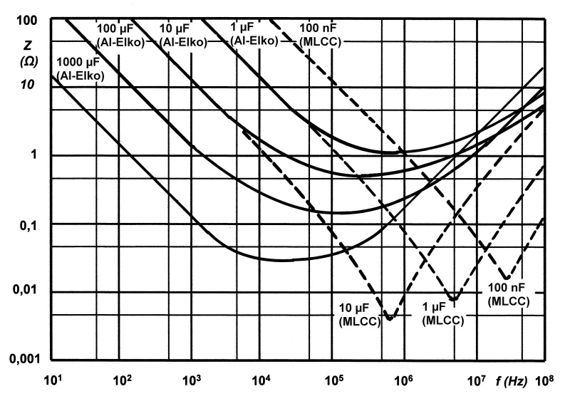

...Big cap becomes inductive above a few kHz.
Modern big caps hold very low impedance to above the range of gain of broadband tube amps. See attached. If a 100uFd cap is good-enough at 100Hz, then it is good-enough to past 100MHz. (Assuming very short connections.)

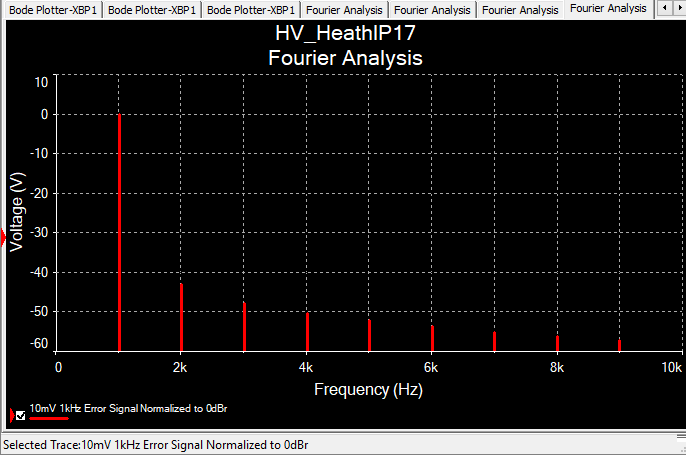

Do this experiment -- resistively load a tube regulator to 25mA -- put a 1kHz 100mV signal on the load and run an FFT.
and here's what happens with a tube regulator -- the error/control amplifier isn't fast enough to keep up with modulation of the output so harmonics occur on the B+. If you have a regulated stage with poor PSRR it's going to be affected by these harmonics. (Note the scale is dBr 10mV)
