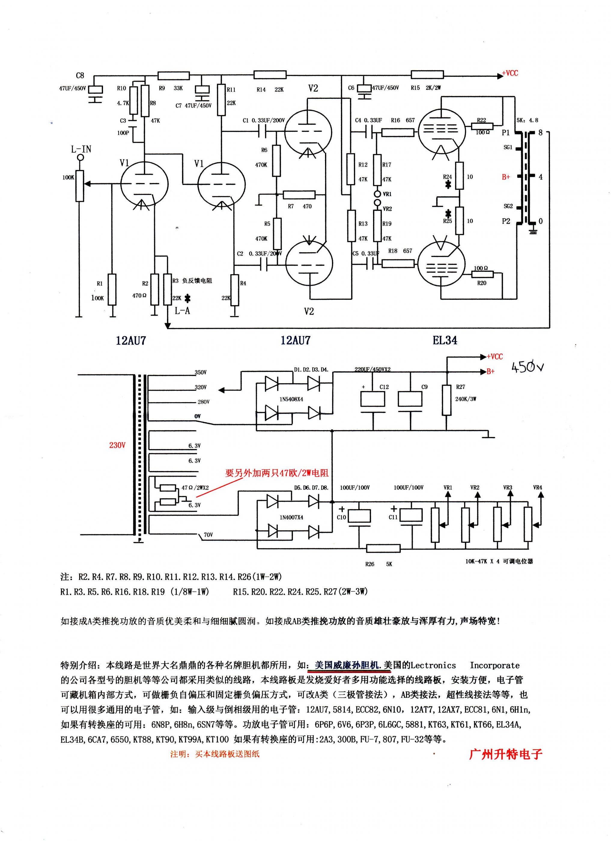

Now I've built a few.
My first was JLH 80W MOS-FET amp which really blew my socks off back in the 1990s.
That was only beaten a few years ago when I built a Pass Aleph 4. Now that is seriously nice amplifier.
But, recently I built a Pass Aleph J. Although not as powerful, it is just so sweet to listen to compared to the Aleph 4.
Last week I finished a Williamson 5-20 EL34 amplifier which, to my ears knocks the socks off all of the others.
The Williamson just has so much more depth to its sound and far more control of the deep bass all the way through to the high treble.

Shouldn't that be Mullard 5-20?
jeff
If anybody else builds this add some resistors in series with the bias pots to ground so you cannot put the grids right up to 0V.
The Mullard and the Williamson are quite different. I am turned off by the “long” front-end of the williamson topology.
dave
Well, 5-20 was a Mullard label for sure. The OP has clearly built a Williamson but it could be called 5-20 as well. That label just means 5 tubes for 20W.
No, this is the Williamson 5-20.
Hahaha, leave it to the Chinese to re-invent the history of electronics, lol.
I think somebody in China was granted a patent on the hum-bucker pickup quite recently. Wish I could say I was shocked...LOL

John Linsley Hood designed his class A amplifier in order to replace his Williamson amplifier that he found himself lucky to own the best version. By listening comparatively with several friends they found the transistor amp at least as good as the tube one. What do you think?Now I've built a few.

PS Original Williamson uses KT66.
