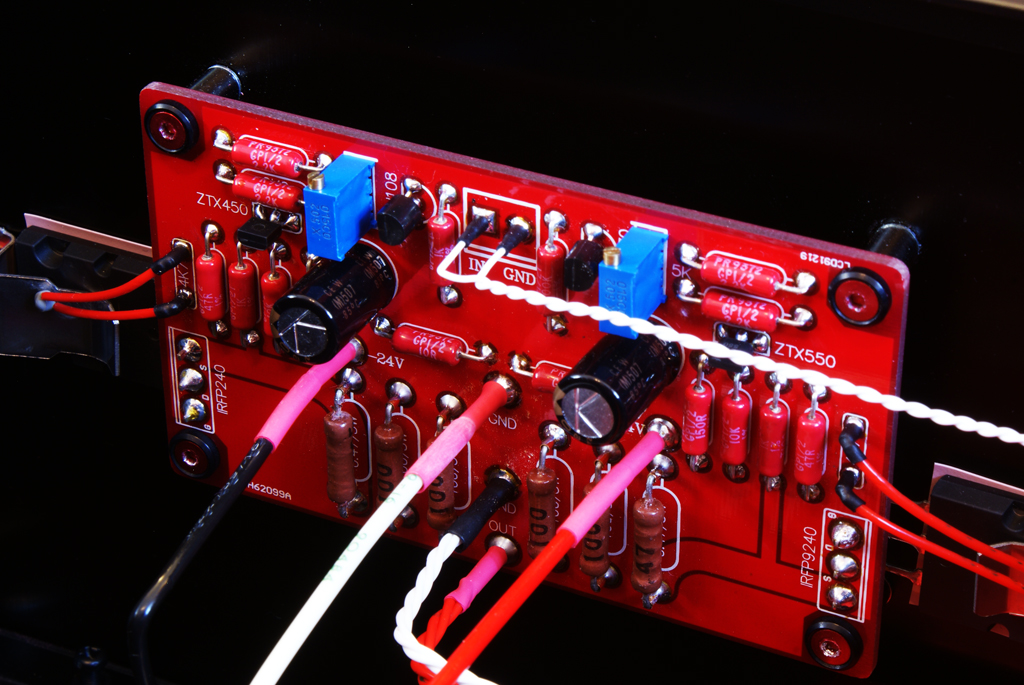

This F5 here, can anyone guess what the two red boxes are ? and what transformer that might be ?
and one more... that black cable on the power switch whats the name for that ?
The wire used here, what kind of wire would this be ? or where to buy ? lol
anyone know a source of clips that can hold down the Mosfets, i like that!
Im going to build the pre or B1, into the same chassis as the F5, along with inputs, selector switch etc

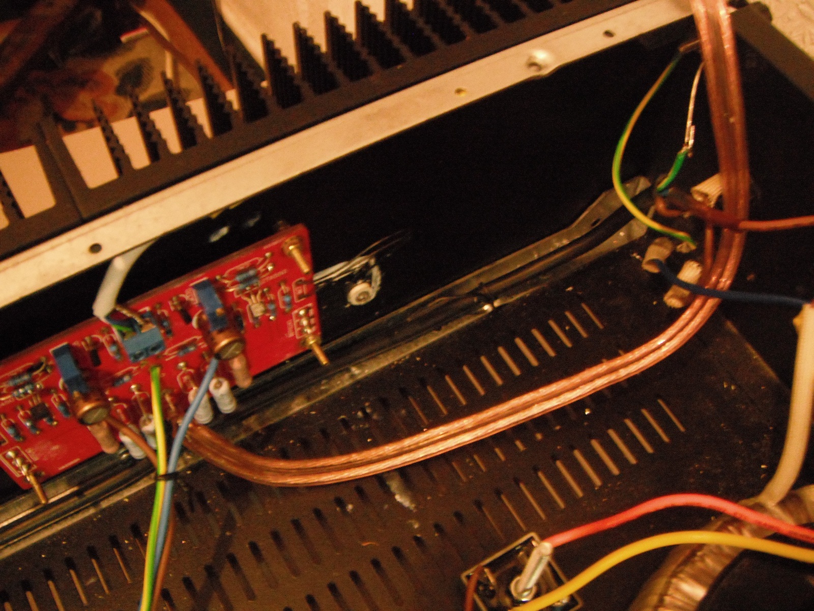

Rix,
you have twisted the low level inputs, but left a big loop just before the PCB.
All the high currents wire pairs/triplets are untwisted. BIG loops.
Rix,

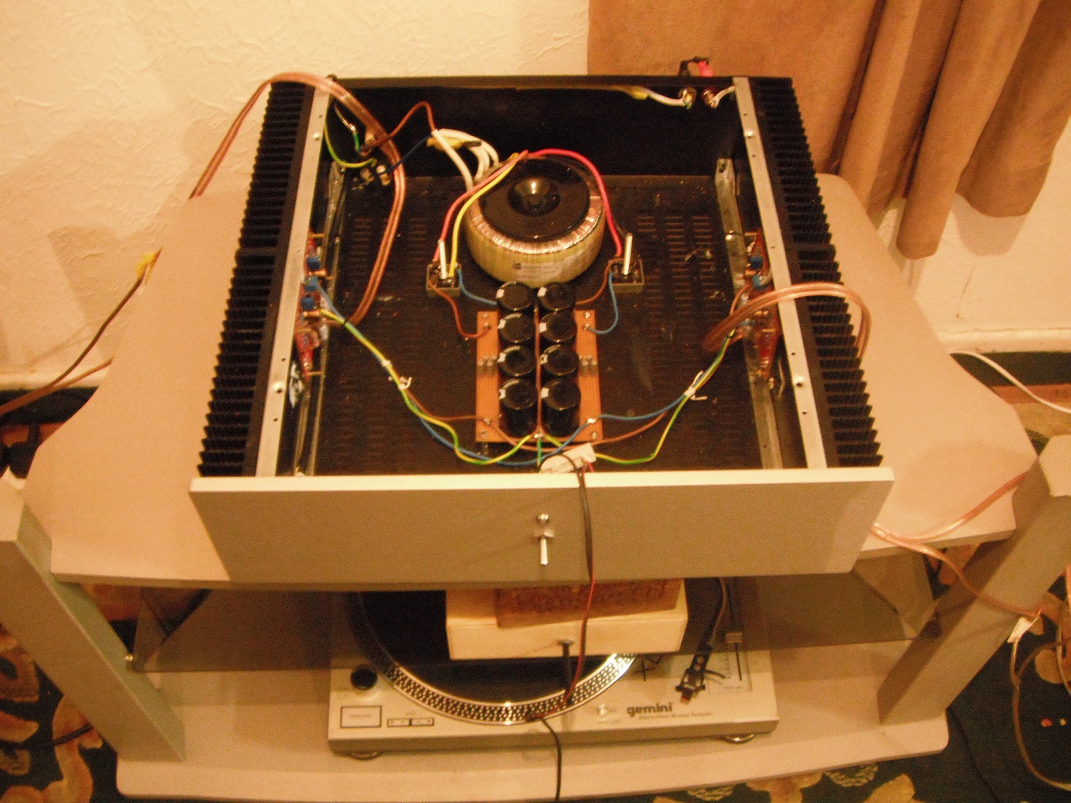

Sorry m8 non comprehend lol, do you mean on the amp in the first post or my amp, here's mine just before we did the finishing touches like put speaker terminals in and cleaned up inside.
Ahh, ok thanks to be honest i hadn't realized before that twisting/not twisting wires could effect anything.
I've heard of twisting signal wires but not power wires. What's the benefit? Now I need to crack my B1/F5 open and do that.

It looks like braided polyester and heatshrink sleaving available from Kayfast on ebay or I would think Maplins also.
Im still wondering what those components are in the Red/black amp i posted at the beginning of this thread if anyone knows ? the red boxes left and right of the PSU. and what that power switch lead covering could be made of ?
inductors perhaps part of the LCR filtering for the PSU ? just a guess ....
Thanks it seems so, just liked the look of that one.
