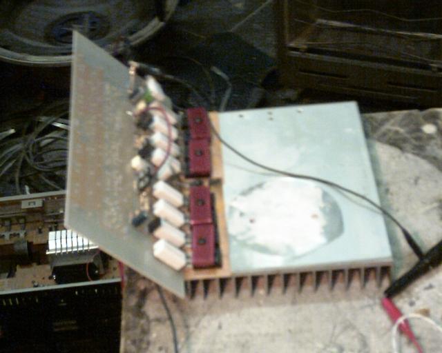

I have realized the AV400 from Mr.Holton. I have designed my own pcb with 2 channel on a 10x18 board.
First impression: never listened to a so clean and naturaly power amp!
But there is a problem: the biasing!!
I'm running it with +-35v and with the trimmer i can set the bias more high than the 18mv read on the Source resistor of the mosfet... The amp became hot in fiew minutes...
What's the problem? +-35v is right? I have only this PSU.

I use a quite big heat sink, the problem is that i can set a bias current of 250ma x device as minimum... with the trimmer at 0ohm! Probably there is to modify some resistor value for run @ +-35v.....
The Vbe multiplier transistor is mounted on the heat sink at 0,5cm from the OP devices....
After 5 minutes of a sine wave @ 2 watt on a 8 ohm load the heat sink reach 40'!!!
I have not done power test for the moment because i don't feel confident with the amp.

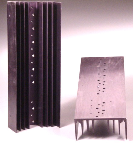

How big is quite big? You might be surprised at how big you really need, idling at 9 watts per device. For example, I have a protptype mini aleph that gets a 30 degree rise on the sinks at 35 watts on two devices. The heat sink is 4"x2"x12" long - one of these from Apex Jr.

BobEllis said:For example, I have a protptype mini aleph that gets a 30 degree rise on the sinks at 35 watts on two devices. The heat sink is 4"x2"x12" long - one of these from Apex Jr.
Great sinks those are. 🙂
Every thing resolved!! Was a pin of the Vbe multiplier transistor (collector) that has broken in a not visible point!! Now the amp run cool and sound better!!!
It reach only 35 degrees at full output power on 4 ohm! Now the power is around 150w on 4 ohm (+-35v 600VA supply).

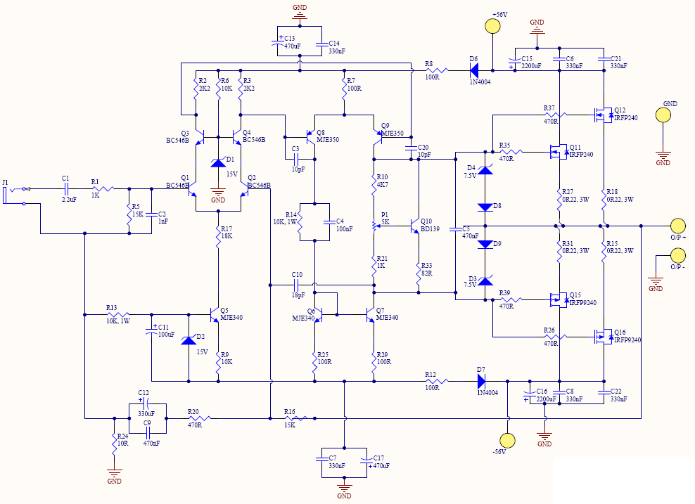

ciao, volevo chiederti se hai dovuto apportare qualche modifica allo schema originale poichè lo alimenti a +- 35v e non a +- 70v.
anch'io ho costruito un av400, ma ho alcuni problemi..posso chiederti una mano per risolverli?
io lo alimento a +-56v, seguendo la modifica apportata da un utente. lo schema modificato è quello allegato.
riferendomi allo schema, i transistor q6 q7 q8 q9 e q5 scaldano un po.. ma il problema principale è che ai capi delle resistenze di source qualle da 0.22 nn ho i 18mv..
ho misurato le tensioni ai capi di R2 R3 R7 R25 R29 e sono vicine a quelle riportate nel PRE-FLIGHT TEST del documento di holton.
sapresti aiutarmi?

i saw that you use a +-35v instead of +-70v. have you done some modification's on the original anthony's schema?
i have some problem with my av400.. i use the schema shows below, with a +-56v power supply.
the transistors q6 q7 q8 q9 e q5 are quiet hot, but the real problem is that i haven't no voltage across the source's resistors.
the voltages across R2 R3 R7 R25 R29 are slightly lower of the voltages writes on the pre-flight test in the holton's document.
someone could help me??
