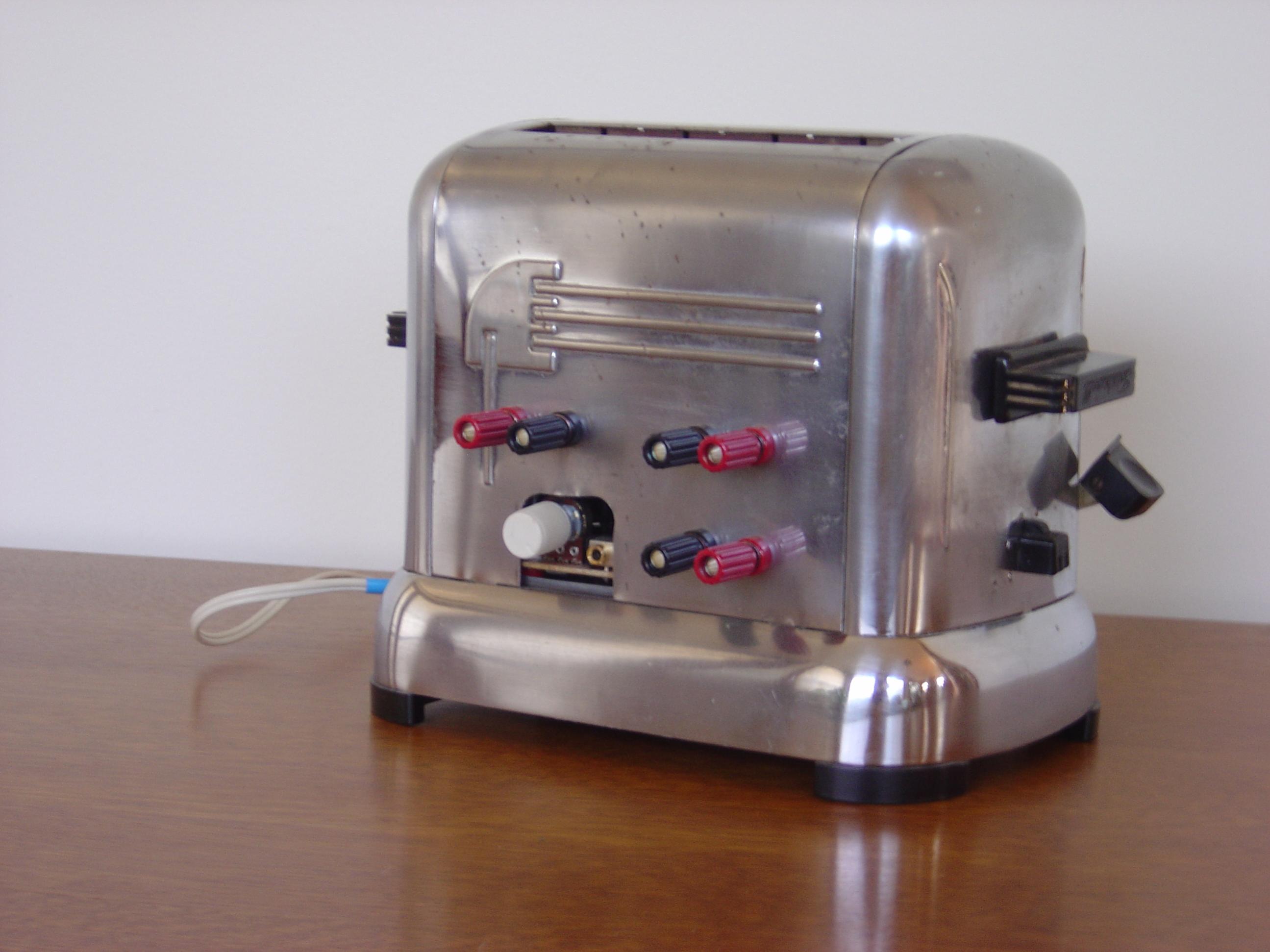

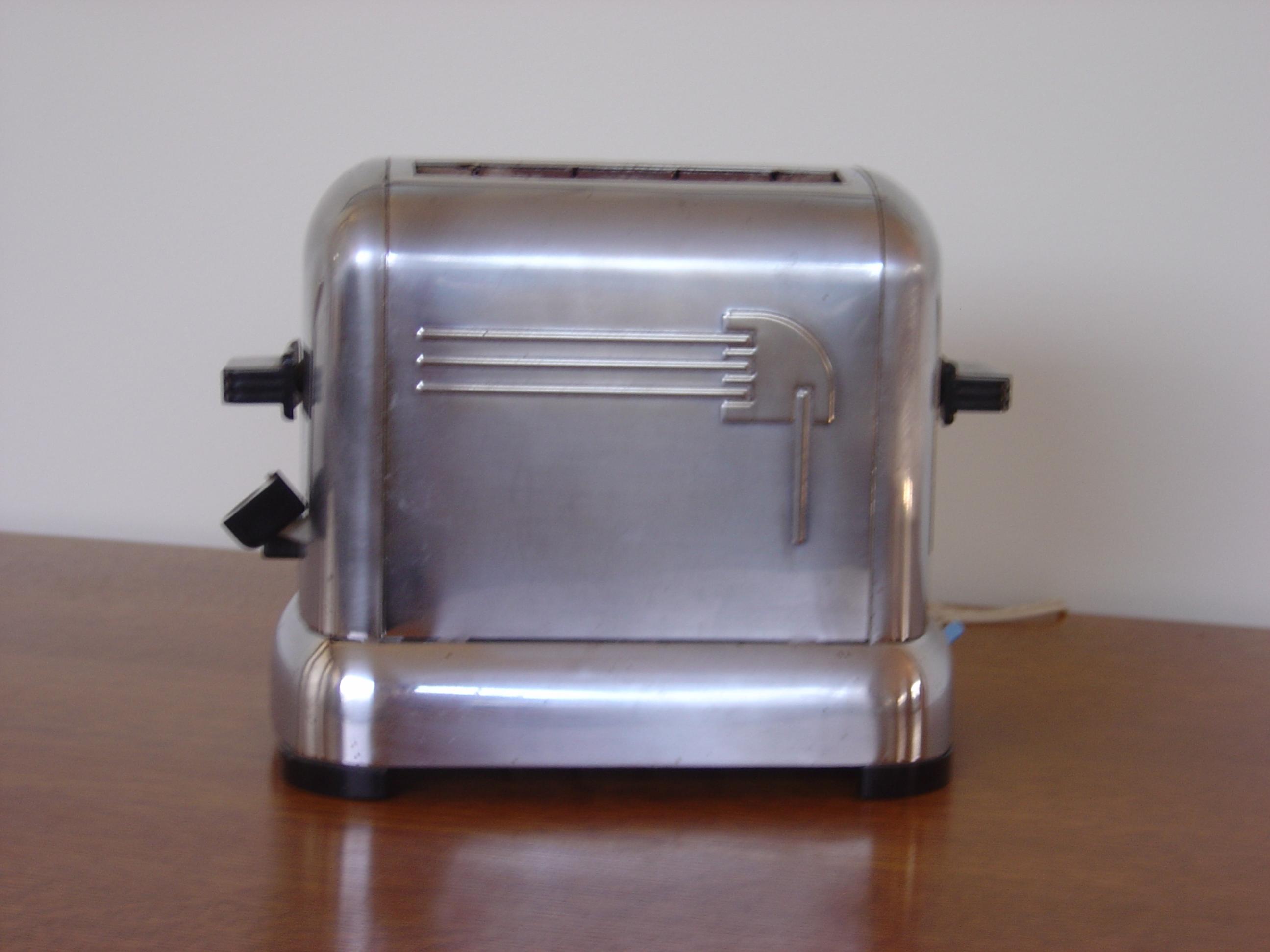

Went with another case, which worked for a while, but DIY work is never done. 😉 Found this case at the GW yesterday, works pretty well. No drilling for power cord or inputs/outputs.
- Class D
- The Audio Toaster
