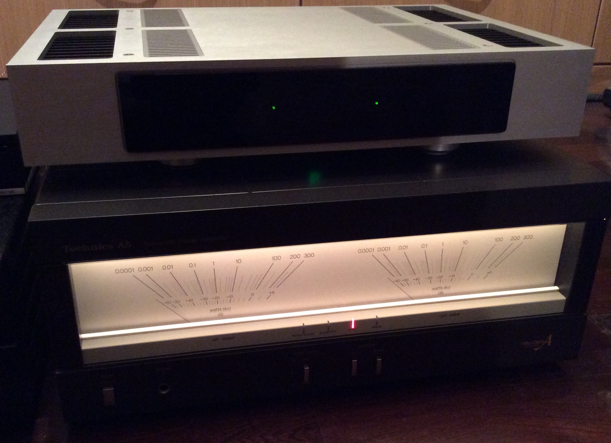

Just recently upgraded Technics SE-A5, could not stand its original performance. Now playing very well but still miles away from my latest FO iteration. At least five major things to Sansui's VFA topology you've presented can be performed to improve sound substantially.

All five changes to front-end topology, still remaining VFA but improved substantionally soundwise. Power supply, recaping and similar mods are meaningless. Below SE-A5 and FO.
