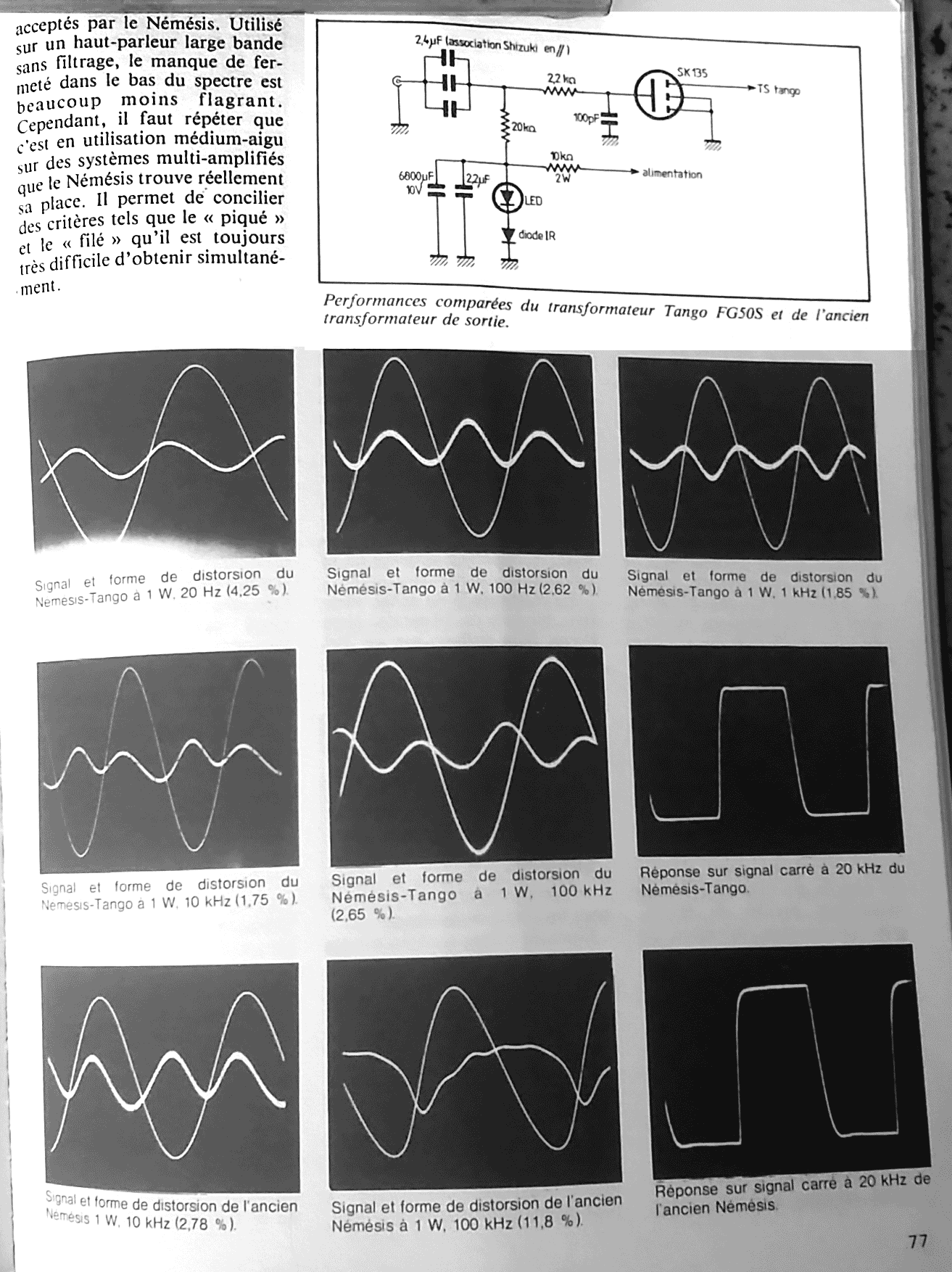

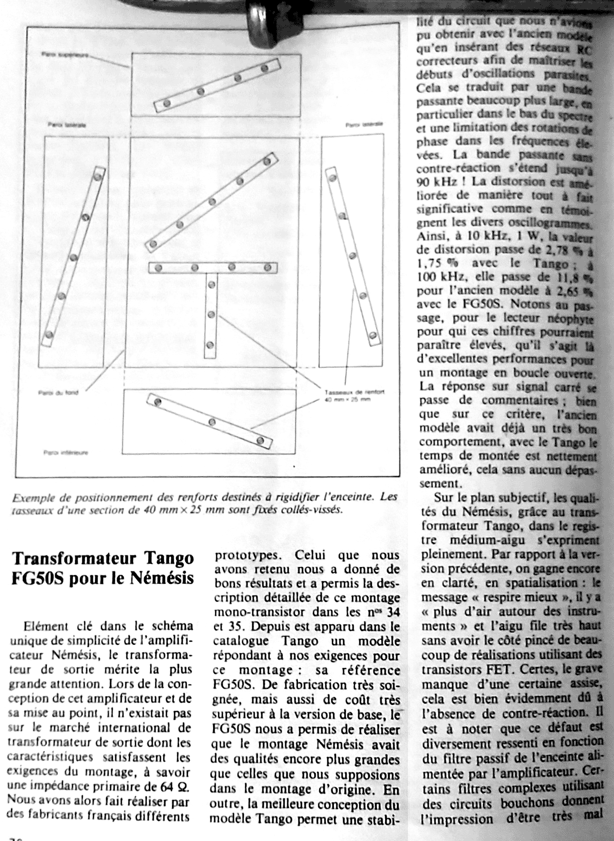

Tango fg50s
Hello,
My friend in Vietnam who put photos here told me he bought a pair of Tango FG50S. I remember reading about the nemesis by Jean Hiraga and later they did come up with this Tango instead of the much cheaper original transformer.
Take a look at the figures.
Greetings, eduard

Many thanks! I will create a new topic and post some images of my Tango when I get it at next month😛
