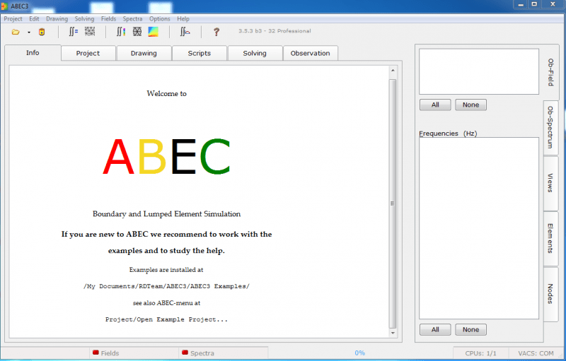

I assume that you have installed and loaded the program and the help and example files.
After starting ABEC you are greeted warmly by the start screen
In my opinion it makes sense to open the examples and just take a look. The scripts that I initially work with are roughly based on the example 'Speaker Cabinet SP38' (C:\xxx\RDTeam\ABEC3\ABEC3 Examples\BEM\Loudspeakers\Speaker Cabinet SP38).

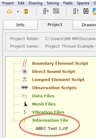

"Hello,

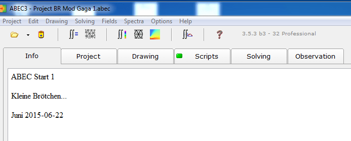

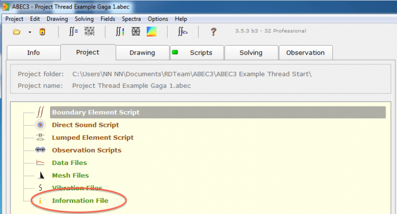

how can you load information about the ABEC project so that it is displayed under the 'Info' tab?
By clicking on the 'Project' tab, you can create a project, i.e. load scripts that describe the project and tell ABEC how and what should be simulated: The individual scripts and files that can be loaded here
or need to do more, step by step.

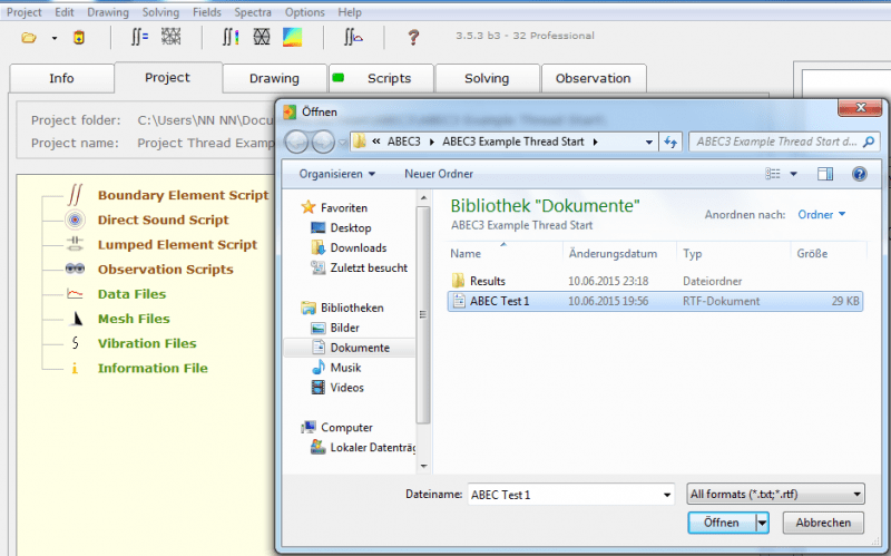

First, the information about your own ABEC project: The information text about the project can be loaded by double-clicking on 'Information File'. A document window opens and ABEC now wants to load the information text. ABEC expects a text file in .rtf format here.
In this case, I simply wrote the text in Word and
saved the file as an RTF document in the ABEC project folder.
After the rtf file has been loaded, it appears in the project window:
...and of course also in the info window:
In principle, this works the same way with the BEM, LEM and observation scripts that we need to describe an ABEC project . However, these scripts must be loaded in .txt format and can be opened and modified at any time in ABEC by double-clicking...

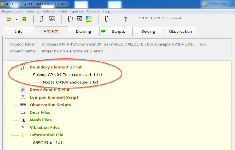

Like the 'Information File', the BEM script (txt file) can be loaded by double-clicking on 'Boundary Element Script':
picture.php
The example BEM script for the CP-104 BR box is divided into two text documents, the 'Solving Script' and the 'Nodes Script'. This doesn't necessarily have to be the case; all the information could also be contained in a script.
First, the 'solving script,' here the part with the calculation instructions for ABEC. It's super simple in this example:
// ABEC3 Solving File
// Project: CP104 Enclosure 1
// Reference to another text file in which the enclosure coordinates (nodes) are described
File="Nodes CP104 Enclosure 1.txt"

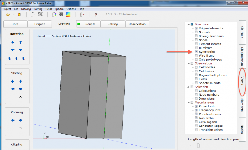

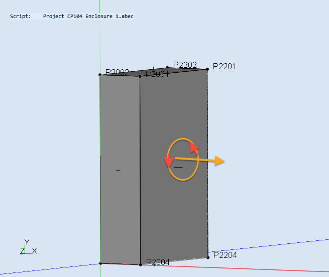

"I was thinking about describing a case using 'nodes' and 'elements' in detail, step by step. It might be rather boring for people who are familiar with ABEC, but I think it makes sense to start the thread.
In my experience, it's a good idea to first simply draw the case and its dimensions on a piece of paper and number the case corners (nodes). I did this once for the CP-104 test case:
picture.php
In addition to the numbered case corners, I drew the case dimensions (148mm x 297mm x 200mm, W x H x D, external) and the spatial dimensions x, y, and z.
Since the case is symmetrical along the yz surface, i.e. the x-axis, I only drew half the case width. That's why the solving script says 'Sym=x'. Why so complicated? It saves computational effort and thus processing time, which can be quite useful later on, depending on the project.
What you can also see in the drawing is the order in which the vertices/nodes are numbered. This will be important later, when surfaces ('elements') are created from the vertices. I'll come back to this.
