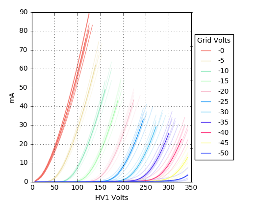

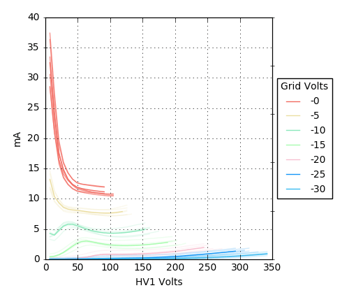

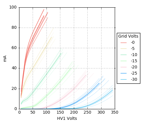

I've tested 6 of them for my friends, but since he wanted to use them in a push-pull headphone amplifier. I only scanned the triode connected curves and 43% 190V Ultra Linear connected curves of them (his OPT has 43% UL taps, and 190V B+ seems to be OK according to the curves).
Hope these could be helpful.
Triode Connected
Plate Current in Ultra Linear 43% and 190V B+
Grid2 Current in Ultra Linear 43% and 190V B+
