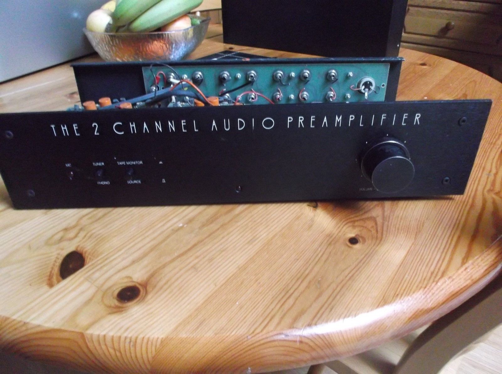

i need schematic or service manual for this model of preamplifier made by Electrocompaniet 1976. Preamplifier manufactured in Norse Ecosse Electric in Glenrothes, Scotland.

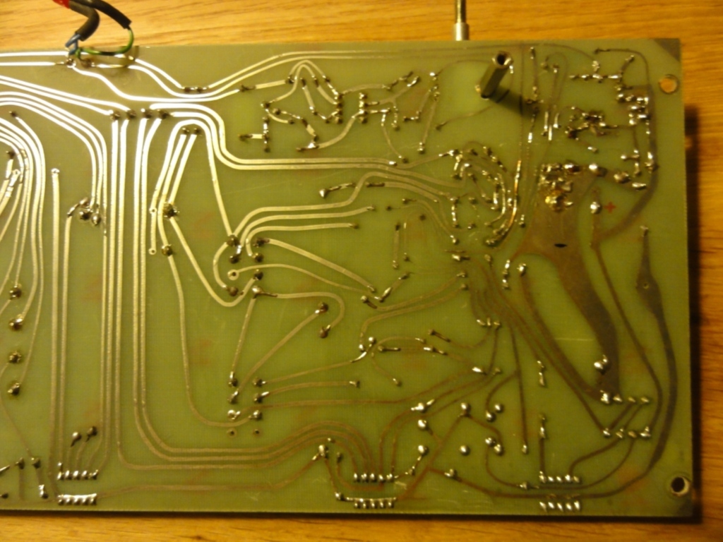

That words not stop me to draw schematic looking in the PCB. I will save three hours with schematic but: men`s got a do what men`s got a do!

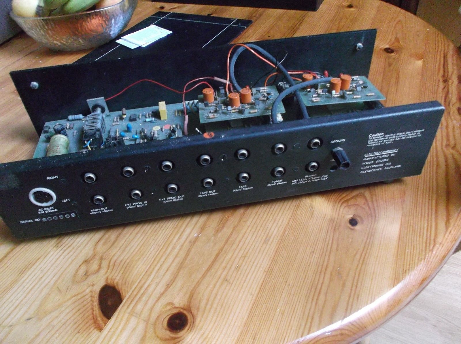

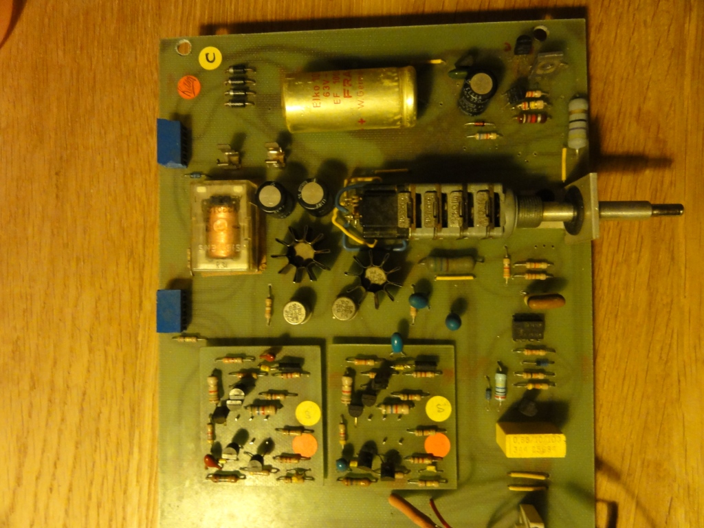

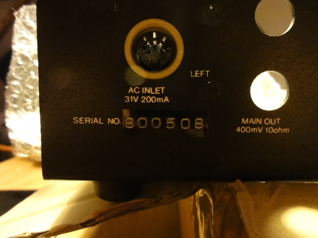

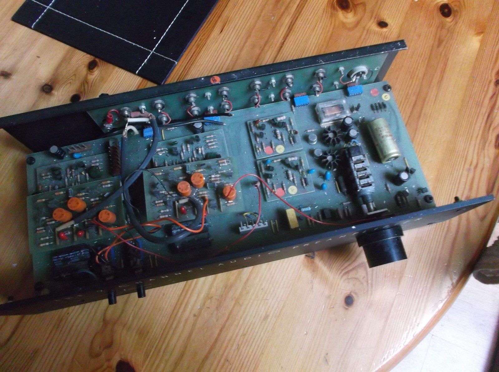

Hi!
I just got this preamplifier from Scotland but in non working condition-few parts missing including cover plate so looks like this will be my first diy project.
Any advice on missing parts or original schematic would be welcome.
Here are some pics and original ebay listing.

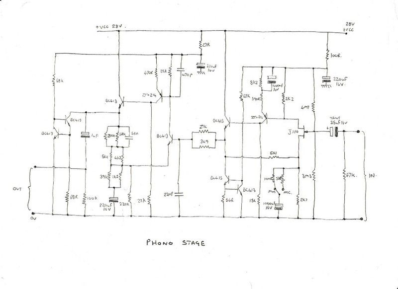

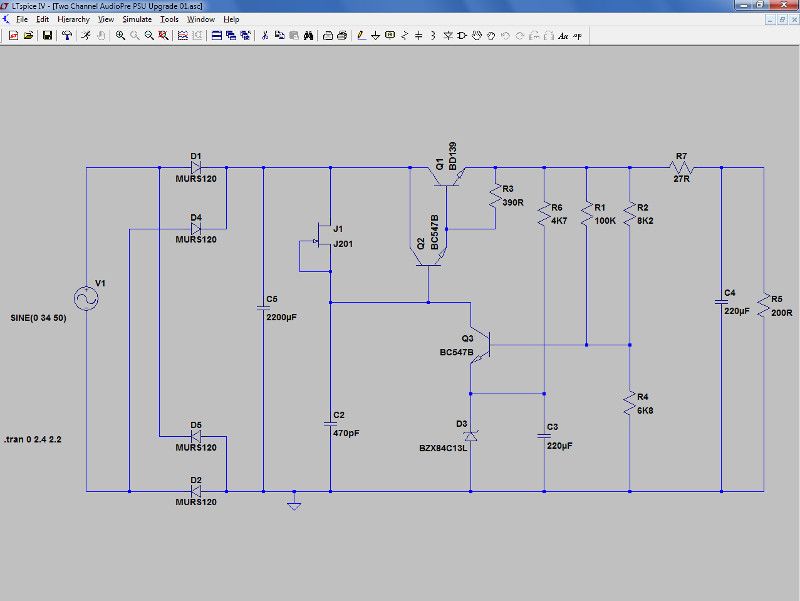

Phono Stage.
The phonostage shows the correct transistors.

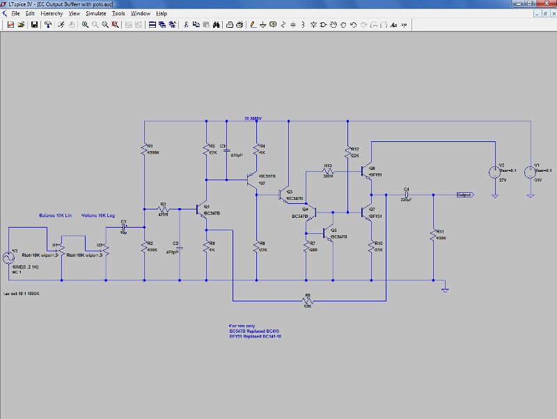

Buffer and preamp main output stage.
Power supply.
The semiconductors show in the buffer and psu are just what was in LTspice.

Thanks msdin for your help!
Unfortunately previous owner adapted amp for some extra phono stages so it will be difficult task to restore it to its original condition. Also there are few random parts across pcb missing. Ill post soon as i make some progress.
Thank you again msdin!

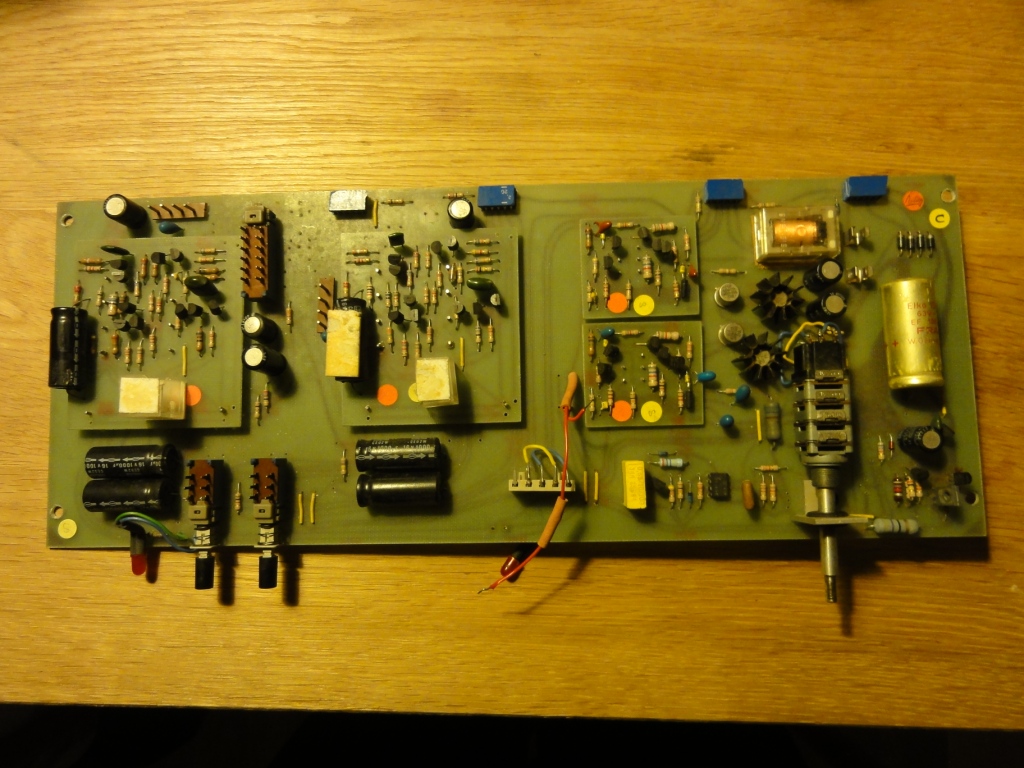

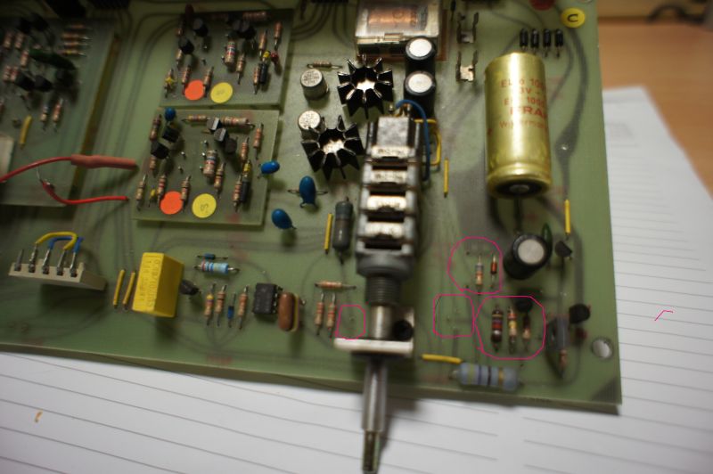

Fortunately pcb is almost same version, so pictures helped a lot.
I still have some parts that i dont know right values.
Two resistors on phono circuit and some in corner of pcb.
I attached photos with circled areas. If you know anything about these values would be in great help to finish repair.

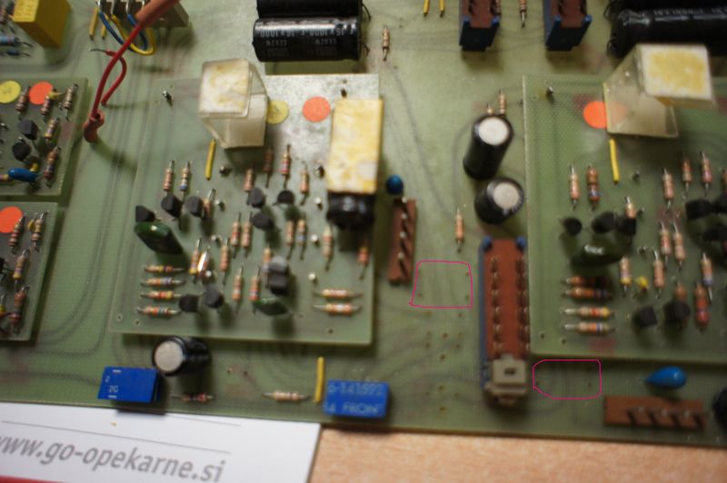

I'll have a look later today and take some more photo also I'll let you know the values of the missing component.
Sharif.

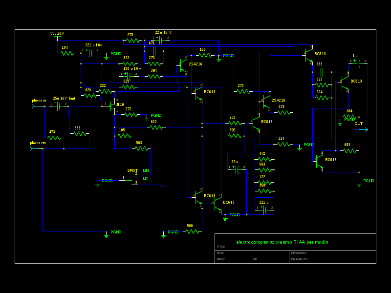

Thanks msdin for all the hard work.
What I like about this RIAA circuit is that the resistor and capacitor values are all standard within the 5% stock range. The LM49860 datasheet has an RIAA stage example with resistor values you can only buy in 100000 quantity, if that.
My computer cant read these jpg files (linux lubuntu 11 op system), so I put the phono board as best as I can read it in a png format through geda schematic editor. My appologies if I misread the values. My apologies also, the image uploaded can't be read. the png file has sufficient detail to blow up and look at, but I can't figure out how to list the file for download instead of the picture which is just a blur.

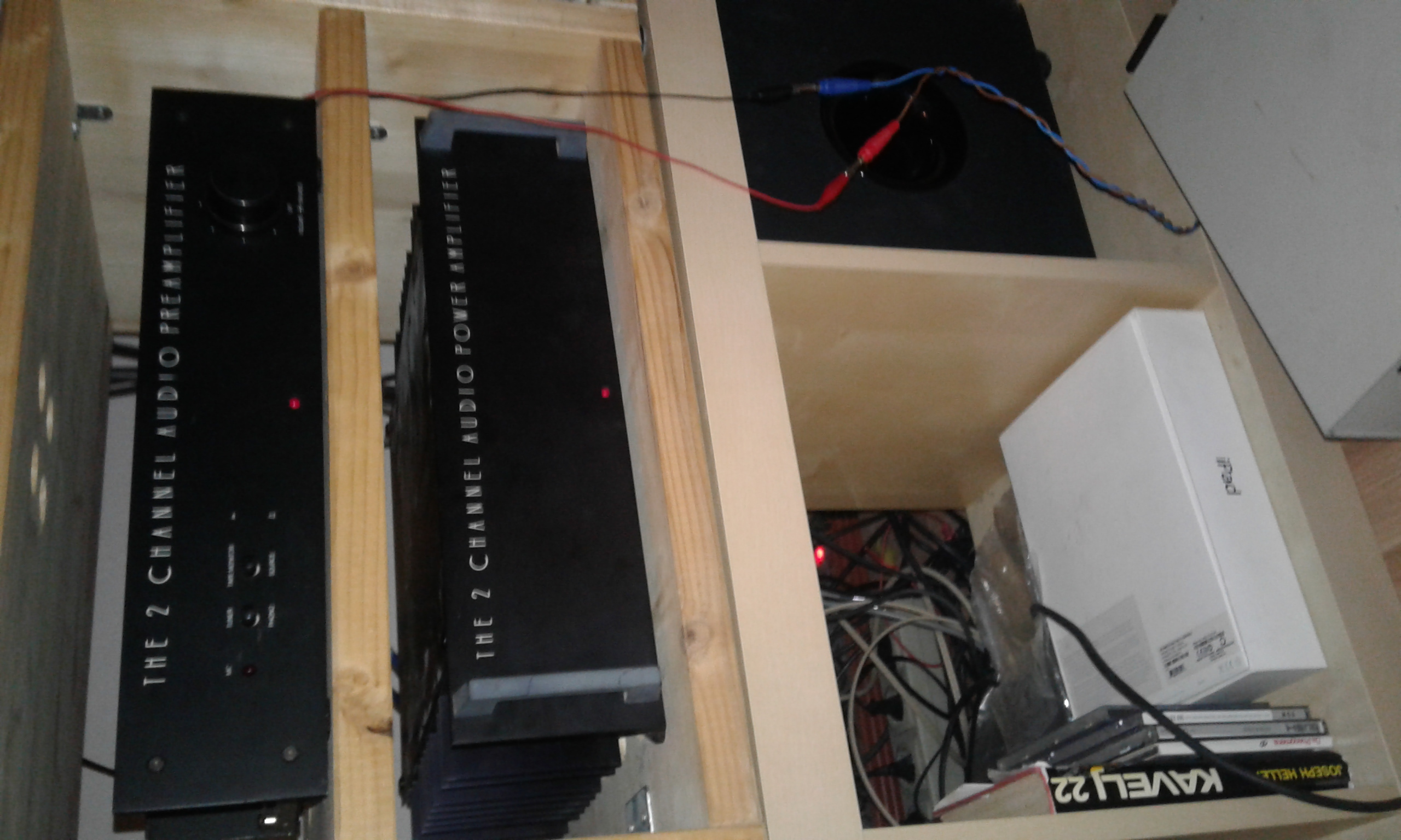

As you can see in the pics, I changed all caps mid 1990ies. The sound got better. But the Pre amp sounds a lot better when allways on.
Actually I already have some new caps in stock for my Pre, but changed my amp, so its not priority atm.

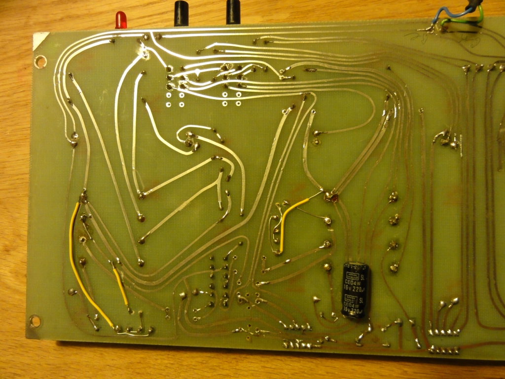

I just finished rebuild ( just cover still missing but that is...) , all voltages are in limits.
PCB trail was cut out on few places- dont know for what purpose. There were two Naim phono stages extra built in. Few photos of original attached. Ill do some listening tests with electro 25w and post some comments later on. Still connected to external psu- also that connections have been tampered.
Thanks all for help!!!
