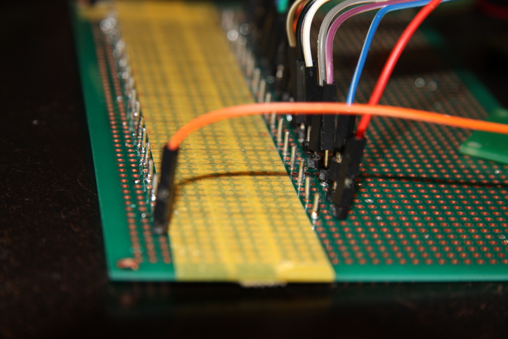

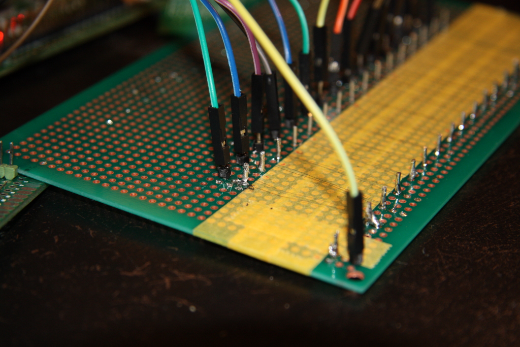

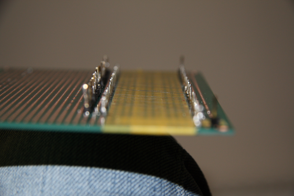

It did set my mind onto resistance wire though and, instead of winding my own resistors, I worked out a way to wind a whole DAC from a single piece of resistance wire. I purchased various kinds of resistance wire off of ebay; the one I ended up using is Constantan (Isostan brand), .05mm/44AWG. I also considered Nichrome and Manganin, they are available in smaller gauges and higher resistances, but harder to solder. Anyways, .05mm is thin enough, trust me. I ended up covering the PCB in yellow masking tape so that I had a light background against which I could, at least sometimes, through my magnifying glass, see the wire.

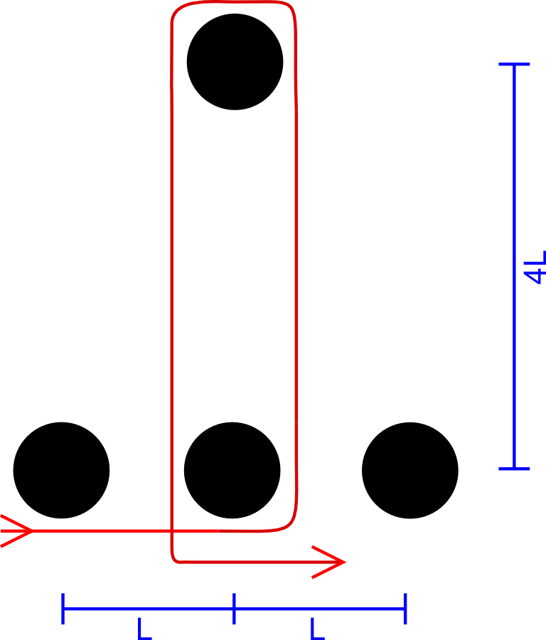

The way I set it up is to solder little metal posts to a perfboard in the right pattern; 3 holes distance between the rungs and 12 holes rung length (4 times the rung distance). This way I can run the wire from one rung to the next and then up and back down again. I attached a diagram to explain that part better. When using resistance wire, distance is essentially the same as resistance, thus I have a 1R resistance between rungs and the rung length is 4R in parallel with another 4R wire, yielding the required 2R. I managed to take a couple of photos of the finished product and in which you can see the wire. It's indeed made from a single piece of Constantan running from the ground post (yellow wire) all the way up to bit #16 and the output wire (orange), which went into a voltage follower opamp to keep the current in check.
Admittedly, this is a bit crazy, but it actually works. The Constantan I used is rated 250 Ohm/meter and the rungs are separated by about 7.68mm which means roughly R=2 Ohms. On paper, that sounds a bit low, but I managed to get it playing for about half an hour without burning the wire. I guess this might also depend on what you use to drive it and what kind of opamp you feed it into. There is of course the possibility to simply make it larger if that's a concern. There's also the possibility to build several of them on the same board and posts, essentially getting an averaging effect like in those DAC stacks... Oh my, I see a lot of very thin wire in my future.
So, how does it sound, I hear you ask? Still pretty noisy; it's a fantastic antenna! Apart from that however it sounds pretty good. It's definitely a _lot_ less non-linear compared to the cheap 5%-R-2R ladder I tried before. I couldn't find any problems with non-linearity whatsoever, in that respect it really surprised me. But the noise is still too bad to really compare it to a real DAC. I am thinking about potting it with epoxy and covering it with foil though...

You could place a copper foil underneath that yellow tape... and connect it to a good ground...
