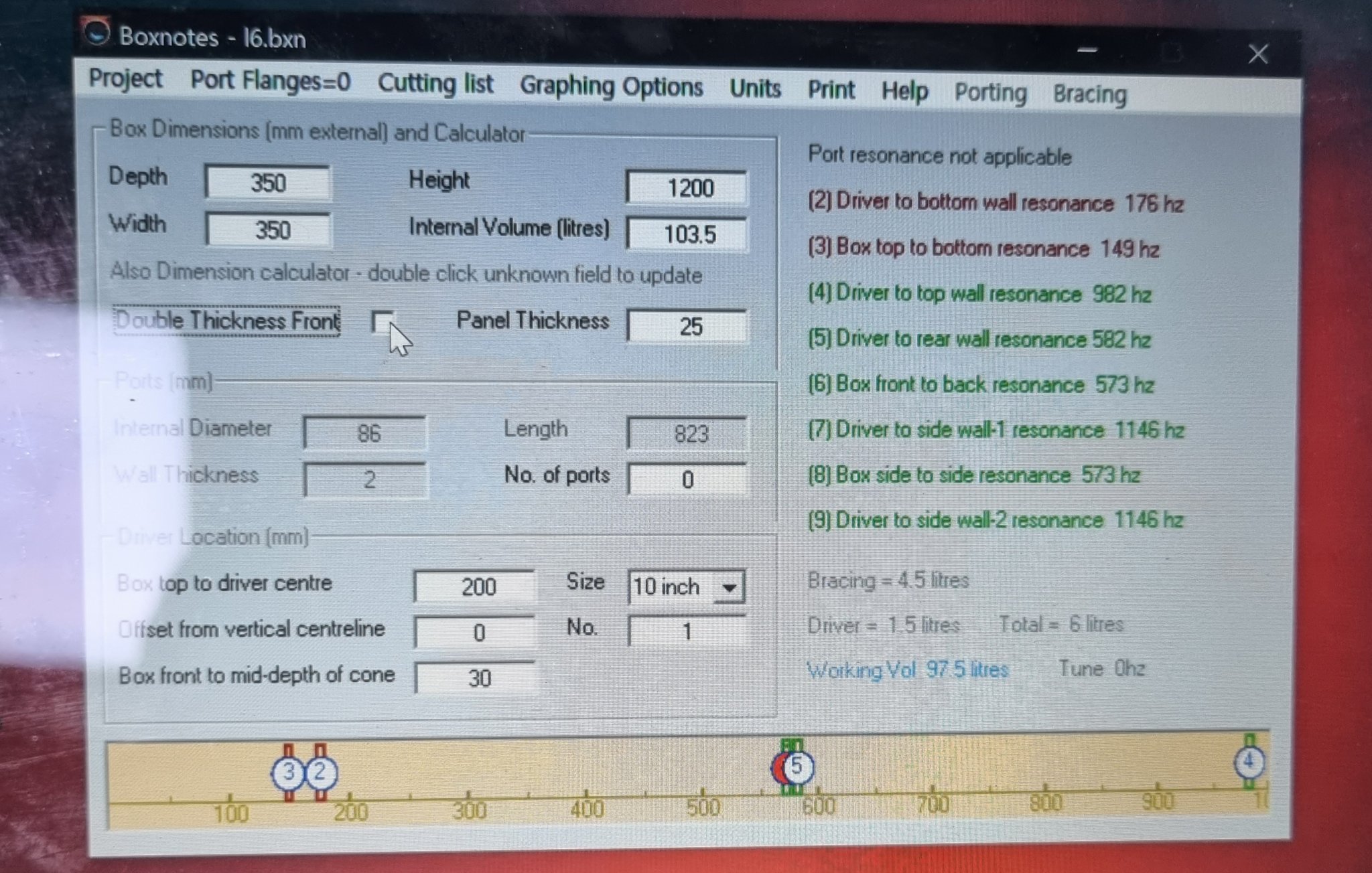

I was trying to build a fullrange sealed box with the volume of 30cm*30cm*115cm.
However, I have found threads on enclosure dimensions, pointing out:
'if the length of an edge is excessively greater (3 times as a rule of thumb) than the others, the box will act as an ML-TL, instead of behaving as a sealed box.'
is this phenomenon caused from standing waves within the enclosure?
as a humble hobbyist, I am quite not sure if I have understood it correctly...
if it is, would my enclosure design work properly as a sealed box, if I put in enough stuffing, to suppress the standing waves?
judging by the Boxnotes simulation, I assume that fully (in theory, as bass absorption would be a tough task) absorbing sound waves within the enclosure from 176hz and up would eliminate any unwanted resonances caused from standing waves... but I am again unsure of whether I understand how all this works.
No. Actually given it is a sealed box it can never morph into an ML-TL which is a quarter-wave resonance (ie has a hole in the box). It can morph into a sealed half-wave transmisison line. A half-wave line needs to be 2x as long as a quarter-wave line.
I would change the 30x30cmto soethign less square.

Yes, and no in that a sealed or vented box program assumes it has an air mass 'plug' of uniform particle density, but as its aspect ratio increases it begins to develop eigenmodes (open pipe in this case) with peaks/dips in the response modulating the driver(s), which in your case begins at ~34400/2/115 = ~150 Hz.
You can sim it in Hornresp where you can even find the ~ideal driver offset and amount of stuffing density to quell them.
Yes, this is the key.
The common view may be that even if you make the box bigger by making it wider you still have the long dimension standing waves. Some see this as OK because if you have more resonances they can possibly do a better job of evening each other out.
However, they can still be non minimum phase. It is still preferrable to damp them unless you want to use them.
