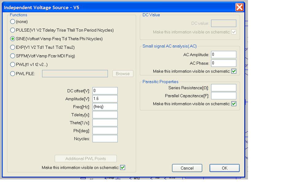

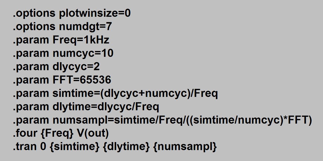

In the attached picture is the way I manage this (a copy from on this forum) a FFT analysis.
These should be written in your LTspice .asc file.
Behind the .four commando is the signal of where you wan't to have the fourrier analysis from. All the parameters between {} are variables.
For you input signal frequency you can use for example the variable {Freq}, this way you only have to change one parameter to have all the rest ok.
Hope I helped you a bit.

actually spice always has to interpolate for even sample times so the exact numsamples calculation is wasted
just use a .tran T_maxstep setting small enough to give (lots) more points than the fft
the .four is pretty old - most today like the much greater info from the fft plot that gives the releative amplitudes, distribution in a nice graphical presentation
