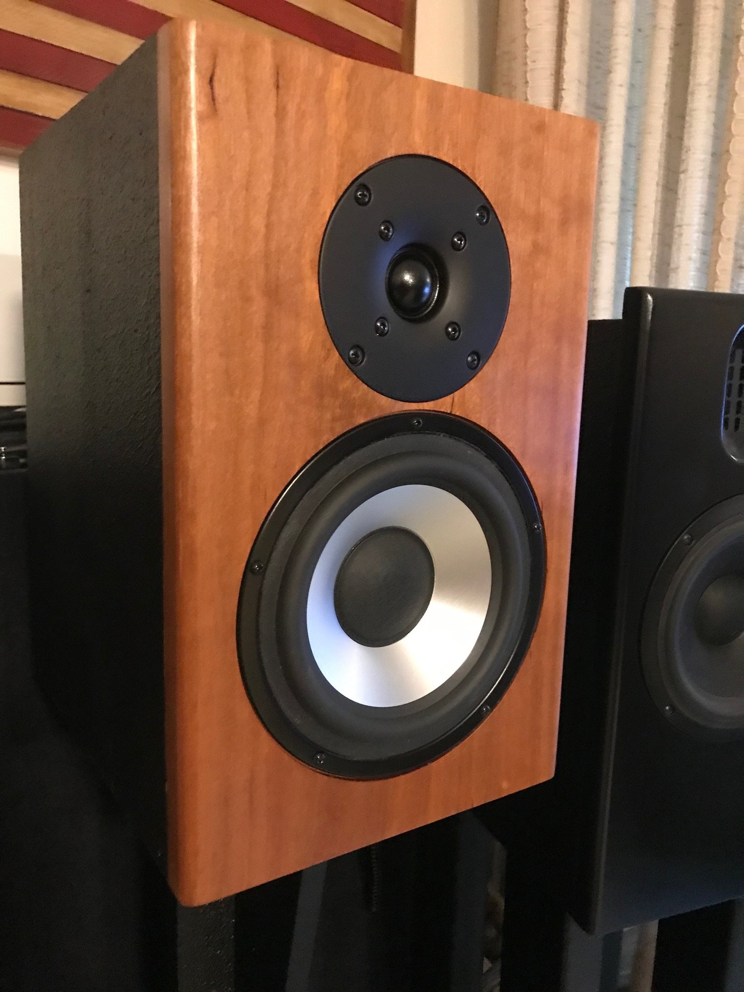

Thanks to Michael Chua for his Dove speaker design. I already had the DA175-8 and most of the XO components from earlier projects. They sound great! 3/4" plywood for the main box with a side-to-side oak brace and 1/2" felt lining. Front baffle is 3/4" solid cherry with a tung oil finish. Using a Magnavox 6BQ5 console amp is plenty loud for me.
