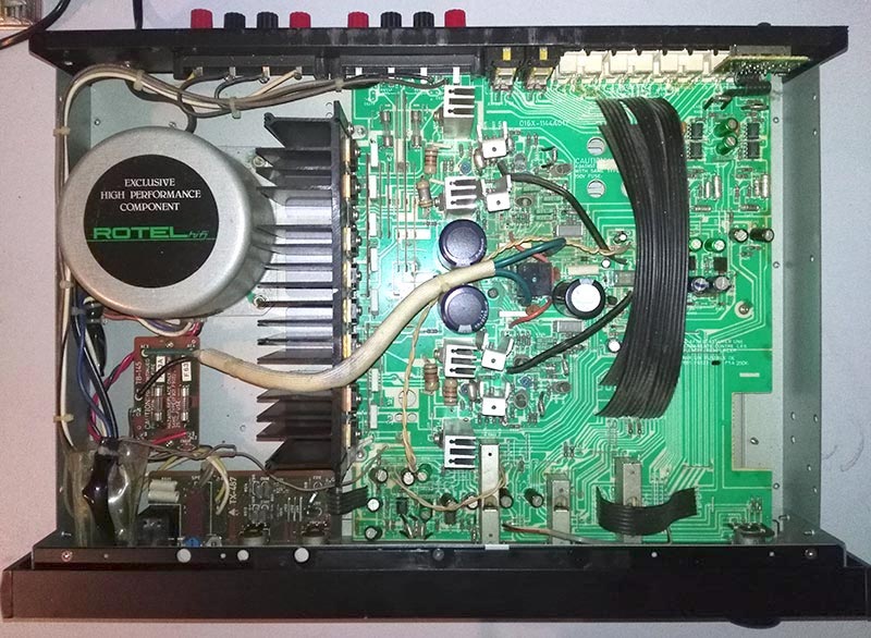

Hello everybody,
I could buy a rotel 840 BX4, I was curious to hear a Rotel from the glory years of the brand. It's a pretty good amp ! I was afraid of finding a tonal balance more on the trebbles, with a sound very detailed but on the harsh side. And in fact I found it well balanced, with deep bass (I have a Quad 405 recaped, it's a really a "lighter" sound) and a lot of air between the instruments...
I bought it in a good condition, but very dirty, the last owners didn't take very care of it. When I tested it, back to home, I loved the sound, but I found it pretty hot, too. I could hear that these amps are running in class A the first 5 watts, it can be an explanation, but I wasn't sure of that...
So, I read plendy of posts on diyaudio, and I realized that : ":superman: To adjust a bias on a Rotel Amplifier ? Nothing more simple !😉"
I had between 9 and 10 mV before on the 0,22 ohm resistors, now I have my 2,5 mV. And I had 41 mV, and 74mV DC on the speakers output, this is past now. I can't hear any difference on the sound. Shall I ? Perhaps a sound a very little more... Dynamic, I'm not sure. But I find it a little colder when working now. So, thank you diyaudio !
Perhaps 2 or 3 questions ?
- Is it right that these amplifiers works in A class for the first 5 watts ?
- I did my adjusments with a 3 digits multimeter, on the 200mV range. Not a professionnal gear... What can happen if I adjust a too low voltage on the 0,22 resistors ?
- I suppose I'll need soon to recap it, it was made in 1990-1991, nearly 30 years.. Does it make sense to put 2 bigger capacitors (from 8200uF to 12.000) in the PSU, or it will not make a significant change for the sound ?

Hi, thank you for this post. Perhaps you're right, but I have not the technical knowledge, and I just followed the indications on the service manual.
How warm did the heatsink get originally? If it's not anywhere near alarming, I'd adjust bias back up.
The first time I used this amplifier, when I put my hand on the cover I was surprised enough to get the reflex to take it off, to be not burn. Of course it was just a reflex, I was able to leave my hand on the cover, but it was hot enough to alarm me.
The service manual might just be wrong, wouldn't be the first time. That, or maybe someone has worked on the unit before.
Rotel service manual give often these kind of voltages to adjust a bias. This is 2,5 mV for the 820-BX3 (same design than mine), 5 mv for the 2x60watts RB-870, and 10 mv for the 2x120watts RB-980. So I wasn't surprised.

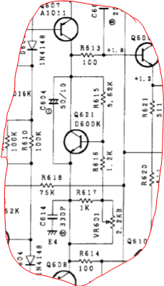

Usually referred to as a Vbe multiplier this is situated between the bases of the driver transistors to set the bias voltage.
It is usual to site the Vbe multiplier transistor on the same heat-sink as the output devices so any heating of the output transistors will affect the multiplier transistor. See attached
The heat on this transistor will cause it to conduct a little more current and the collector to emitter voltage will reduce.
There is somewhat of a time lag with Vbe multiplier transistors with regard to these sensing heat so it is in your interests that there is not too much variation in the heat-sink temperature.
If the service manual specifies 2.5 m.V. across the test points you would run with that. As indicated by PPR that will give a standing current of 11 m.V.

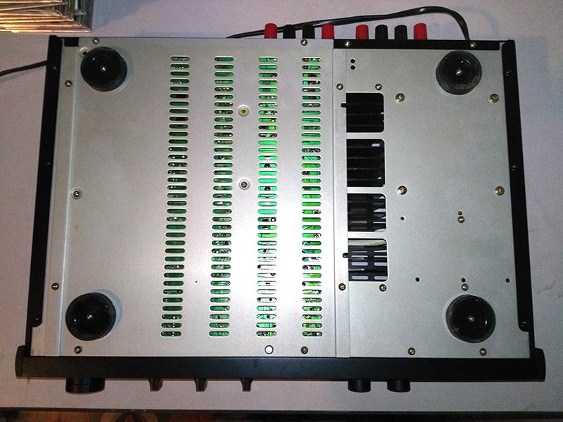

That would explain the skimpy bias levels then. This unit is quite low profile, so the heatsink basically is roughly half as big as it would be in a more conventionally tall unit - and there's 2 pairs of output transistors on top of that. At standard bias levels this thing would run much hotter!
Ventilation slots in the case look quite adequate too me... well, maybe there could be a few more in the bottom around the heatsink, but nothing dramatic. (Those into metalworking may be inclined to grab the tools and some mesh.)
However, the feet don't appear to be overly high, or does it just look like that? I would make sure that there is at least 2 cm of space below the unit, and 5-10 cm above.
It is unclear to me whether and where the heatsink is thermally coupled to the case, which would certainly help somewhat. I am presuming it sits on top of the bottom case. If it's already at ground potential (verify with multimeter), attaching it with some screws from below may not hurt, as well as making sure the lid is making good contact with it when closed (maybe stack some metal strips or something in between if necessary). Maybe the designers already thought of all of this, I don't know.

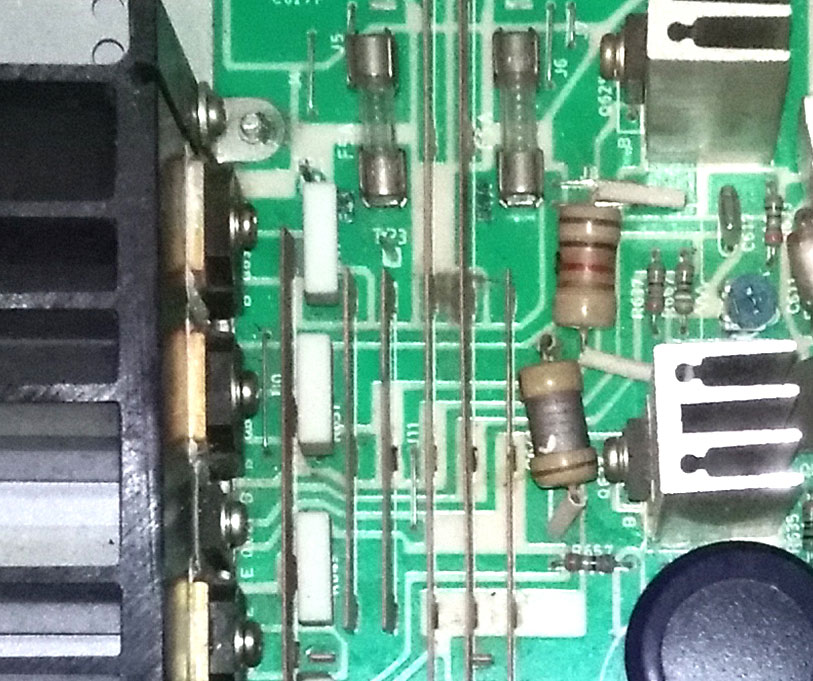

Also look at R641-644, these seem to be rather toasty-looking on a regular basis apparently.

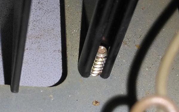

Well done... You saw it, there is nowhere 2cm under the amp, maximum 7-8 mm, the feet are really thin.
It looks like Rotel did their best with the size of the box... The heatsink is screw to the bottom plate (but without thermal between, it can be something to do), and there are large holes in the botton, all under the heatsink.
Thank you for this info. It looks like these big resistors (especially R641 on my amp) have suffered with heat

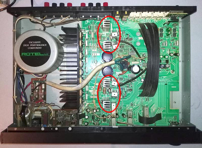

Looking at the image of your amplifier I see the driver transistors are mounted on individual heat sinks that look to have high enough thermal dissipation for the designed needs.
When stages like this run in Class A mode the current passed is constant and these will run warmer.
Designs where resistor cross coupling of driver emitters in one case and otherwise connecting these to the load do not run constant current and run cooler. There is a bit more latitude for bias adjustments there.
The Class A operation of the driver stage is a design aspect that should not be overlooked - I have seen threads where R641 and R643 have burned out.

I was about to write a post when I could read your, to give my feeling about that.
First, the drivers you're speaking about, if they are those marked in red on the pictures, produces the heat of the cover, and not the principal heatsink. I listen my amplifier at low volume (command at 9h), and these drivers are hot, not the power transistors.

- You're right about the resistors you spoke about, one of the four big in my amp (R641) lost its colour codes because of heat. But remember, when I got this amp and checked the bias for the first time, I found around 9,5 mV on both channels !

These resistors (R641-644) get toasty since they are 2 W parts having to dissipate 1.73 W all the time. That normally would've called for at least a 3 W part.

- I believe Pingrs, when he writes that for this amplifier, 3,5 mV is a verified ideal for the bias value.
- as sgrossklass wrote, the amp body is limited in size, and then in thermal dissipation. A bias reduced to 2,5 mv can be a preventive way to avoid excess of heat, and transistors destruction
- I think, about the design of the amplifier, that a possible upgrade is to put cones unter the existant feet : not really for the cones, but to increase the amp's height, and then the space under it, to upgrade air cooling. Larger dissipators would be usefull, too for these drivers.

But I repeat that, IMHO, more space under the body, and bigger radiadors on the drivers can bring something.
If the output emitter resistors are 0.22 Ohms and these conduct 11.6 m.A. - the current deduced by pngrs there is an error. From Ohms law Voltage= Resistance times Current.
Multiplying pngrs figures together 0.22*11.6/1000 = 25.5/1000 V. That is 25 m.V. and since the numbers 2 and 3 are adjacent on the top row of a keyboard 3.5 m.V. would seem to have been a typo. You would have to clarify that with him.
Anyway I consider it advisable to replace your emitter output resistors.
Carbon resistors can drift in value due to the heat environment they live in. In the TV repair trade in the days of valve/tube sets the term was "gone high". one of yours has darkened and had it's day - if it is working it could be adding noise.
When fitting replacement resistors make sure these stand tall with long leads to maximise the circulation of air around both the leads and the body. In your photo these are too close to the driver heat sinks and the pcb.
If you cut the old parts out close to the resistor bodies you can double the mass in the leads by strapping the remnant in the pcb to the replacement lead. You can do this by twisting a fine strand of tinned wire around the separate ends and solder the combination at those two points.
This is a method used by repair men which obviates the time and cost of disassembly and reassembly of the unit.
