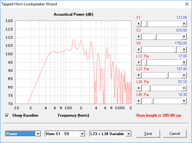

+1 same here but no cone volume data entered. While fooling I used 7000/860.50 from a 15 I think and although I lost a db at 50hz it brought low corner up to 96db @ 40hz... Me likey. Holding off sawdust until I find a <200l cab with 97db @ 40hz.
You could try rejigging the sim in HornResp, then using my THAM spreadsheet to work out the folding of the horn. Getting it at or above 97dB in a sim in HornResp with a cabinet that small is likely going to be a challenge however. This is the best I could do so far, using an SS15-type fold. I'm not even sure if it can be folded up into a horn and still keep the same sim parameters, LOL.

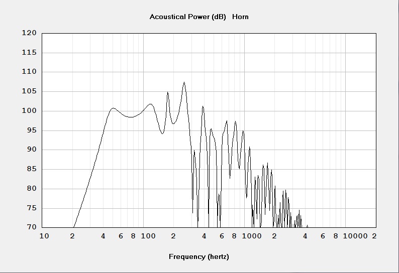

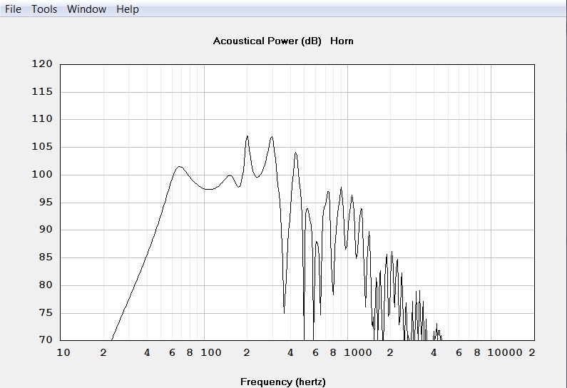

Here are the two output graph. Still try to figure out what makes such a huge difference between both. I suppose it's the lower BL.
One question: I built my tham with 15mm Baltic Birch. Do you think I could use the same thickness for the THAM 15 or should I stick with the original 18mm to avoid resonance?
tks
Sylvain
If you're comparing 4ohm with 8ohm I noticed that too, but not really sure why. I think the ply thickness aren't a huge concern as long as it properly braced but tend to look at 15mm as lighter duty/install and 18mm being a bit more road worthy.
