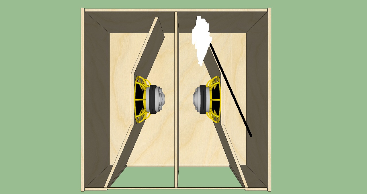

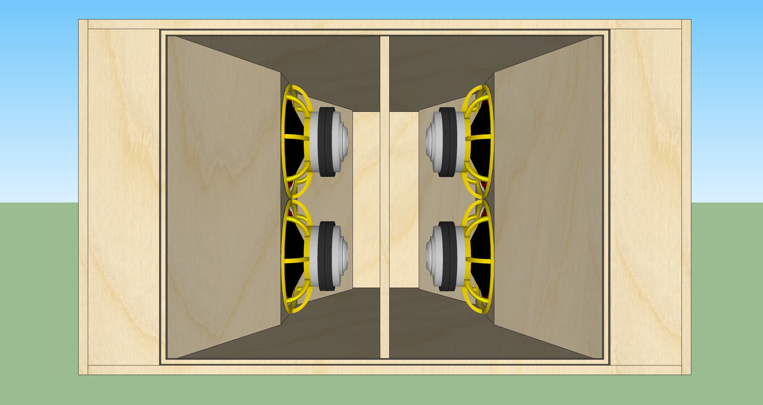

I've been exploring the TH412 lately and just fancied having a go at designing one. I've got as far as building the box and baffles but wouldn't know where to start with the horn folds...any ideas would be amazing! Also any tips on the box design so far would be appreciated.
I'll be using the Faital Pro 12HP1060's

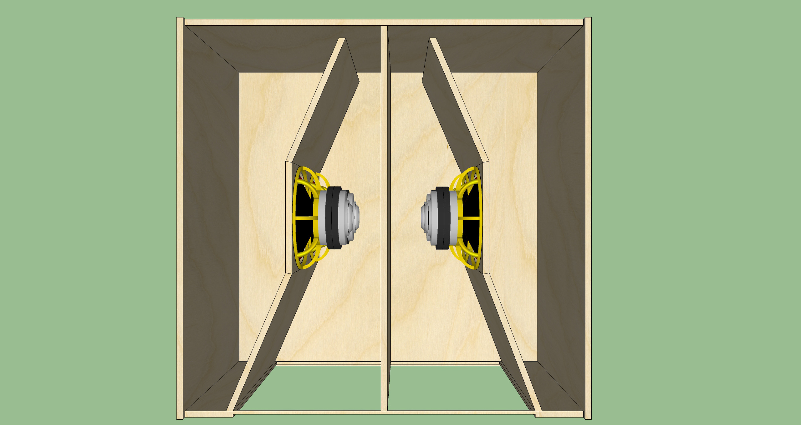

From this thread http://www.diyaudio.com/forums/subwoofers/268664-danley-th412-12lw1400.html and your sketch I suspect the fold is something like this, but angles and whatnot will need to be reworked... In order to enter HR data, measurements need to be posted.

Thanks Zwiller! so basically shortening the top piece and extended it from the bottom instead?
