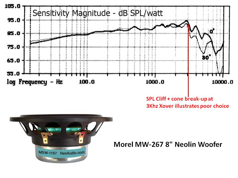

All monopole Tetra speakers are ported 2-way. The "top models" like the 505 & 506 use the discontinued 8" MW-267 Morel NeoLin, Neodymium Damped Polymer Composite midbass crossed at 3Khz to a 1" Scan Speak, Treated Fabric tweeter. Based upon the slanted baffle for tweeter-midbass time alignment, I would guess that the crossover goal is 2nd order transient perfect response. The triangle shaped main baffle would have the edge diffraction spread over a wide frequency range, and also shape the polar response.

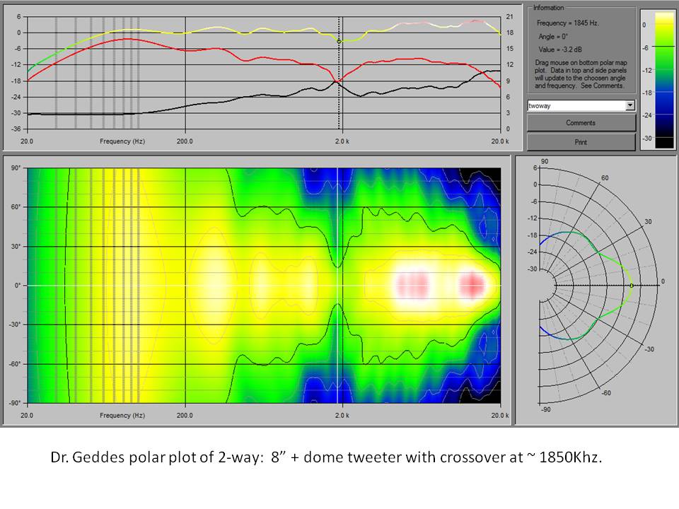

I would never cross an 8" midbass much higher than 1400Hz due to beaming/lobing, lack of directivity control, and cone breakup.(graph: 8" crossed at 1850Hz to 1" dome) (Morel MW 267 data)

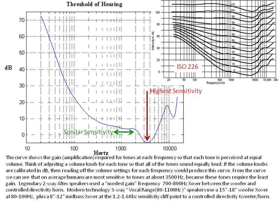

Engineers studying the ISO226 data might consider Xovers ~ 3Khz-4Khz as the Danger Zone because of our increase in hearing sensitivity. Cone break-up in this range triggers our genetic "crying baby" brain-anxiety.
Tetra top model 505 and 506 speakers put an interesting 8" full'ish range Morel speaker in a large ported box to extend bass response, and gently(2nd order) bring in a 1" dome tweeter at 3Khz where the Morel SPL starts to rapidly drop and the cone craps-out. Tetra engineers appear to favor the coherence from one 8" speaker covering 40Hz - 3Khz, and accept the sins of lobing, poor polar directivity control, irregular SPL, and cone break-up distortion.
