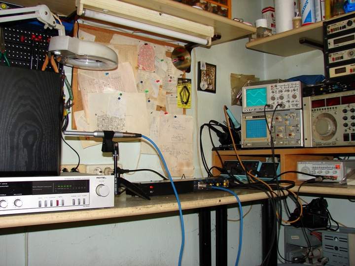

test microphone setup
Nobody can deny that

Here is the correct way to do speaker testing
Photo by fotios our man in Greece (Hellas)
