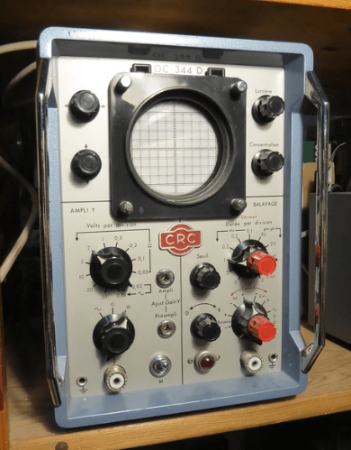

That's why in that case I still rely on my 1964 CRC OC344D single beam all tubes oscilloscope :
A French Navy surplus oscilloscope, which offer 50 volts per division, that is to say 400V peak-to-peak on the whole screen... A super fine trace, thanks to its 2kV post-acceleration.
