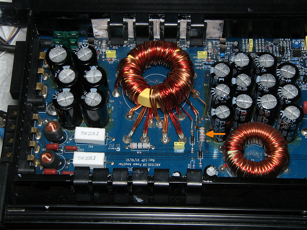

I recently got an Arc Audio 1500DR with the TA0102A tripath chip in it, The previous owner said the chip was burned out.
How do i go about testing these types of chips?

The green LED will blink rapidly , From what ive read they throw error codes when they fault, I cannot find a list though.
No excessive current or dc on terminals.

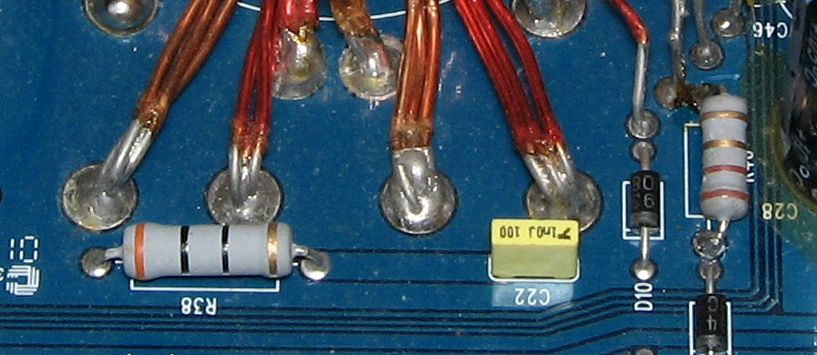

It's possible that the 1.1 ohm resistor in this amp (photo) isn't the original but I think the resistor is supposed to be 1 or 1.1 ohms. In the photo, you can see that the colors are pretty accurate and the resistor at the left with the orange band is clearly different than the brown bands. At 3.3, it's unlikely to cause a problem but you may want to replace it.

No, especially if the solder connections on it look original. I'm not 100% sure that the one in the arc amp was the original but I've had at least one other person with a 1.1 ohm in their amp. If I'm not mistaken, this supplies 12v to pin 19 on the Tripath module. If you have 12v there, this isn't an issue.

I Somehow missed a burned up resistor
R34 is the location
I can only see the first ring is green and the last ring is gold, Its a 1/4watt
It reads 3.8ohms
R34 is the location
It reads 3.8ohms
Its the red circle
