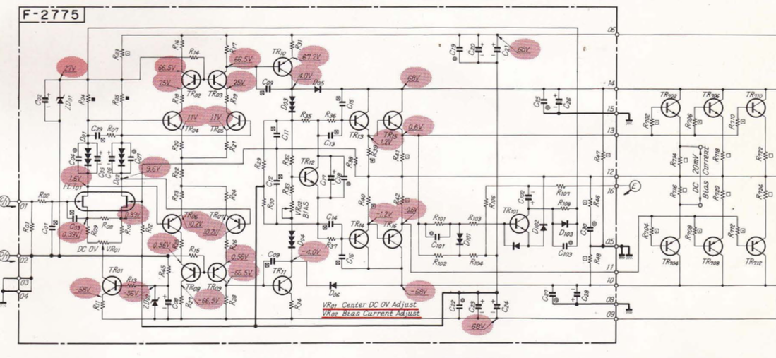

Hi Ian - yes I did start by taking measurements with the 2SK97 in circuit. However voltages around them and the first few transistor were quite far off what they were meant to be. All semis' test OK so I thought the remaining issue could be the FET. For example - I am meant to get these measurements in circuit:
Measurement between ground and both sources is meant to be 0.39v, Im actually getting 1.15v. Measurement between ground and drain is meant to be 1.6v, but Im getting 8v. This of doesnt mean the FET is bung, but it could do, so it would be nice to eliminate it if poss. The main problem is that I never had a good working point of reference in this amplifier to start with unfortunately.....
Argh, this amplifier is complex. Please see relevant sections of schema attached. Cheers!

In your other thread I posted the ltspice sim of this design. I have tried a number of different jfet that I have libs for, 2sk117,2sk170,lsk170A(B),J310, they all seem to work.
If you look at D02 they wrote 9.6V which is correct, it is to be the same as D01, it has to be, it is a balanced diff pair, they must be the same or it is out of wack.
I do not think that 1.15 Vsource is wrong, it is probably a jfet with slightly higher Idss, with a J310 I am getting 2.45V
Sansui is throwing you a curve, it is a mistake.Measurement between ground and drain is meant to be 1.6v, but Im getting 8v.

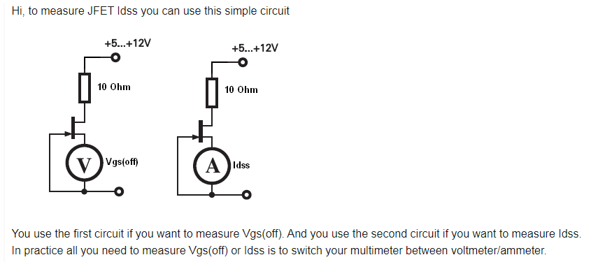

In the meantime I tried to measure the VGS (off) and Idss on both sides of the 2sk97 and got between 1.8-3mV on both sides, and absolutely no reading in mA on either side.....
I have never used that method to measure Idss. I know you want Vgs to be 0. You should measure Rds simply with the ohmmeter across D/S.and absolutely no reading in mA on either side.....
Take a look at this test method
Simple circuit lets you characterize JFETs | EDN
Also
https://www.mikrocontroller.net/attachment/82476/Siliconix_AN73-7_prt.pdf
