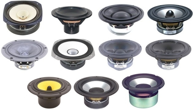

I rounded up everything I had in the house last week and did some tests. It's a wide variety of drivers.
6.5" to 7" Driver Comparison
Nice work Zaph. I'm sure happy I chose the L15s for my first project. THose alu Seas drivers sure seem to have hit a perfect price/performance ratio, and leaning towards performance!

awesome stuff, truely useful - however a few possible improvements if i may?
pdf links to each driver would be nice, along with each driver in the photo with its model number beside it would be extremely useful - id round up the links for you myself, but being stuck on 'internet excuse' connection at the moment (56k) its rather painful opening pdfs...
A bit more work, i realise - but could be really handy (same with the tweeter tests) - hope it doesnt seem like im not appreciative, I truely am!

Nope, can't say I have. I generally don't feel a need to test drivers that have been extensively tested by others. I trust other people's measurements, and if Linkwitz says the PL18 performs poorly, I believe him. I think Mark K tested the PL18 too, and for some reason I suspect the M18 would only perform worse. I mentioned in my blog, this is just what I have in the house at the moment. (unfortunate - nobody should have as many drivers laying around as me. Or so my wife says. 🙂 )
Etacovda said:awesome stuff, truely useful - however a few possible improvements if i may?
Hold on right there. My burst of energy and excitement has disipated, and I've already completely lost interest in this test. Not to mention I'm out of time and have to get other things done, like this waveguide TMM I'm working on. 😀

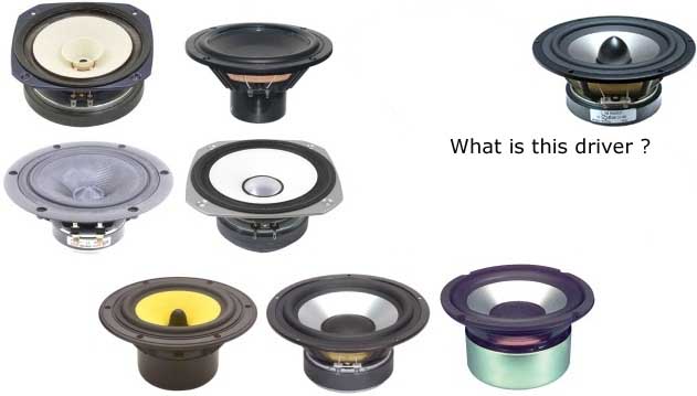

DcibeL said:That is the Seas L18.
OHH me like that driver.. wonder how it mesured ?
Joined 2002
All the detail is there...?
