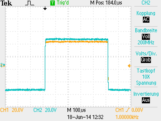

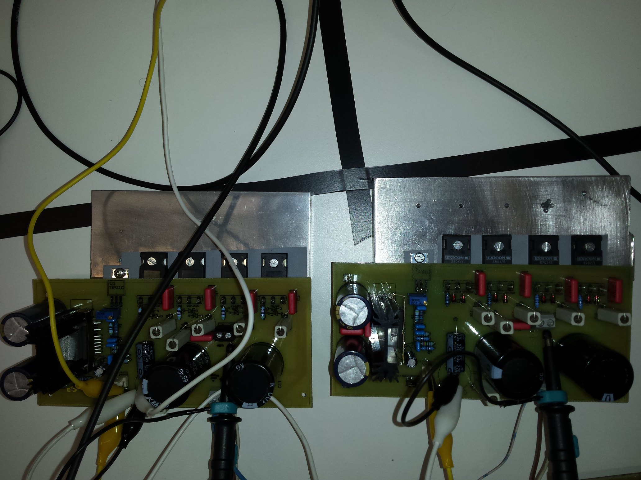

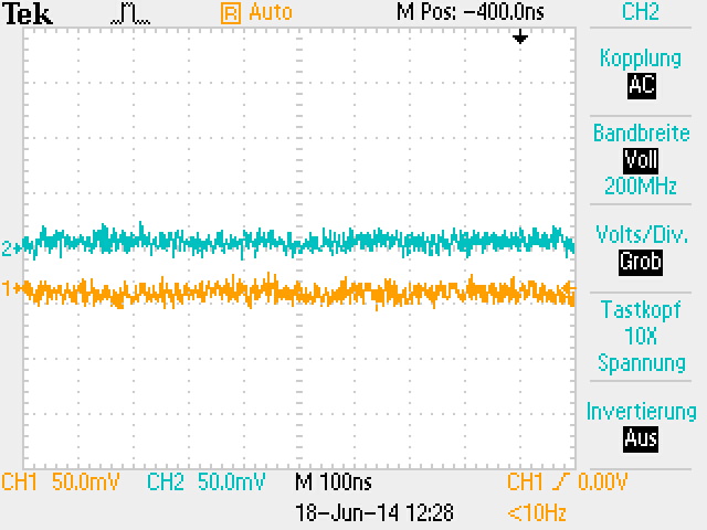

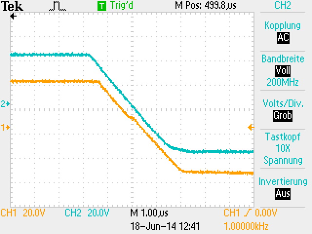

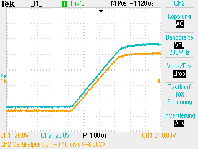

Hi folks,
I did some measurements between IRFP9240 / IRFP240 and ECX10P20R / ECX10N20R MosFET.
The Layout of the IRFP board is capable to use Toshiba MosFETS. So I left space to add diodes between Source and Gate. Don't be irritated if you see the pictures. Note, IRFP MosFETs do not need such diodes.
The ECX MosFETs have a different PIN-Layout, this is the only change between both boards. Feel free to use an distribute it.
I also add the power supply unit. They have 2.5mV AC, it is quite good .
I drove both boards with a -50V +50V rail voltage. So you have 100V, so be careful. From the TI recommendations, you should not go higher then -60V +60V. There are some thermal aspects that have to be consider by higher voltage, like active cooling.
cya
Phil

Hi folks,
Sorry what I forgot to mention, the yellow line on the TEK is the IRFP board the blue line the ECX board.
cya
Phil
