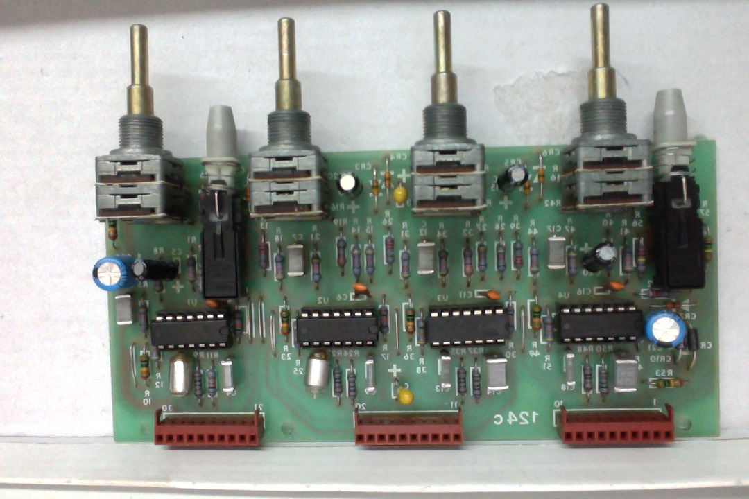

Hi guys, thanks for the help.
I can power up the mixing board. It's a large studio AMEK mixing board with an external power suply unit.
The channels are detachable from the board, i have to take them out to look (or measure) the components.
Normally this type of desk comes with and extension cord, so that you can power the Ch. of the board and do maintenance, but i dont have one.
I'm doing resistance test and voltage drop test (diode test).
I managed to find a diode that was 200mv off, i changed it but the Equalization section of that ch still does not work.
I'm posting a picture of the EQ. section.
I'm shure the problem is in the eq section cuz I changed this section with one from another Ch, the problem migrated (the ch that was working OK stoped having eq, the ch that had the eq busted started to work properly)

That doesn't look to scary 🙂
Its always nice to fault find properly by measurement but just looking at the PCB the stand out and perhaps more obscure failure items would be the two tantalum capacitors and the ceramic caps. Other things to check first though.
The two blue electroylitic caps look as though they could be rail decoupling. Try and confirm if they go to the power pins of the IC's. There are two ? diodes at the right hand side next to one of these caps. Always worth a check as they are a typical failure item. There are a handful of small signal diodes scattered around. Again always worth a check for leakage. Without a circuit I wouldn't like to say what these do. They could be related to the PSU or some on/off thump suppression. You would have to check them out of circuit (just lift one end) for leakage.
The resistors and the poly caps almost certainly OK. That just leaves physical damage such as a broken track.
If you can determine the PSU connections then powering this up with two 9 volt batteries is a real possibility and would allow you to compare the good and bad PCB's.
I'm assuming it does run on dual (split) supplies going of the two blue electros but you need to be sure. See where the IC power pins go.

R1 looks a bit discolored.
Also, I don't think I ever run across caps that look like those, eg C17, C7, C14. They look like SMT with radial leads added on.

They are polyester film box capacitors 🙂
Hey guys.
I fixed the problem, it was one of the polyester capacitors "C17, C7, C14..."
Cheers for the help.
Just one quick question, when you guys need to check a cap, do you cut one of the legs from the board or do you unsolder them?
I measure them with a analog multimeter, is it a full proof test?

That's great you have fixed it. Well done 🙂
I'm really surprised it was a polycap that was duff but yes, testing on an analogue meter on a high ohms range usually shows leakage particularly if its like an old AVO that uses a 15 volt battery. I would always just try and desolder one end with braid providing that's possible... single sided PCB, component legs not twisted and embeded in the PCB etc. No test with any meter can determine fully if the cap is good though, although most cap problems on non electros are leakage related.
