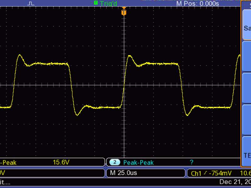

Attached is a picture of my latest creation measured without output coil (which will be added).
With 8 ohm/1uF and a outputcoil, a small resonanse that quickly dies may be visible on some amps (not here)
Besides this, you also need to apply a 1-10kHz sinus and check at the collector/drain of all the transistors in the amp, to make sure that they do not osciallate themselves.
If they do you must add compensation-caps in the circuit.

maybe you're missing some EE assumptions:
a simple "eyeball" stability test for some feedback amplifiers is to look at the square wave/step response overshoot and ringing - with a sqauare wave that has frequency components up to and beyond the amplifier closed loop bandwidth
to apply this to audio PA you may need to bypass input filters, should really be looking at the output stage response "inside" any load isolating series Z
this is not "academic" - if all the conditions for its validity are met the step response does give a practical indication of amplifier stability margin
