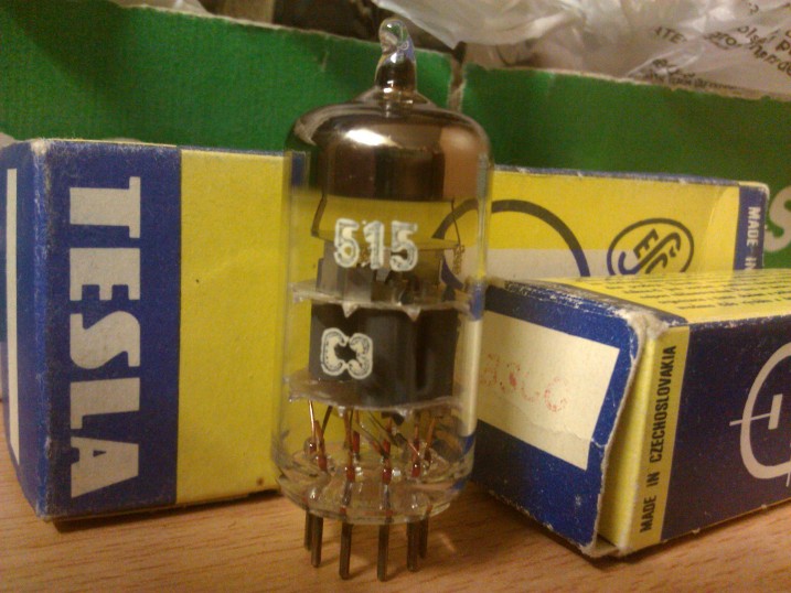

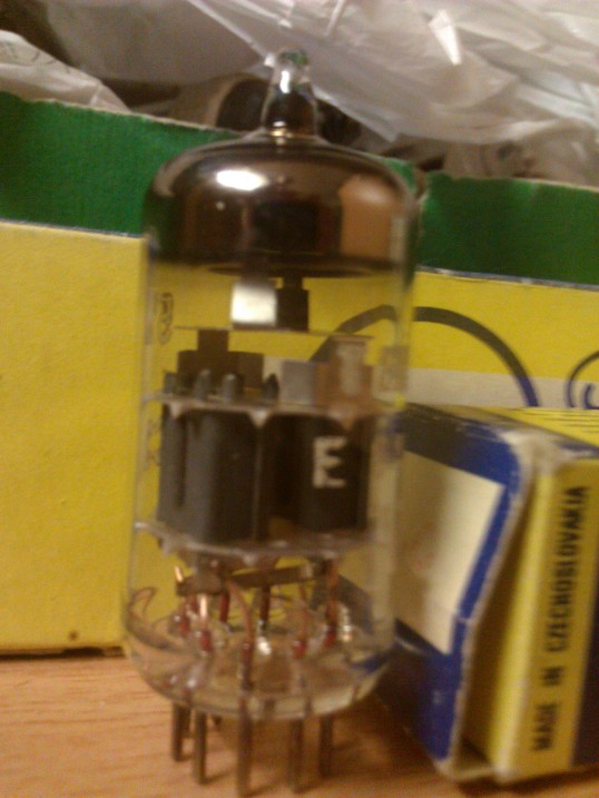

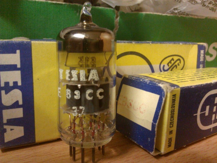

I have a Tesla E83CC somewhere. If I can find it I will take some pictures. I got it somewhere in the 90s and it worked well in my guitar amps 😎
Tesla E83CC
Found it 🙂
I took some quick pictures with my phone, so sorry about the focus or lack thereof.
The most notable is the flattened top. JJ production has a rounder shape.
