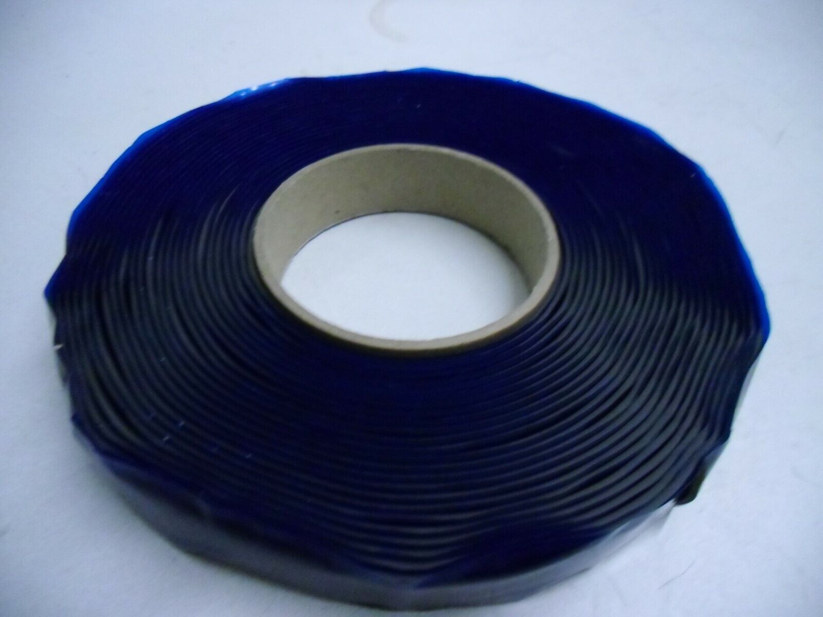

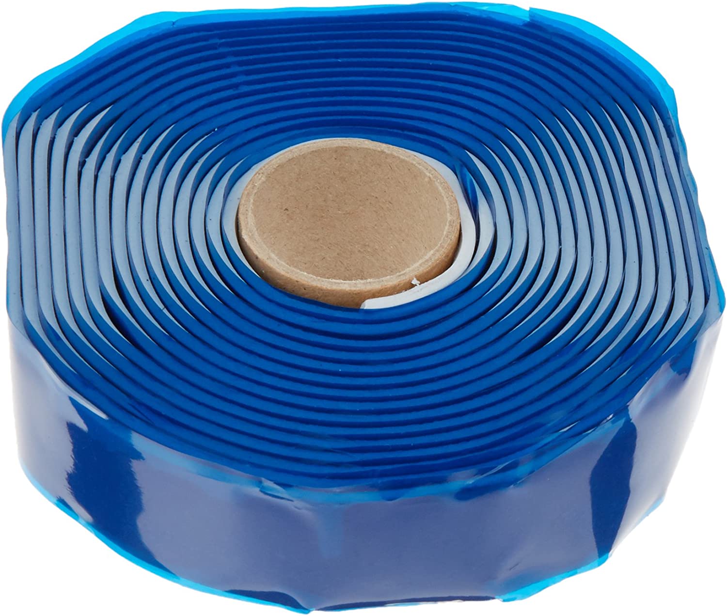

Hello,
what is the right englisch term for the parts from the attached images (brand: TEROSON) and those under
https://www.hofmei.de/e/product/150307?emcs0=PD - Kunden kauften auch&emcs1=PD&emcs2=na&emcs3=150307#&gid=1&pid=1
This is excellent suitable for fixing lenses of laser heads (Pioneer cd player) and seal up drivers/transducers in loudspeaker cabinets.
Thanks for an advice.
The correct term is as follow:
permanently plastic profiled sealing tape - synthetic rubber
(figured out with the help of post #2) description in detail under
https://webshop.fiat500126.com/en/e...ts/others/sealing-band-terostat-vii-per-meter
and
https://de.rubix.com/de/terostat-ii-20x2mm-40-mtr-in-4-rollen/p-G1353000224

Thank you very much.
under
there are to find the correct terms:
Body Repair – Seam sealing: permanently plastic profiled sealing tape. Synthetic rubber.
TEROSON RB VII is a solvent-free, permanently plastic profiled, multi-purpose round sealing cord based on synthetic rubber. The cord is used for spacing and in-between sealing of metal, wood or plastic parts, for applications such as sealing of overlapping joints and rear lamp housings. It also protects against corrosion between steel and non-ferrous metals and serves as a vibration damper. The product adheres to most surfaces.
Benefits:
Very good water and ageing resistance
Protection against contact corrosion between steel and nonferrous metals
Dismantling parts without destroying them
