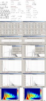

Do you have more TS spec data?
Looks like each driver only needs 1ft^3 for a Qtc of .505 but without Xmax i can't say much more.
..You really need to measure your drivers as documented T/S for these is not consistent;Foster-AR12_T-TQWT: b🙂
T/S are consistent 😱😀iscard the picture in the post here-above,😱By a mistake wrong Sd was entered:

Bjorno,
Took me a while to figure out how to view that .jpg bigger, but I saved it to disk and even Windows picture and fax viewer let me enlarge it and scroll around in it.
Now I've got to digest it. I do have the rest of the T/S parameters, these were just htose most immeidately relevant to a sealed box.
