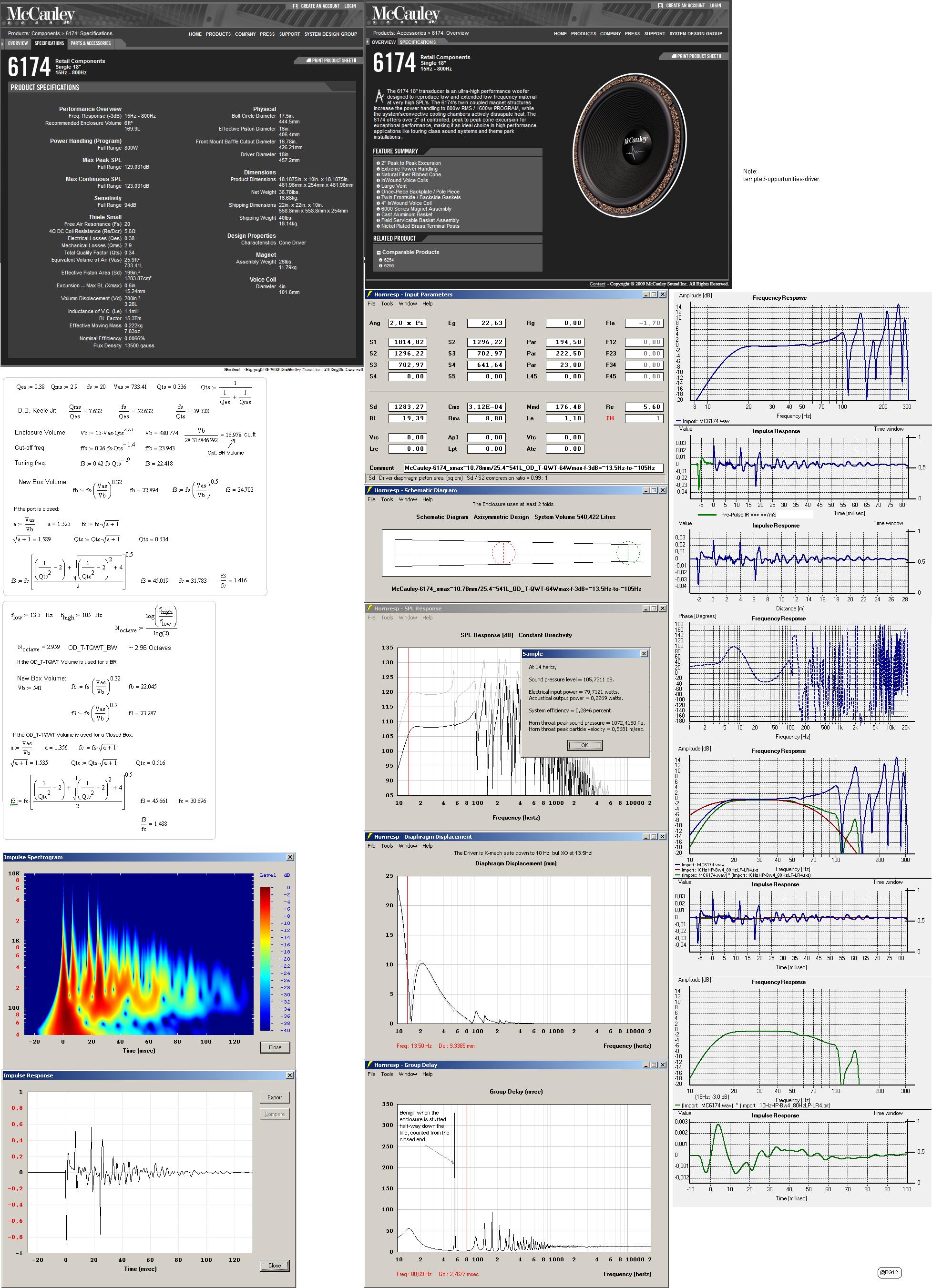

30Hz tuning in a 150L box looks very usable. Though I'd go for 25Hz.
Will give you very near a quasi first order roll-of down to 20Hz.

I need to buy a fresh set of tools, measuring and modeling stuff. Its been a good decade since I was active, and I wasn't deep in the technical side then, more a I like this, like that, want to try this etc. One of the guys whose opinion I respected a lot had a single McCauley 18 and claimed there was nothing better. I suspect it was the 6174 the low end monster fs 20 and 2 inch excursion.
Something like that I am sure. I will be looking at whats around and who has a bundle that does all I want.

.. 2 inch excursion..
Hi Mike,
😱I don't think you at any time should count with 2 inch excursion for the the 6174.
b🙂
Xmax is .6, but it says ...
2" Peak to Peak Excursion
I figure if one of them is moving even close to an inch, distortion from the driver may not be the principle concern.
