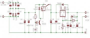

I'm still designing the PSU for the CDPRO2 drive and I'm trying to deal with the power's delay between the +5V and the +9V.
I've noticed that the mechanics (+9V) should be powered after the servo (+5V) of the CDPRO2M, a delay close to 150ms.
How did you deal with that ?

Hi all,
Well, taking into account the price of the CDPRO2 unit, I won't bypass the daisylaser recommandations regarding the power up delay 🙄
by the way, I will use a relay linked to a transistor, zener and cap to perform the 150ms delay as shown in this schematic.
Regards
Regards
ZERS said:Hi all,
Regards
