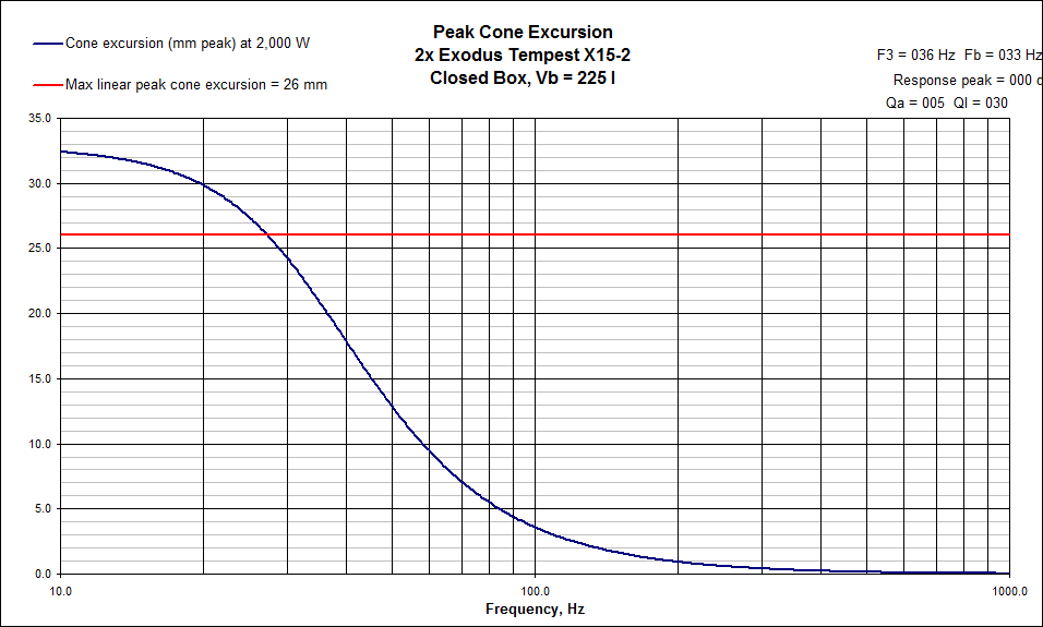

However, another forum member has modeled it as follows, and this one looks far less inspiring...
Given that I am a rank amateur, and that is one of the reasons why I am opting for a sealed sub, what should I believe?
Another question... can I put discrete L and R subs, powered of course by discrete amps, in the same box? Almost all of the signals coming to each driver are going to be identical anyway. Or do I have to make it a dual driver mono sub? The former is easier for my to accomplish because I intend to buy two Behringer Inuke NU6000DSP amplifiers, one to power each side. It will take care of sub/mains crossover duties, as well as provide me with aboundant tone shaping possibilities

The chart you have for the second one is driver excursion, not frequency response.
I am aware of it... not sure if I'm interpreting it right, though... The excursion seems to be exceeding the driver's limitations below 30 Hz, and the f3 is @ 36 Hz, with 2000 watts of power...? I was hoping for an in-room f3 of around 20 Hz..., without equalization, as per the attached documentation from the manufacturer...

The excursion plot is most likely a 2pi space one, i.e. if the speaker was sitting on the ground in a large flat field, so in room there will be some LF boost like one gets in a car, only not as much and since yours will theoretically begin in earnest around ~565 ft/16.67 ft = ~34 Hz, this sealed alignment should work well all the way down as far as you’re likely to need without exceeding Xmax unless your room is much more lossy than your drawing implies.
