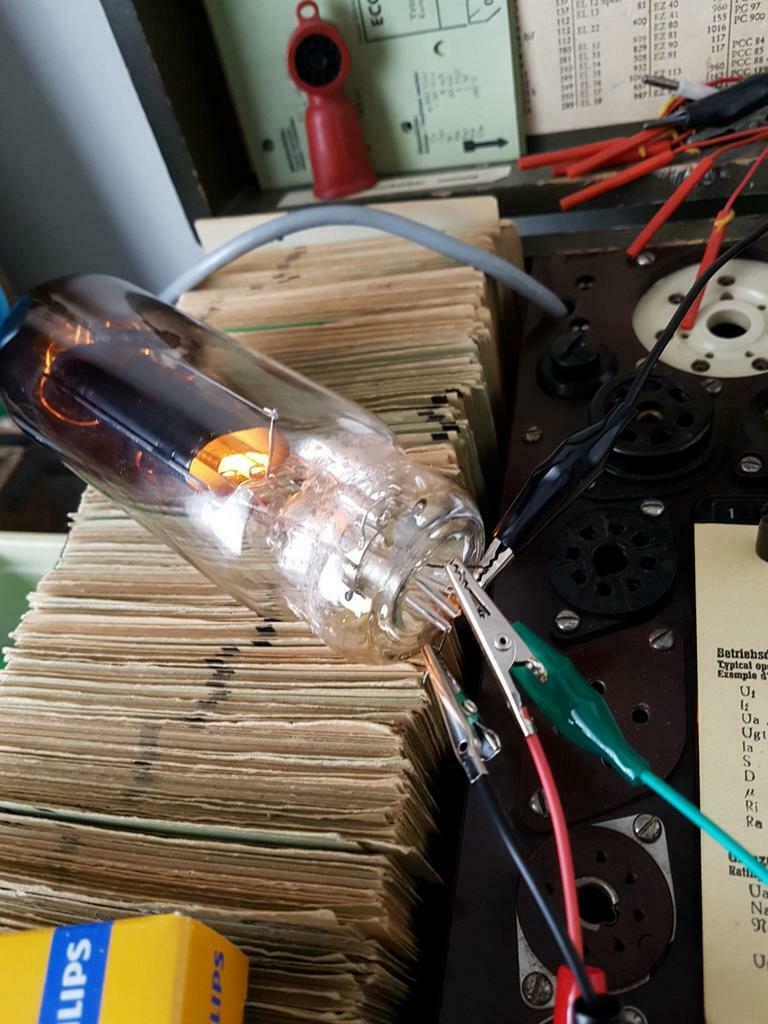

I just got a pair of these RV218 III Telefunkens.
Now the RV218, RV238, RV258 base is female (while all other tubes I know on this small planet are male).
Is there a socket for that or do I have to make one with wires and bananas and clamp the tube? Not that replaceable.

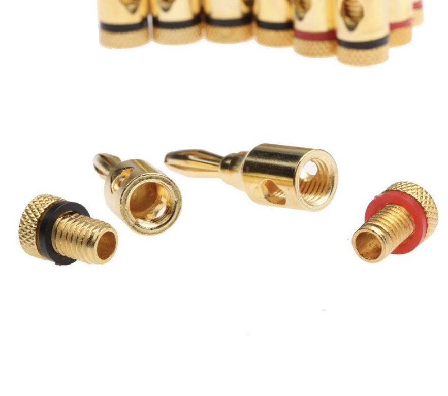

Yes, 4 mm banana plugs will fit into the socket connectors. Use only the metal innards of four high quality plugs, arrange them at the edges of a kite of proper dimensions, and fix them on a sheet of heat resistive insulation material, such as phenolic board or similar.

Thanks,
so my plans are: insert the plugs, attach then on the back to a sheet of phenolic with screws on the copper side, attach the phenol plate to the chassis.
And yes, one tube has the asbestos weave sticking out. it is the same type of asbestos fibres I had in heaters for lab glass when I was at college. It is brittle. Better not get it to mecome dust and fly around. The man who had owned them was a director at Philips tube factories, and actually got lung cancer. . . 😱
Does the base get hotter than a standard 300B? I have the 300B at 360V/72mA and the base and globe are not that hot; the RV218 should be 'cooler' at 360V because I will go for something like 40-50mA.

The better 4 mm bananas, e.g. those from Hirschmann, have threaded back ends to screw the isolating sleeve onto. The threads are standard metric M5. So you might want to cut threads into the (phenolic) boards, screw the naked plugs in and terminate by use the small screws.

I have thought about these:
They have a back end screw that I can use to attach it to a piece of phenolic plate.
The front side is like the 'chinese nakamichi plugs' that I have. They are attached on the front to the main hose of the plug, not sliding.

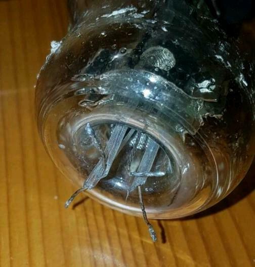

And what does an RV218 look like underneath that 1920's socket, that pre-UX4 bayonet?
Here with an RV258 with the same foot, this is what some guy did: dissect the tube foot.
And then it is like Humpty Dumpty, nothing could be put together again
This one is for sale in this very bad shape in a Dutch classified site, for $ 65 right now. Taking away the bottom took away 80% of the value

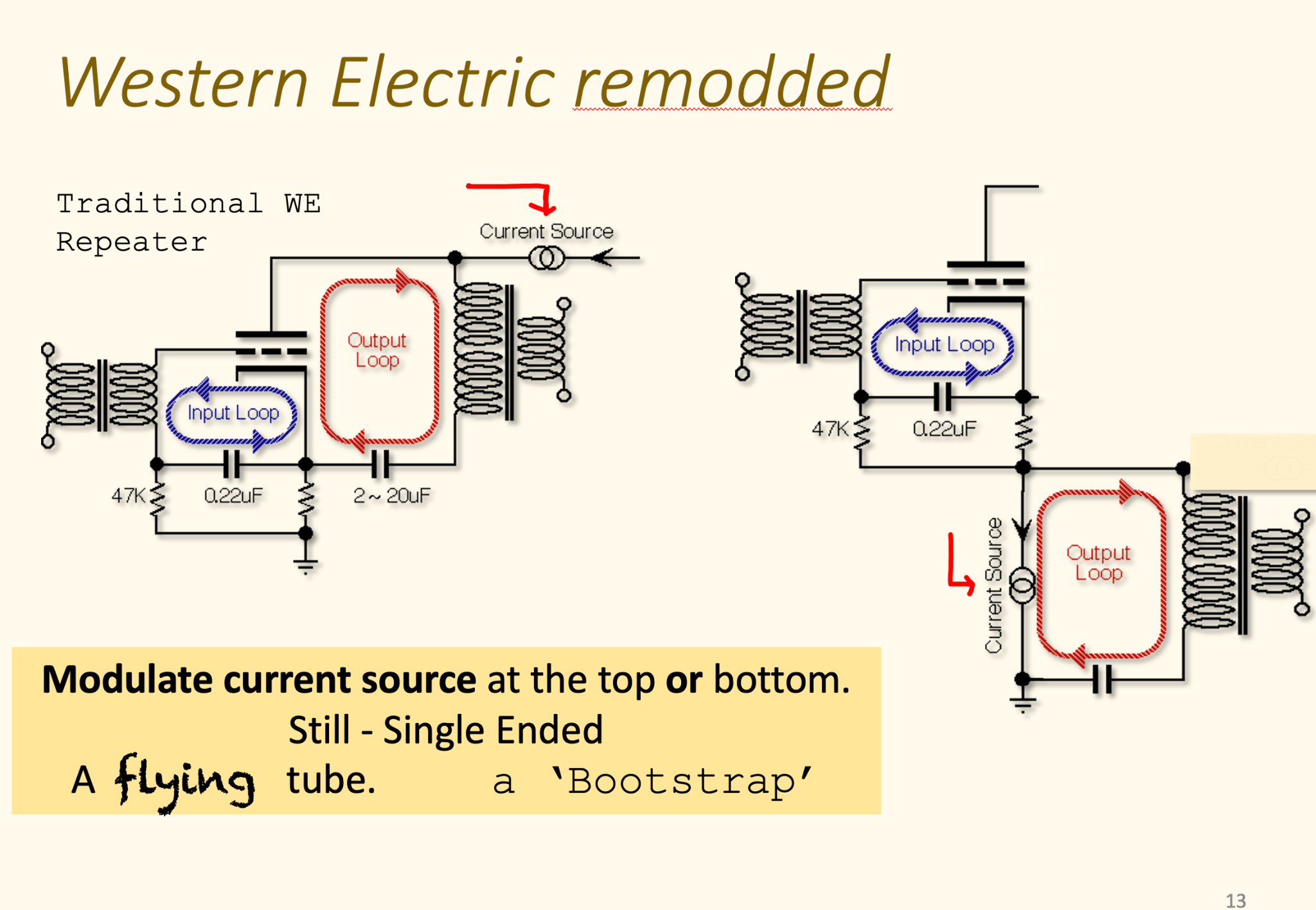

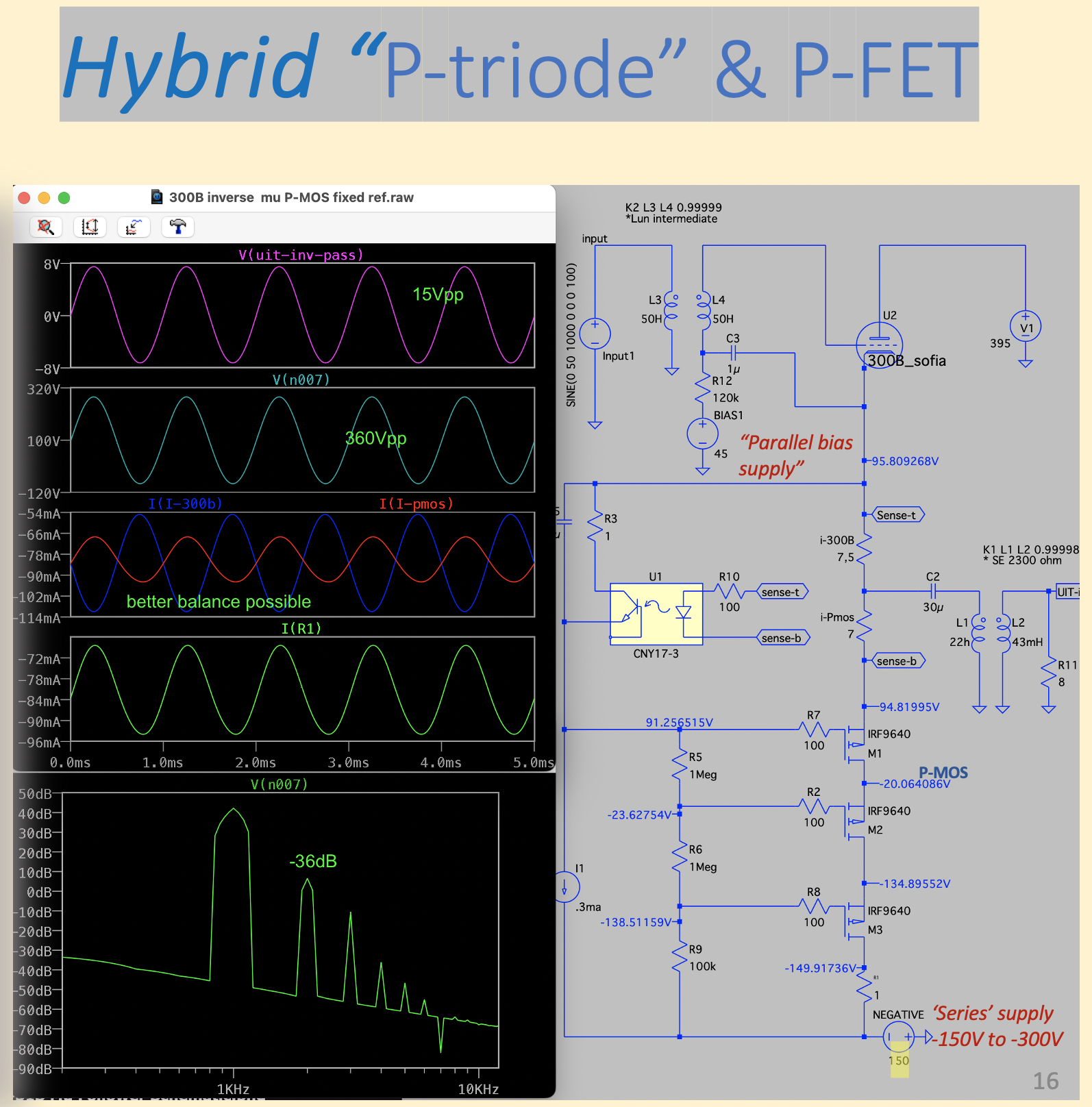

I still don't have the proper output transformers. A pity. I now have 'Maggies'. Changes all plans a lot.
These were my latest incarnations to use them just in another way . .
Pondering on how to use 'single ended' in another way. By CCS/choke loading like Western Electric hsowed us to do it.
Or by going along the path shown by Nelson Pass.
Whatever the solution, a large negative can be easily made (the transformers intended fot a tube rectifier can be used also for negative). A very large positive is harder (riskier).
