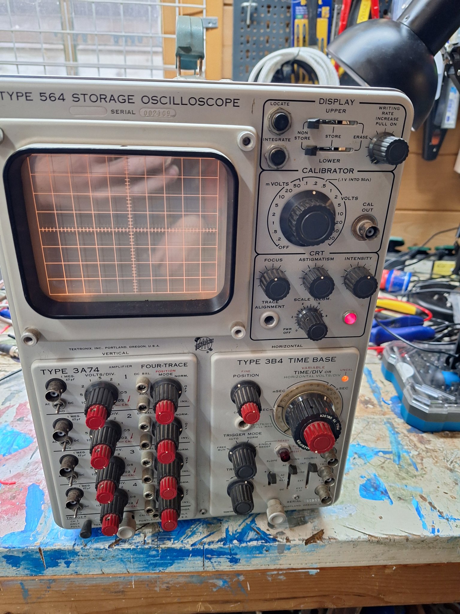

I recently acquired a used tektronix type 564 oscilloscope. I'm starting my electrical engineering course after the summer break and I wanted a oscilloscope that I could use at home (and which I could easily service).
The issue is that I do not want to spend too much money because I dont have a lot replacing almost every part inside the oscilloscope, only the defective ones.
So the tube oscilloscope's voltage rails sag a lot when both plugins are in the oscilloscope (Vertical 3A74 and horizontal 3B4). But when I plug each of them in individually the oscilloscope's voltages are fine. Furthermore with both of them in the OG3 neon regulator tube does not loght up as compared to them being in in the machine seperatly.
What also is a weird thing is that the neon bulbs between G1 and the cathode of the CRT light up when there is 1 plugin inside it (and also when theres none).

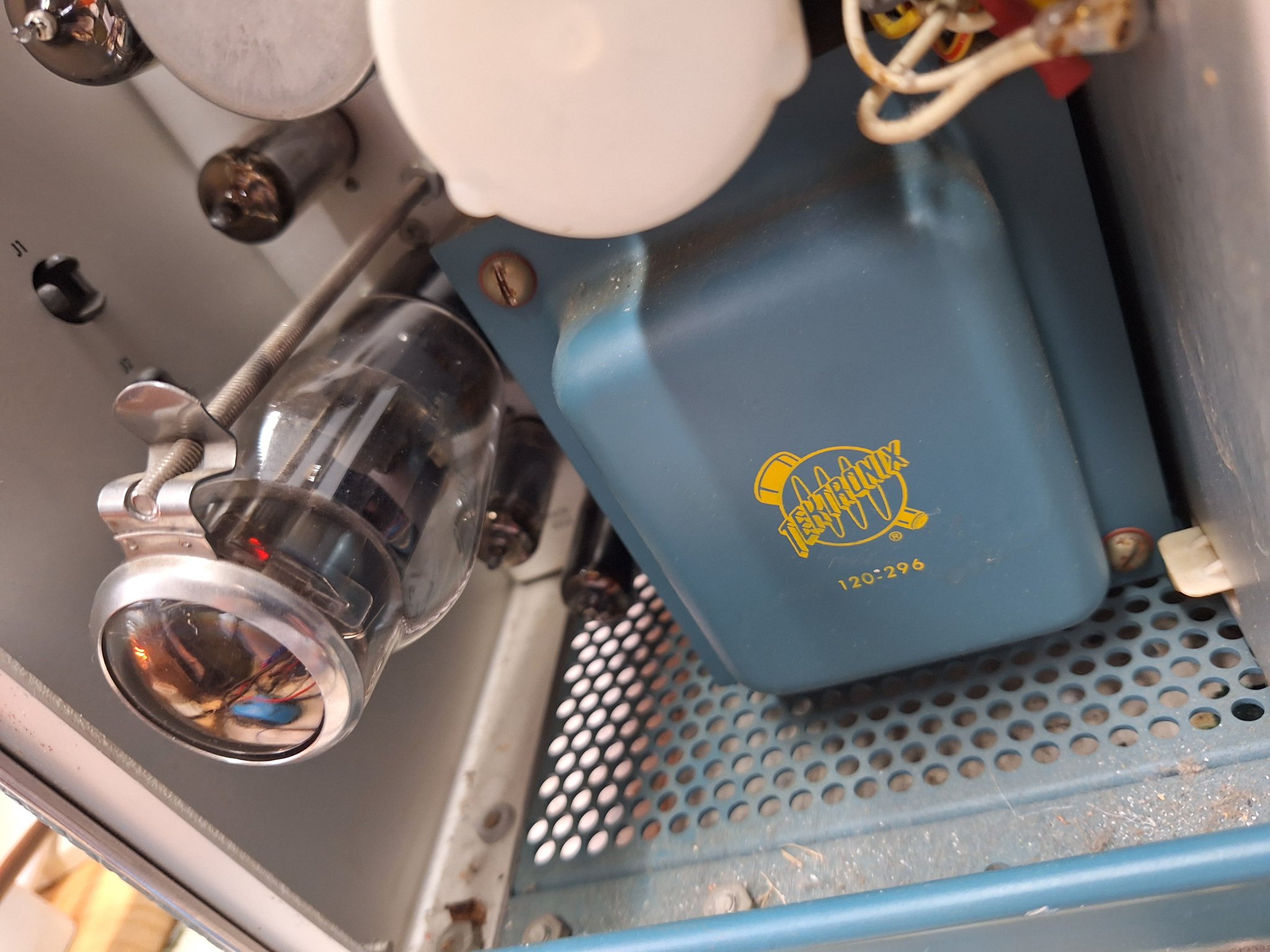

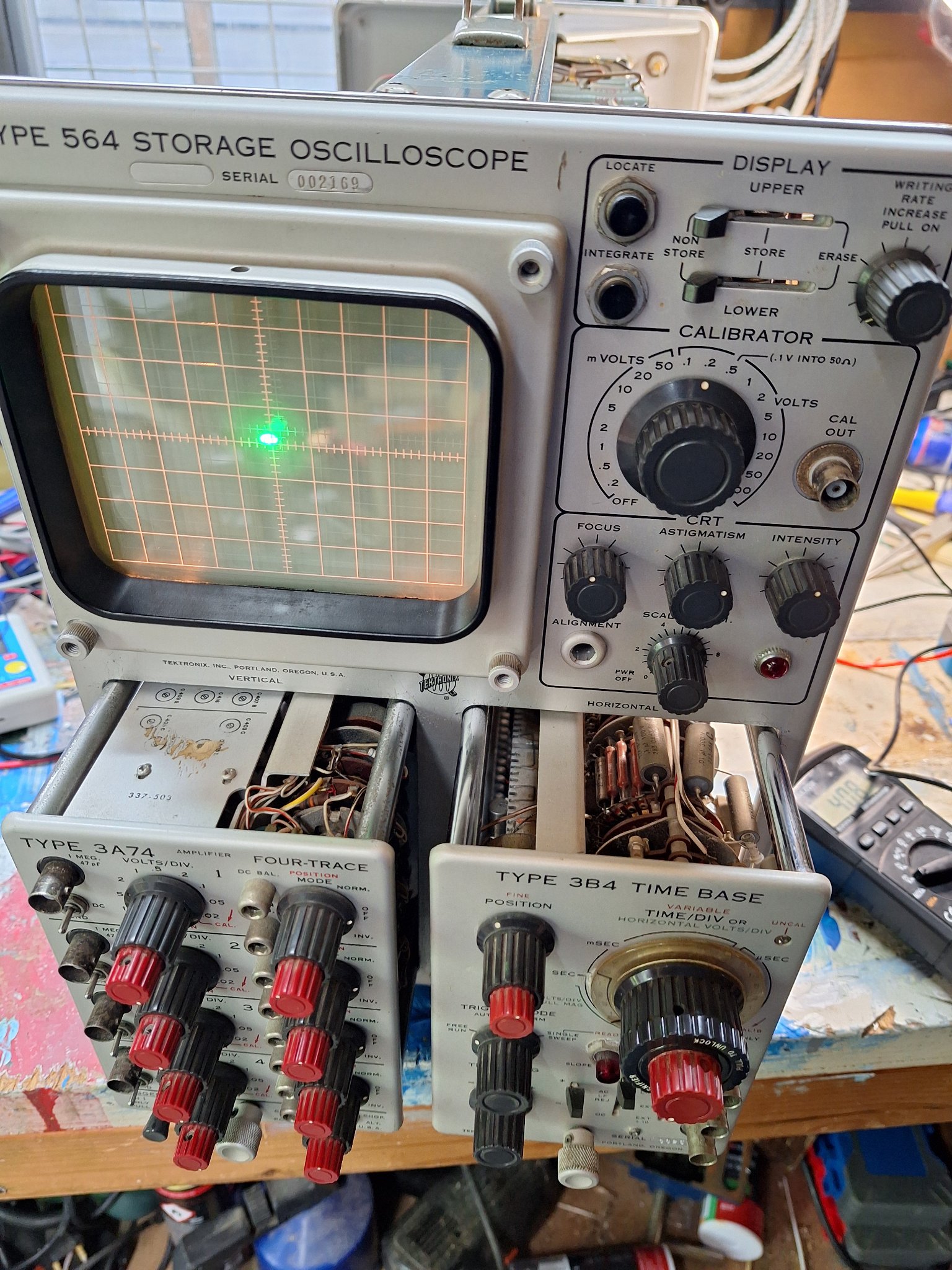

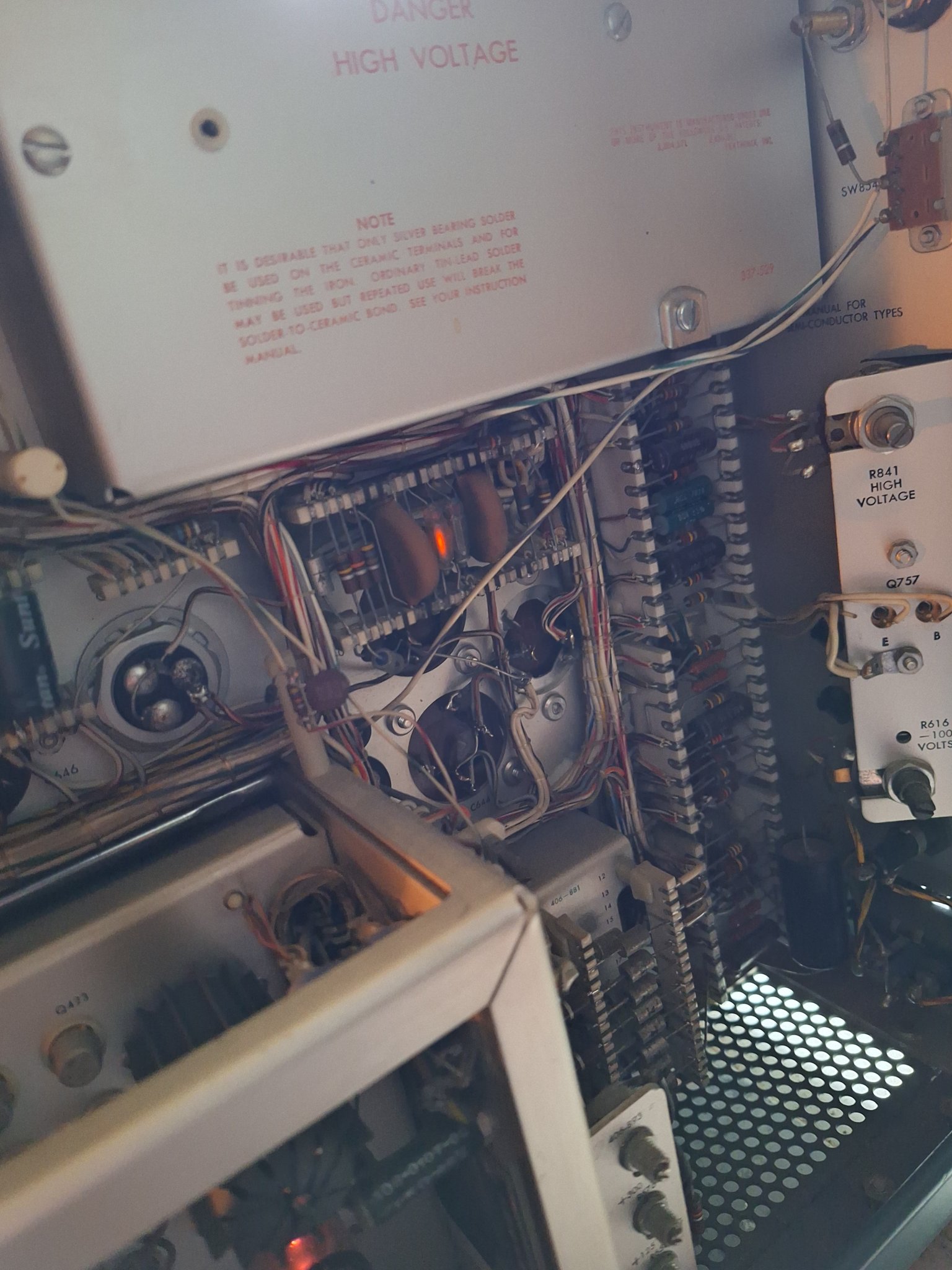

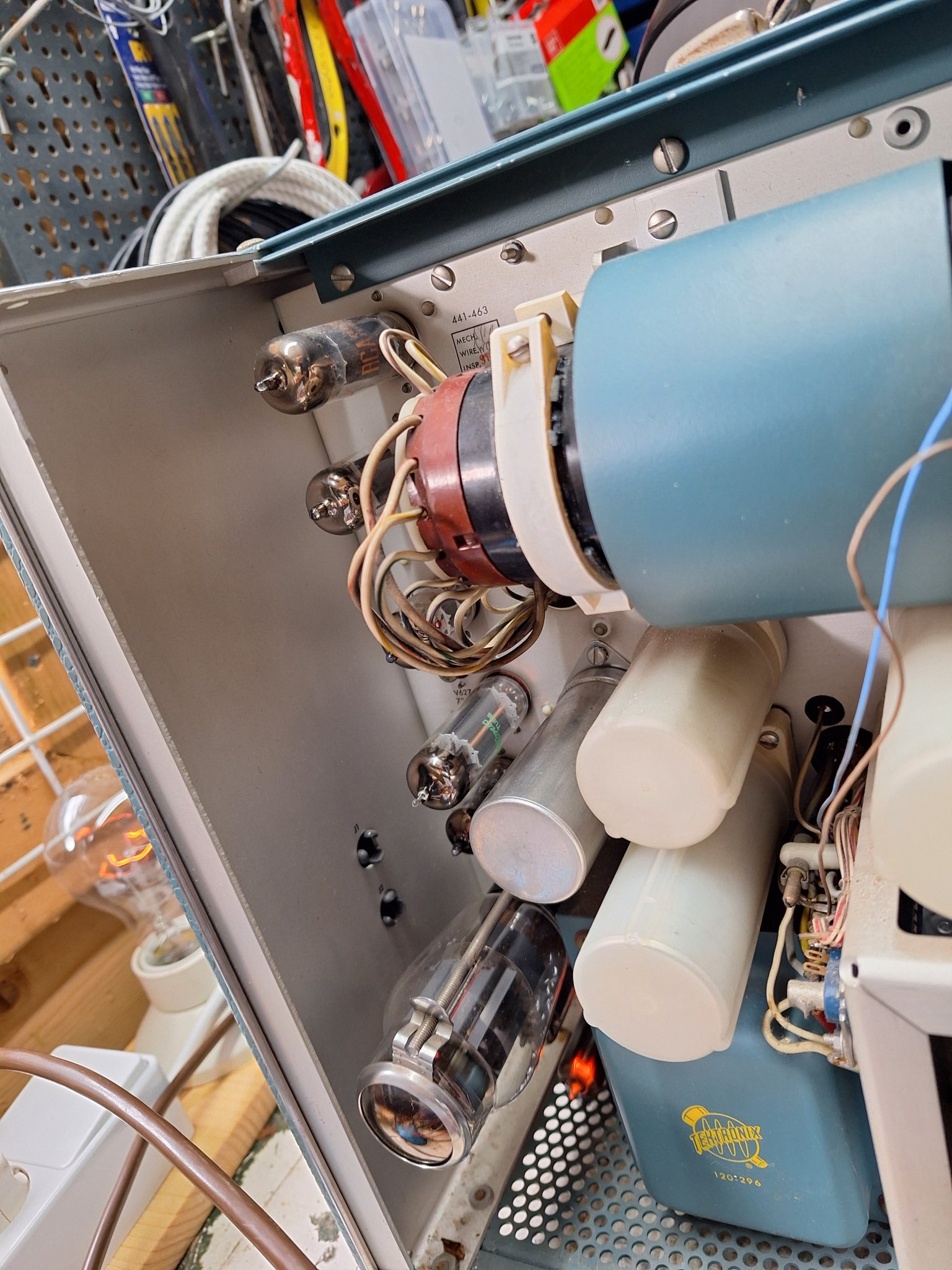

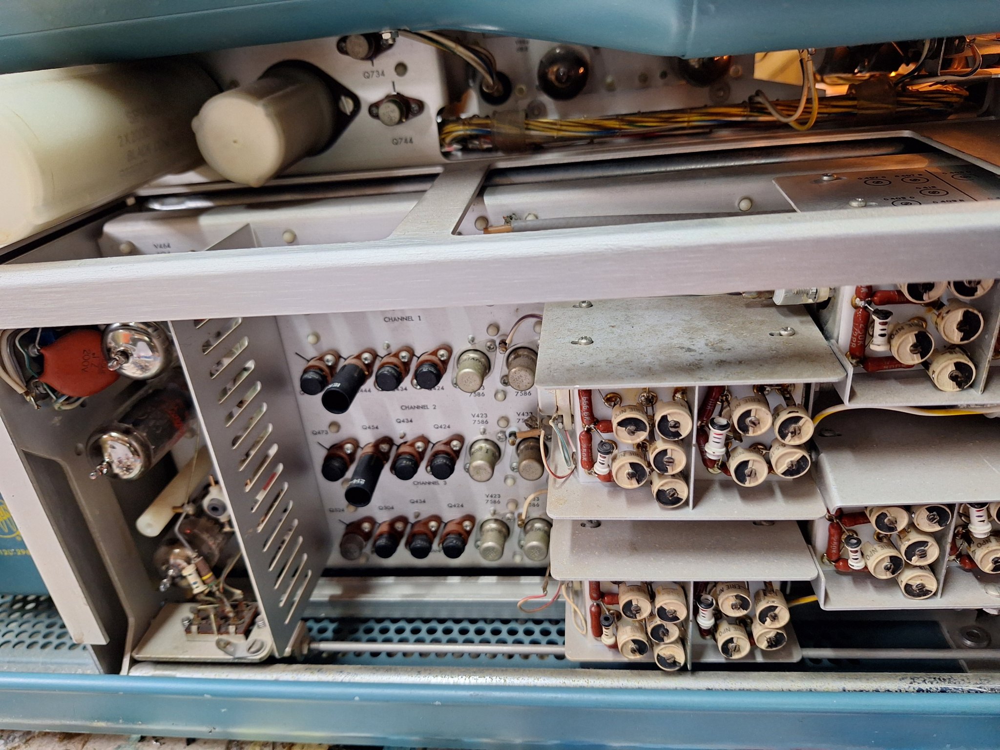

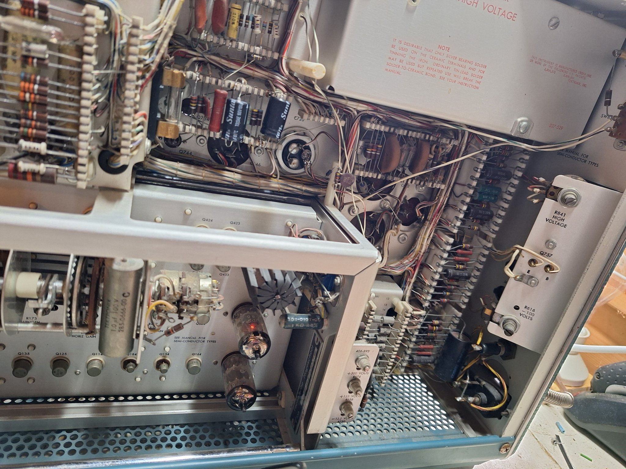

Like I promised here are some pictures
These are with both plugins and the following images are with just one plugin, and the neon bulbs that ignite between the G1 and the cathode of the CRT:

Wow! Are those nuvistors in photograph 2 or early transistors? (I suspect early transistors.) That glowing protection neon in photograph 3 must be a clue, it's hard to tell for certain, but it looks as though it might be in the power supply department. Tek oscilloscopes tended to have one main regulator that was used as a reference for others, so that's the place to start looking. Good luck.
Those are actual nuvistors funnely enough the 7586. Might out of spec resistors in the psu cause a voltage sag aswell? Or is it more often bad tubes and capacitors? I'll check everything tomorrow.
Instead of speculating have a look at the supply voltages.

In the last picture I see two HongKong capacitors, so have a close look at previous repair attempts.

Ok so basically after the regulators the voltage rails drop a lot. 300V+ is now 220V+ and the adjust doesnt change it that much. But what I did discover is that the unreg 420V with both plugins is about 270V and with one plugin is 330V. With no plugins its about 410-420V it flucuates. Also with no plugins a trace appears on screen:
I might add that the 420V is after the filter capacitor which is about 170uF instead of the schematics 350uF. (It has problably been replaced in the past but its ESR and Vloss are fine).

That was my work, those capacitors looked real bad and measured weird so I replaced them with capacitors I got from a reputable source, these are electrolytics.In the last picture I see two HongKong capacitors, so have a close look at previous repair attempts.
